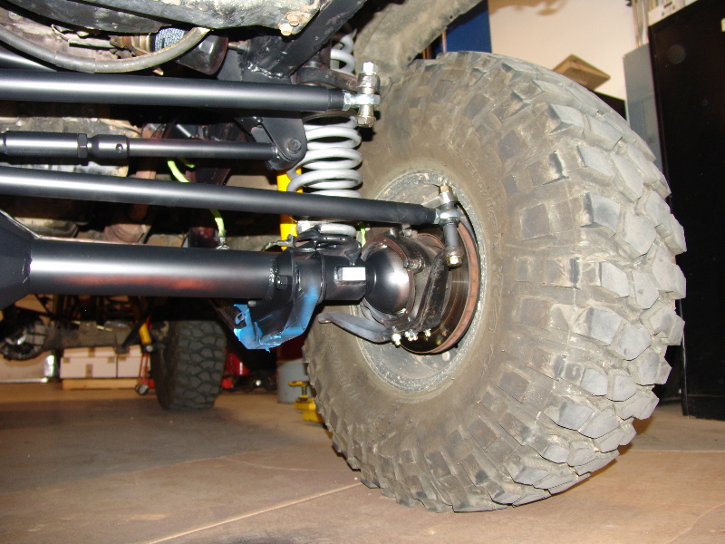

The kit is $595 for the arms, complete with new studs,cone washers, washers and nuts. The pic below is the old style that we did not use cone washers on all three holes. I will have updated pics as soon as the studs come in from Toyota. The hole sizes for the rod end side is 5/8". The pictures show the setup we did on the 100 SAS swap. The arms are used in a double shear setup with the stock bottom arms. It requires the bottom arms to be drilled out to 5/8".
For this to work you also need a RHD double ended steering arm. We have new units of those for $185.

Kit will not work for a leaf sprung setup. The arms are not high enough to clear the springs. As for DD vehicle, you have to move the panhard as well, and you could have interference with the panhard and dag link. The idea behind the kit is for people doing swaps for 80 axles, or people that do three links on 80's
