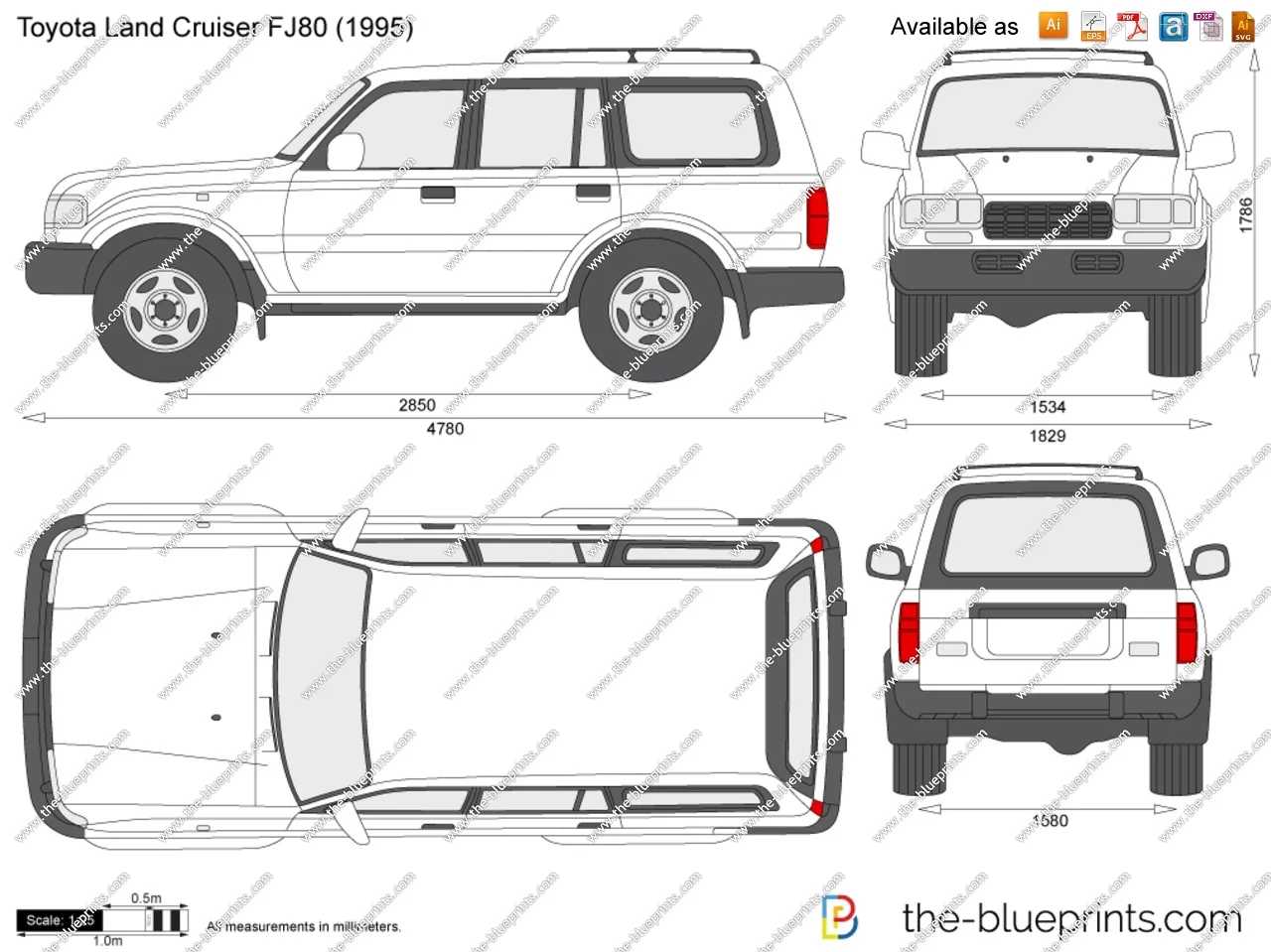

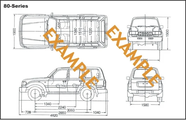

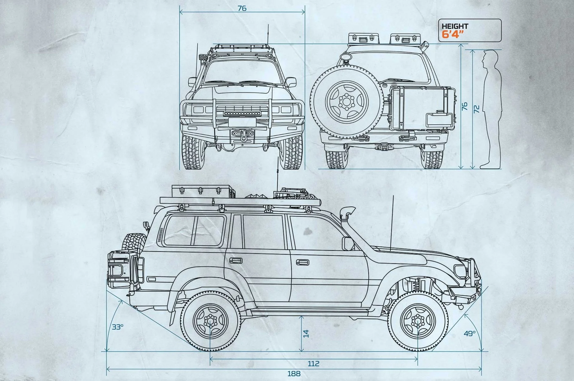

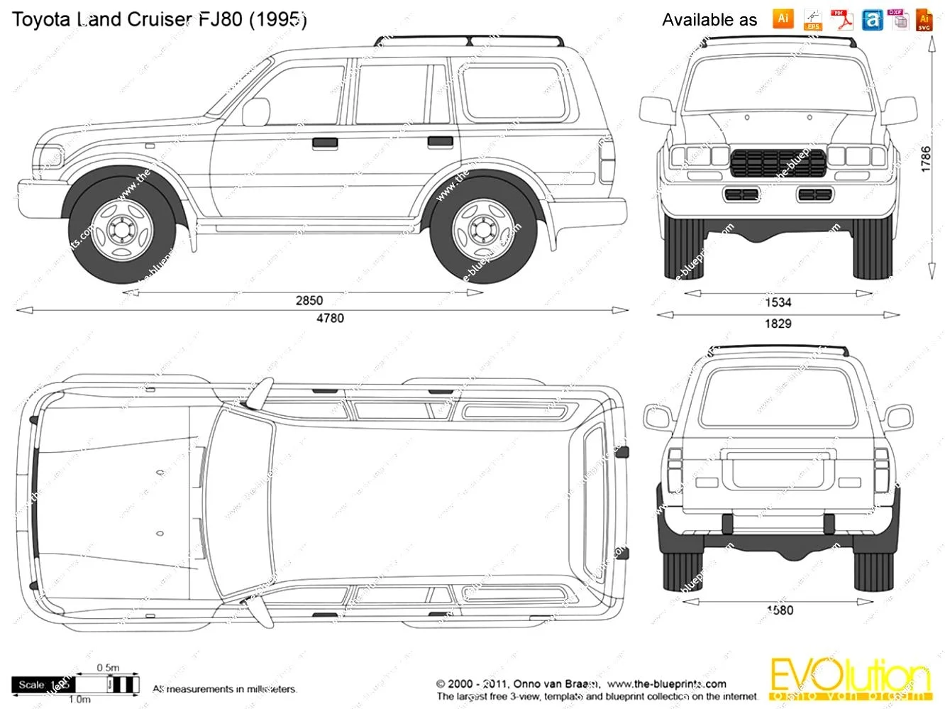

I find myself planning a garage shuffle and wondering about measurements. Came up with these, from web and Mud. Any more out there? (Added better versions of some below, now I can't seem to delete the old ones--anyone know how to do that?)
Another 33" or so width for an open door (from body, not flare).

Tires, lift and rooftop gear (rack or tent) will have a significant impact on height. I know mine is 7' tall with 4-5" of lift and 37" tires with nothing on the roof and the only way to get it in the 7' garage door is to swap tires or deflate to 0lbs, put some weight in the rear and then sneak in.
