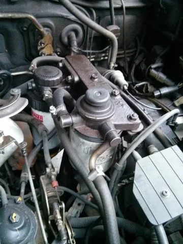

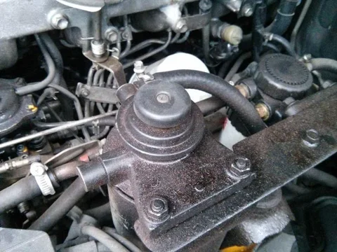

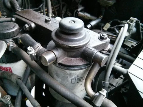

Ok so here's what I have. Let me know what you think.
You have what every other non-winter truck has :P
If you want heated fuel and your truck had it in the past get both items above which is a good price btw... IIRC I paid 200 Locally for the one in your truck as it would not prime anymore.
Don't know if it had it in the past but the PO told me it did. Given that the pre-heater cpu is there I would have thought so also. Ok, so the one I have now would be replaced by your two pieces I guess. So do you have any ideas if there is a way to test the CPU/wiring? Maybe using a multi-meter or something. I wouldn't want to oder this and then have to drop more money on more parts to make it work.
Also, will this only work with OEM filters or aftermarket as well?
Send me email and i will send you FSM with info how to test it. It is only for OEM filters or equivalent of it.

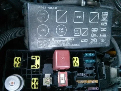

There is no ECU to control Fuel heater. It is just controlled by Relay 90987-02004 which is found on many North American Toyotas as EFI relay and you can get it from wreckers or new.
OK so no relay will have to get one. Will check my local dealer if not I'll order from eBay etc.
Any idea what the empty HEAD one is?
Sent from my Nexus 4 using IH8MUD
Sorry yes. Not empty but still curious what it is
Judging by the Head(LH) and Head(RD) fuses to the right I would say possibly a relay?
Big red square is head lights relay.
