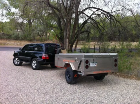

I weighed all the stuff from my truck on a scale tonight and adding to the previous post and assuming a full load of children, wife and dog I'm at 7500lbs.
Thought there was value in determining the full weight of the vehicle and trailer in expo mode.

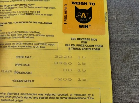

This is just the truck, right on with my mental calculations. 2 adults, 2 kids, dog, stuff.

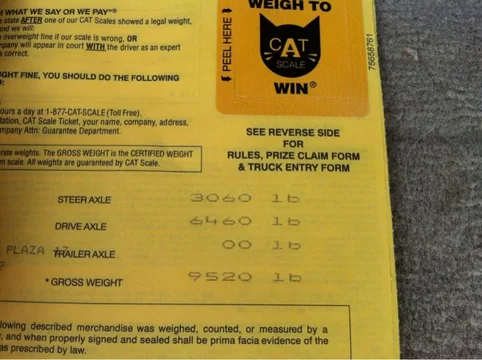

This is the truck and trailer. Note it's not possible to have the trailer on the third pad. The trailer was fully loaded with gear, 20 gallons of water and a full 20lb propane tank.
