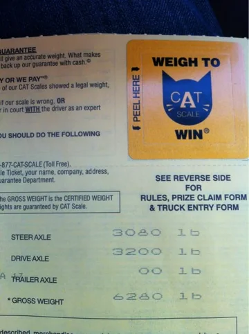

Thanks for that. I didn't even know the one at our truck stop existed. $9.50 for the first weigh. $1 after that. Headed over tomorrow with the truck mostly empty except for the stuff thats always in it. I'll have to add a few pounds to make up for the missing rear glass.
I know he local port I entry frowns on people going through theirs but it was starting to get really tempting.
Just left the cat scale. This is my truck mostly empty with the following.
Myself at 200lbs
~100 pounds of tools etc.
Outback Solutions Drawers
LoadSpotter Slide
Slee Blueberry
Slee Front Skid
Slee Sliders
Slee Rear Bumper (sans tire and carrier)
60% of the back seat.
I look forward to weighing it again next time I am headed out of town with a full load. Most likely to CM.
