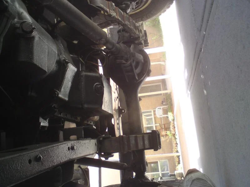

atm i only have a recond 2H, bell housing, transfer, tailshafts, front and rear diffs with disc setup inc calipers, clutch is missing, as is disc brake master cylinder. i dont know if it has the steering components, p/s (im picking it up next weekend).

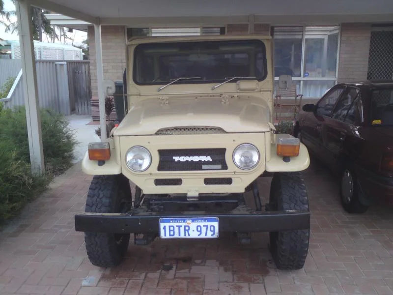

other than that, ill post photos of the car before , during and after, and of the gear.

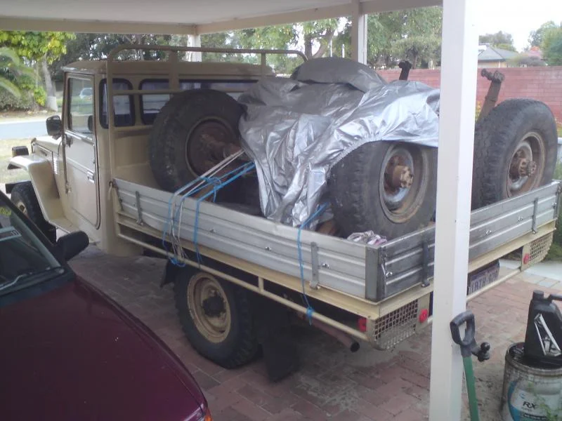

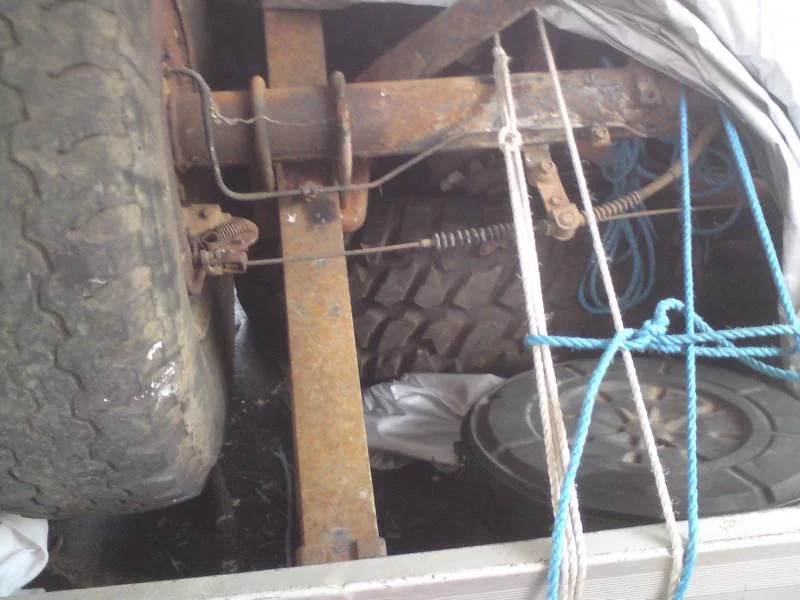

that was my dodgiest drive ever ( 750 km round trip ) !! 4 hours there and 4 1/2 hours back,

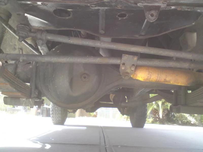

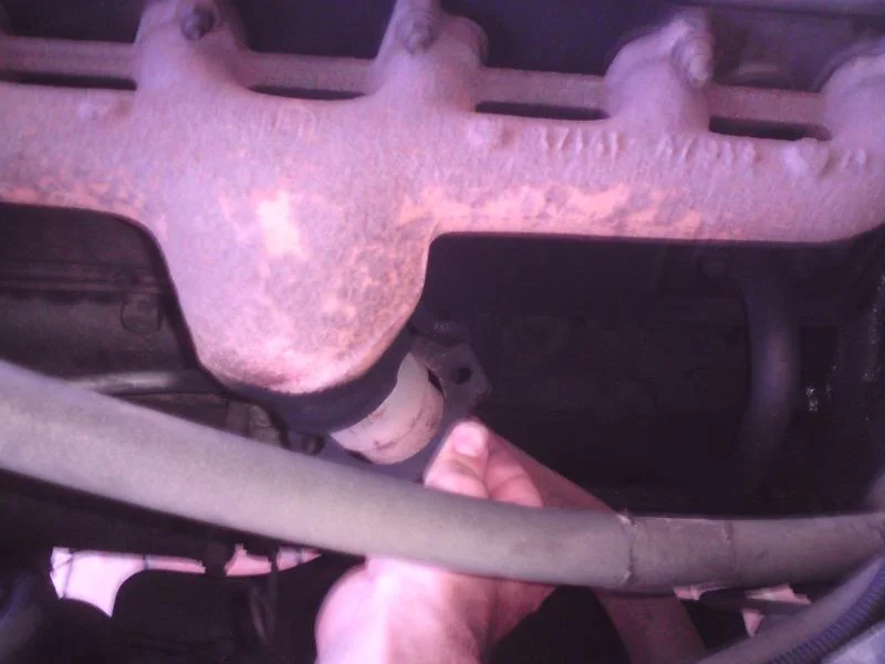

60 kms up hill, my tow bar 10cm from the ground, the tyres rub on the tray when you take a curve more than 15 degrees, and 160 kms from home, the exhaust snapped off at the manifold, hahaha talk about getting noticed by other ppl.

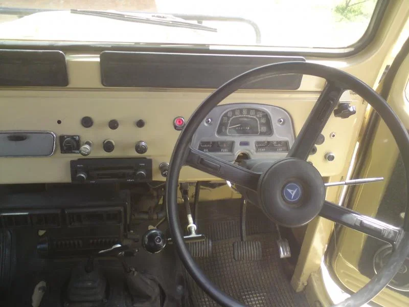

im also going to get a flat sheet of metal, made to suit the raised dash area, as the holes on the dash arent lined up square and it annoys me. also thinking about putting in bucket seats. any ideas on how to keep the 3 seater though? can i just make a seat for the middle? also, is there somewhere you can get dashes made to suit, as i want a new dash, with tacho and speedo,
some pics
attachment.php
attachment.php
attachment.php
attachment.php
attachment.php
attachment.php

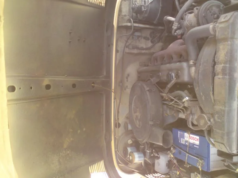

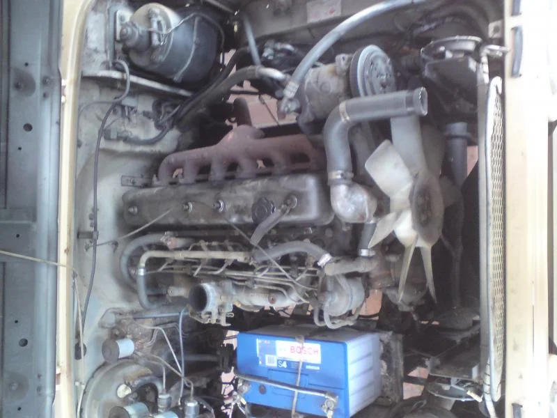

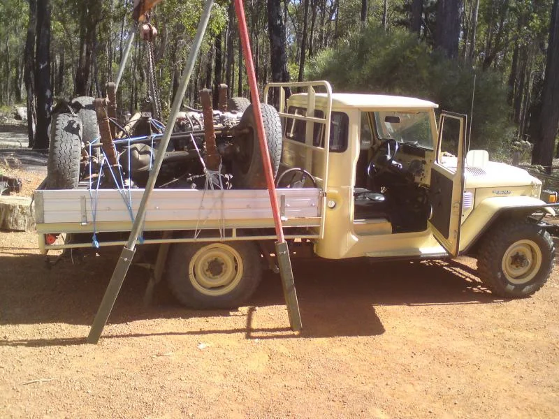

well i got the new radiator in and attached to the H motor, running, and got it to my mates place, and last night started taking all the wires and hoses off the motor etc, took out the radiator and the front grill down to make life easy. ive got pics but ill load them all in one go. the motor comes out tonight and hopefully the recond in and running - enough to get it home anyway.
