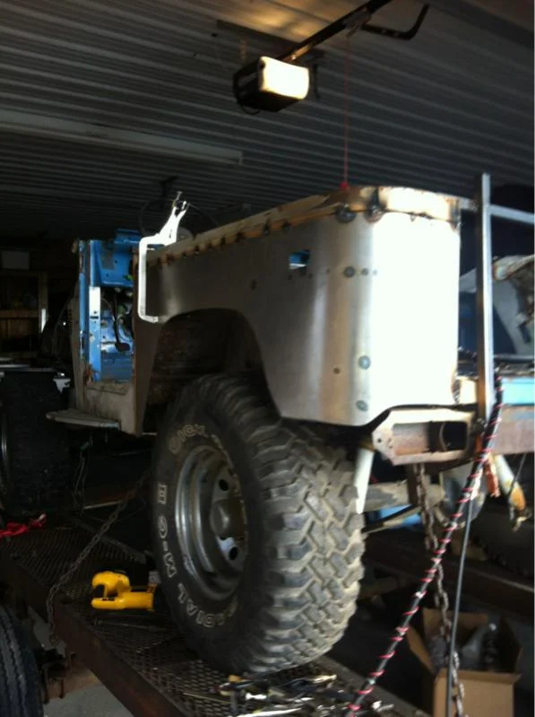

I am restoring a 76 FJ40. I bought it 7 years ago and rolled it trailer and cruiser in Gallop. Sat in driveway for 7 years. Had the frame and body straightened in Sikeston Missouri. Started to weld qtr panel this February and am trying to get it bead blasted this month. Then painted will post pictures as I go.

Your pic doesn't show the front of the door jamb. If the the front of the door jamb and the bottom of the door to the the sill are even then the quarter panel is the problem. If it is an aftermarket quarter panel don't expect it to fit perfect. A vast majority of aftermarket parts need some kind of tweeking to make them work.
The door at the top of the post is off the same as the qrt panel is so its the post. Trying to figure how to Move that post the 1/4 inch thought about using a high lift jack across the door and push from the front of the door jam to the door post the door post should move first with the qtr panel removed. If the post will move. Thought about using a come along to the rear but there is nothing to attach to except the bumper and the angle from the bumper to the top of the post isn't the right angle to be pulling against and it may damage the bed. Any ideas?

I just completed welding a new bull horn on and got my qtr panel tacked. The new bull horn did not have a hole for bolting it to the frame so now I have to cut a hole for the bolt with a tour h cannt get a drill in the space allowed. Oh well one step forward two back. S

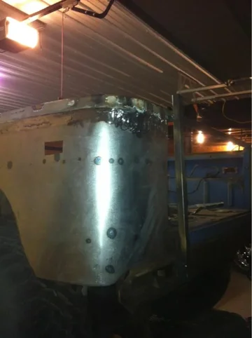

Well today I got the qtr panel welded. The bull horn looks like it was 1/4 inch to long which caused more gap between the qtr panel and the body. Wish i would have caught it earlier too late now. Ill just have to live with it. I changed to .023 wire and it made all the difference in the world. Didnt realize it until after I bought new drive rolls but my existing drive roll had a .023 groove by just rotating the drive roll. Oh well now I have two. I am using a Hobart 135 handler. 1/4 inch gaps are hard to fill but after grinding down the welds I only missed a spot 1/4 inch long. I was pleasantly surprised. I need to get a coarser paper for my DA done all I can do with a right angle grinder. I have degenerative arthritis and grinding down the welds had left my weist in a lot of pain. Nothing i can do about it but put up with
It im going to start on the bed patch next. I got the patch from classic cruisers and am happy with what I got. I ordered butt weld clamps from Harbor Freight for 15 bucks set of eight should get here about the time I need them. Dont know how I can set the Bed pan with the clamps without some help. Maybe i can figure it out. Welding with little or no gap is a lot easier. I found that making about 4 Places
with the mig on the new qtr panel made it easier to fill the gap. The existing metal is thinner and wants to burn thru. The pictures capture where I am at now. Once i get the air compressor working I can use the Da and smooth the welds out. I am going to try 40 grit paper, 80 grit aluminum oxide doesn't cut the welds.
