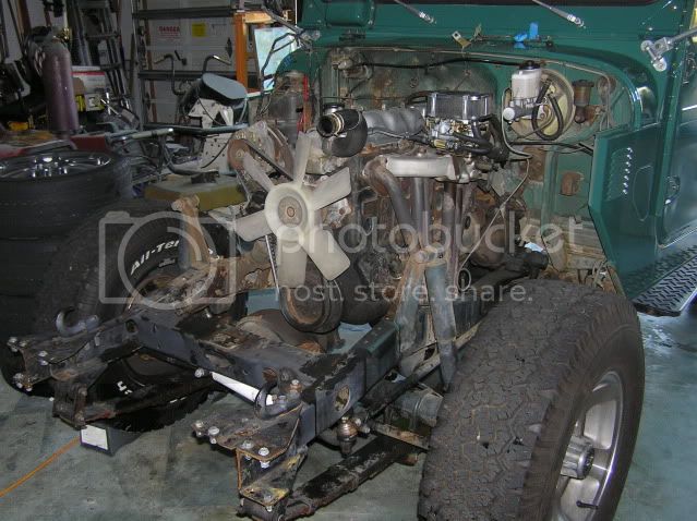

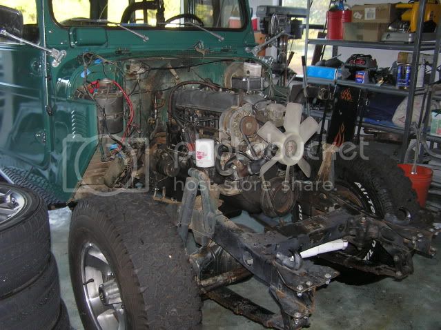

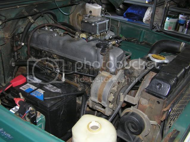

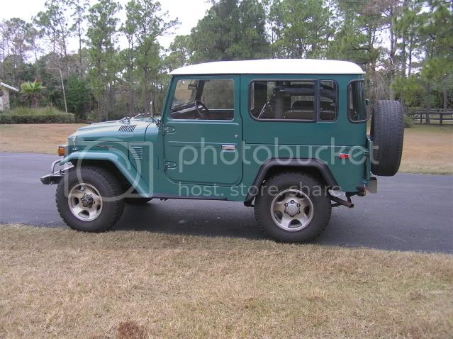

Here's how it sits today; rust free from Arizona, it's got a rock solid 2F, Weber carb. and headers, stock transmission and transfer case.

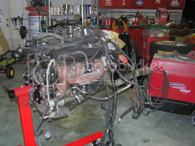

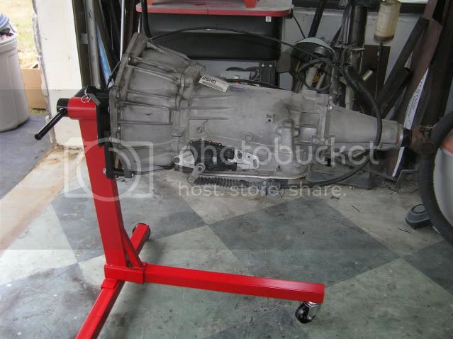

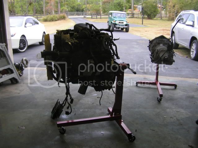

The donor vehicle was a super low mile 2wd 2002 Silverado pickup. I got the Vortec, 4L60E, ECM, and complete harness.
I read everything I could on here about these swaps on here and chose this combination based on reliability, performance, and ease of install. I'm sure I'll have lots of questions along the way.
I'll begin the tear down tomorrow.

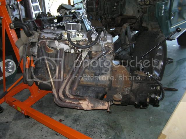

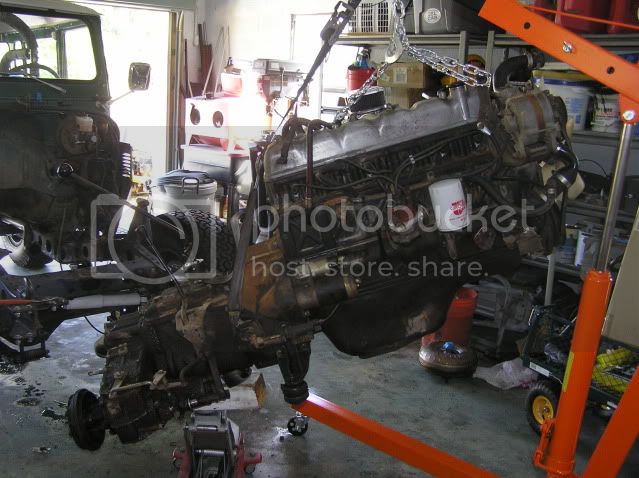

Got the 2F and old old drive train ready to come out today...

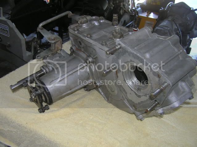

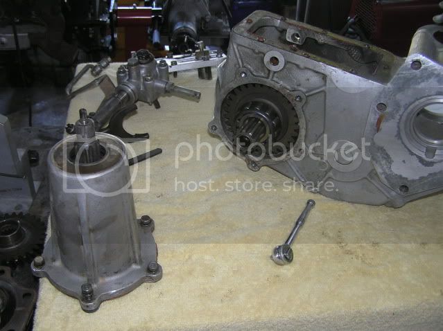

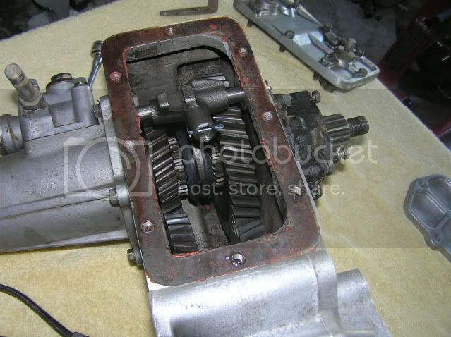

I rebuilt my transfer case today, got the rebuild kit from CCOT, nice quality stuff, followed the FSM and everything went well. Here's the question, the previous owner (or someone) put gasket goop all over everything, both sides of all the paper gaskets. Do I need to use any gasket sealant at all on this transfer case? The gaskets seem to be good quality. Thanks.

I should have used the search function on my last question, picked up the sealant today at the Toyota dealership P/N 00295-01281.
Here are a couple of random shots of the T/C rebuild from last night...

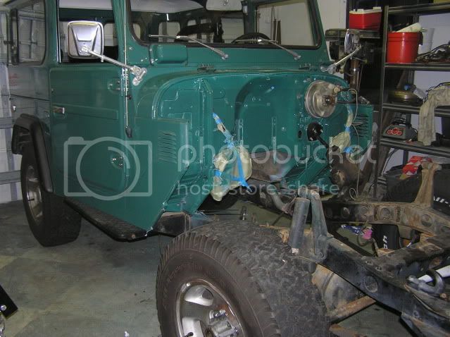

And since I am waiting on parts (adapter, motor mounts, etc.) for the swap I got the firewall, inner fenders, bib, and underside of the hood all painted .
I'll get the T/C all sealed up tonight.

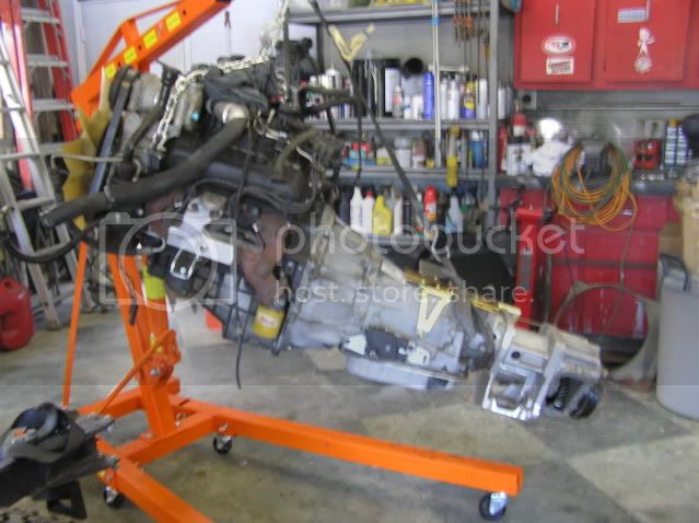

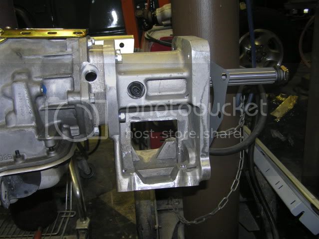

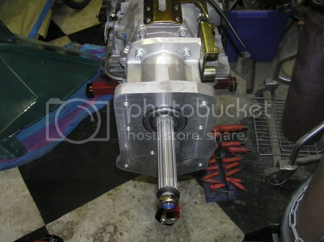

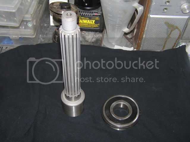

Got almost all of the parts in this week so it is time to get started, I got most of my swap components (adapters, shifter, radiator, motor mounts, etc.) from fellow Mud member Jim Downey. It was a pleasure dealing with Jim on this stuff and it was an extra benefit to pick his brain and get some of his tips.
I got the Advance Adapters 50-0470 kit for the 4L60E, it comes with two adapters, one to convert the 6 bolt hex (4L60E) tail piece to 4 bolt square (700R) and then the adapter to the 16 spline transfer case. It includes the new spud shaft, bearing, Vehicle Speed Sensor (VSS), and adapter plate for the 4WD selector.

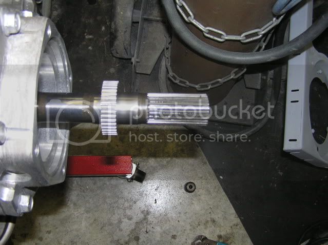

First, so that the new 16 spline spud shaft can be fitted I removed the stock 4L60E tailpiece and measured from the back of the new hex-to-square adapter and cut the stock output shaft to 5.5", then filed the splines.
Then installed the T/C adapter to fit the VSS, with this kit it is centered over the stock reluctor ring and must be set to an air gap of .010" to .012".
This is the new VSS,
Then pressed the new bearing onto the spud shaft.
And then pressed the new spud shaft into the T/C adapter.

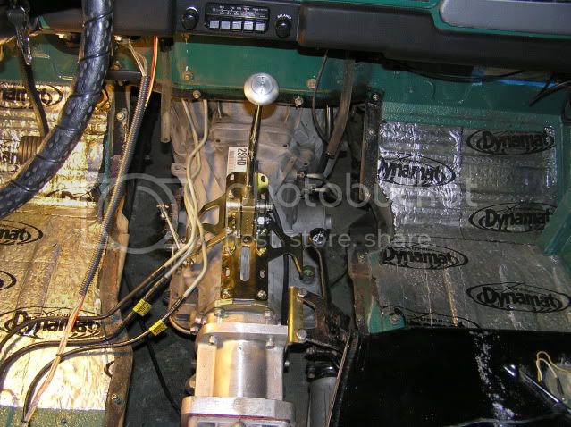

On the right above is the 4WD shifter adapter bracket and part of the new Lokar shifter.
Here it is ready for the T/C to be installed. I hope to get it all into the rig tomorrow and work through getting the motor mounts and trans mounts welded in.

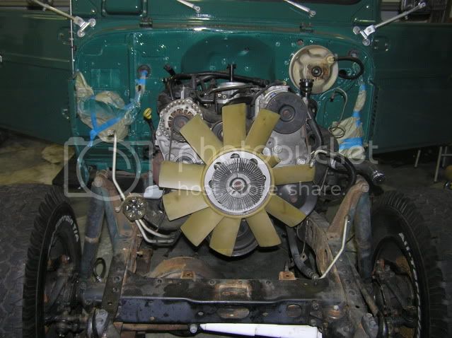

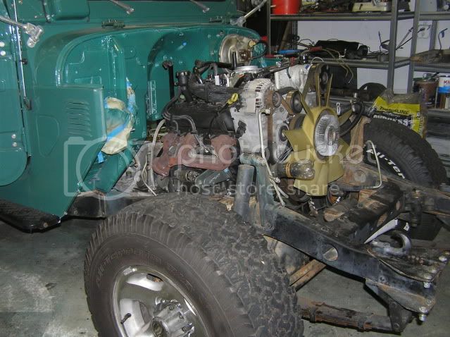

Here is the whole thing ready to go in, I got it in yesterday but the camera batteries died, I'll post up the shots of it sitting in place tonight.
The engine fit nicely, I set it 1" to the driver's side and 13" back from the shock tower or 19" back from the front cross member. Had to trim the tunnel 1/4" right at the 4wd shift bracket.
This is the first time I've tried Lokar's products. This shifter is high quality, the fit and finish are the best I've seen. It also has tons of adjust ability so it ends up right where the stock shifter was.
