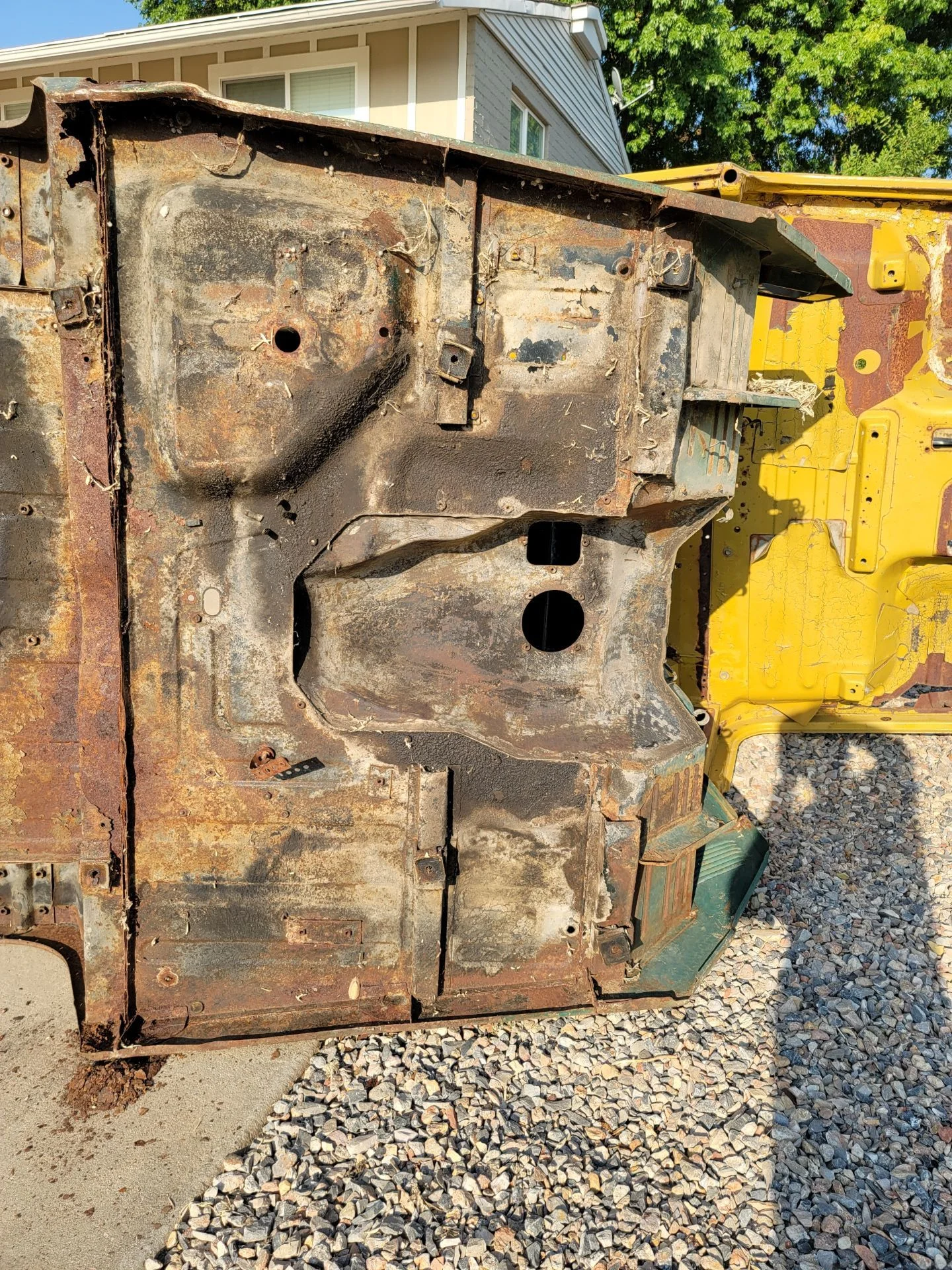

So I brought everything home last weekend and still going through tubs of parts to see what I am missing. The only things I didn't pick up were the windshield frame and the door skins. He said he has to look for them so we'll see. i picked up the whole package for 2K so I don't think I did too bad. Engine is not original, I ran the serial number off the block and its a 2F from 3/78. Squirted some tranny fluid down the plug holes and it spins free. Overall everything but the back end of the tub is in really good shape. Looks like i'll be looking for some parts for what I can't find soon. Can't wait to get started!!!!

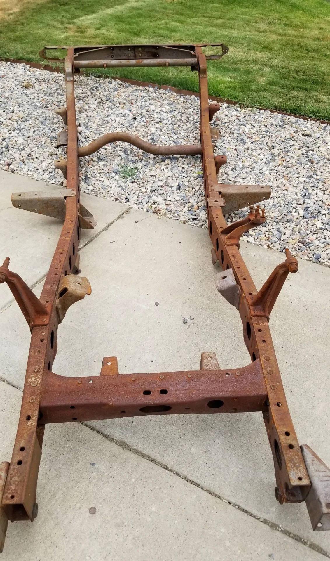

I am finishing buffing the surface rust off the frame and axles this weekend and coating everything in Chassis Saver black. Then its onto wheel bearings, knuckle bearings and new seals in everything. Once I get the frame rolling again, I've got to focus on getting the engine to a point where I can see if it runs...

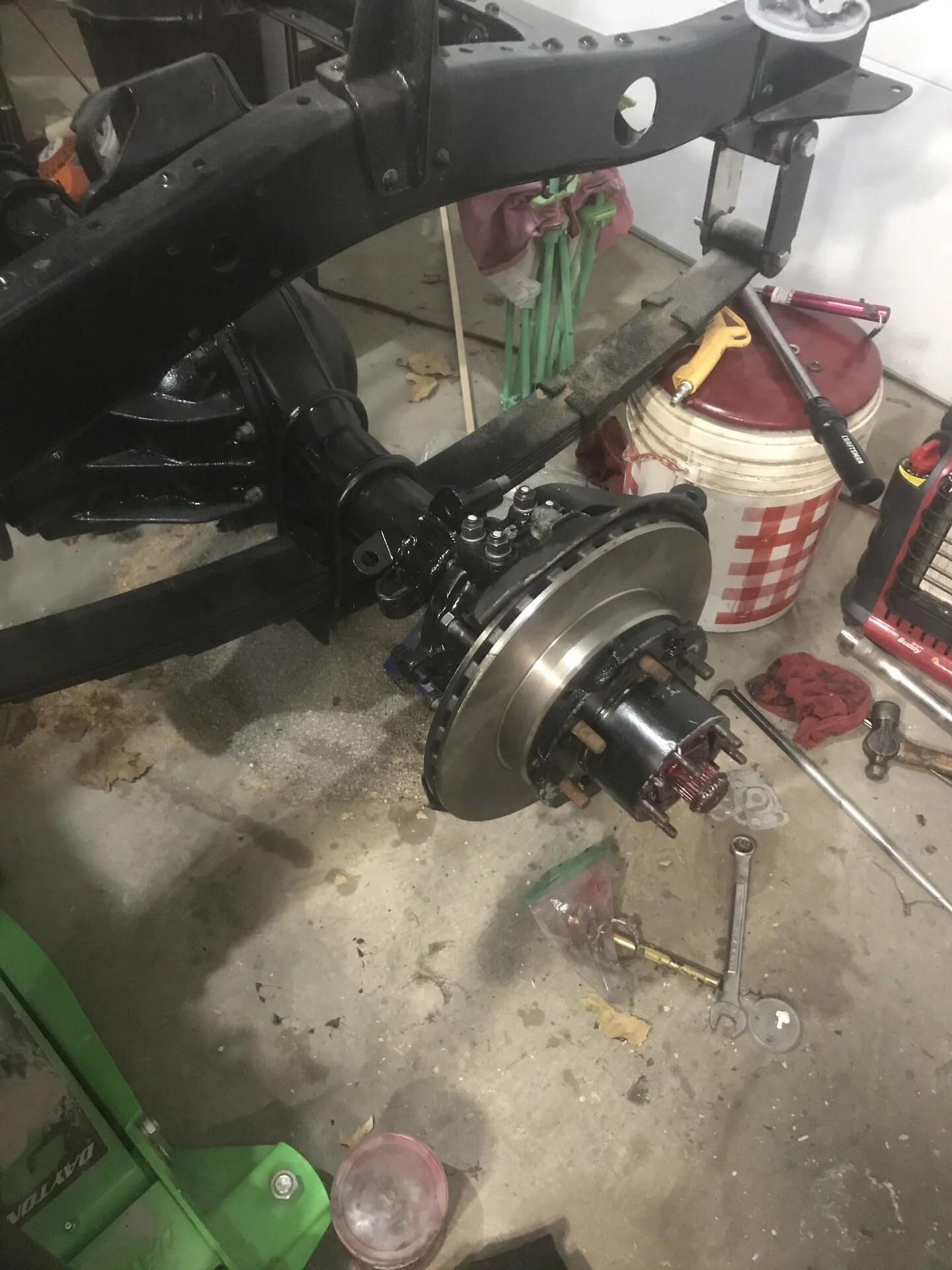

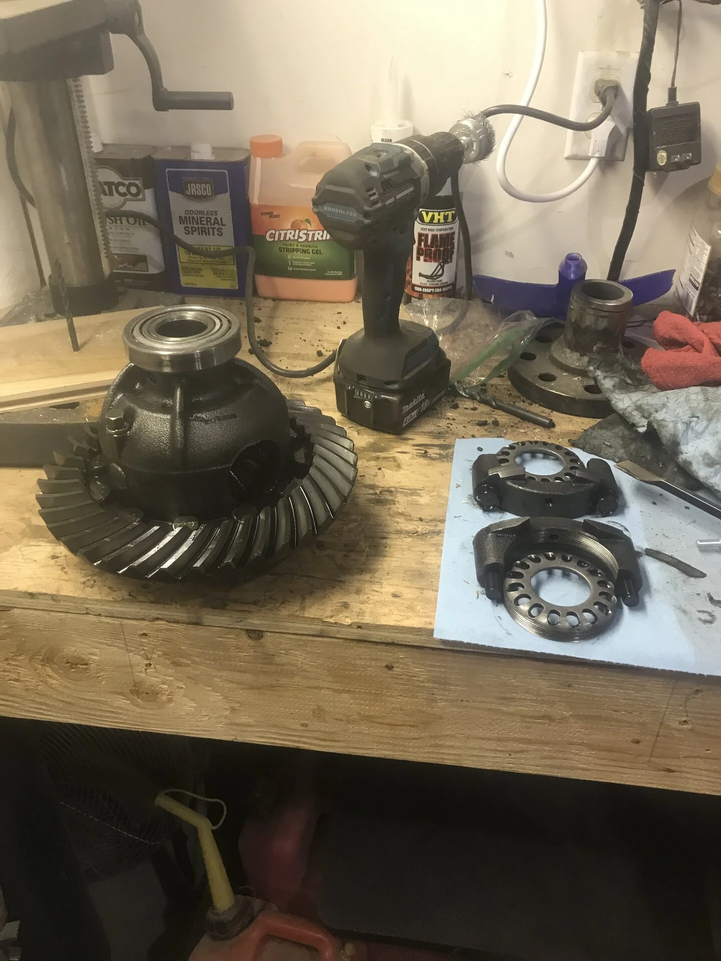

I scored a pair of FJ60 axles and swapped over the knuckles, birfs and third members into my original housings.

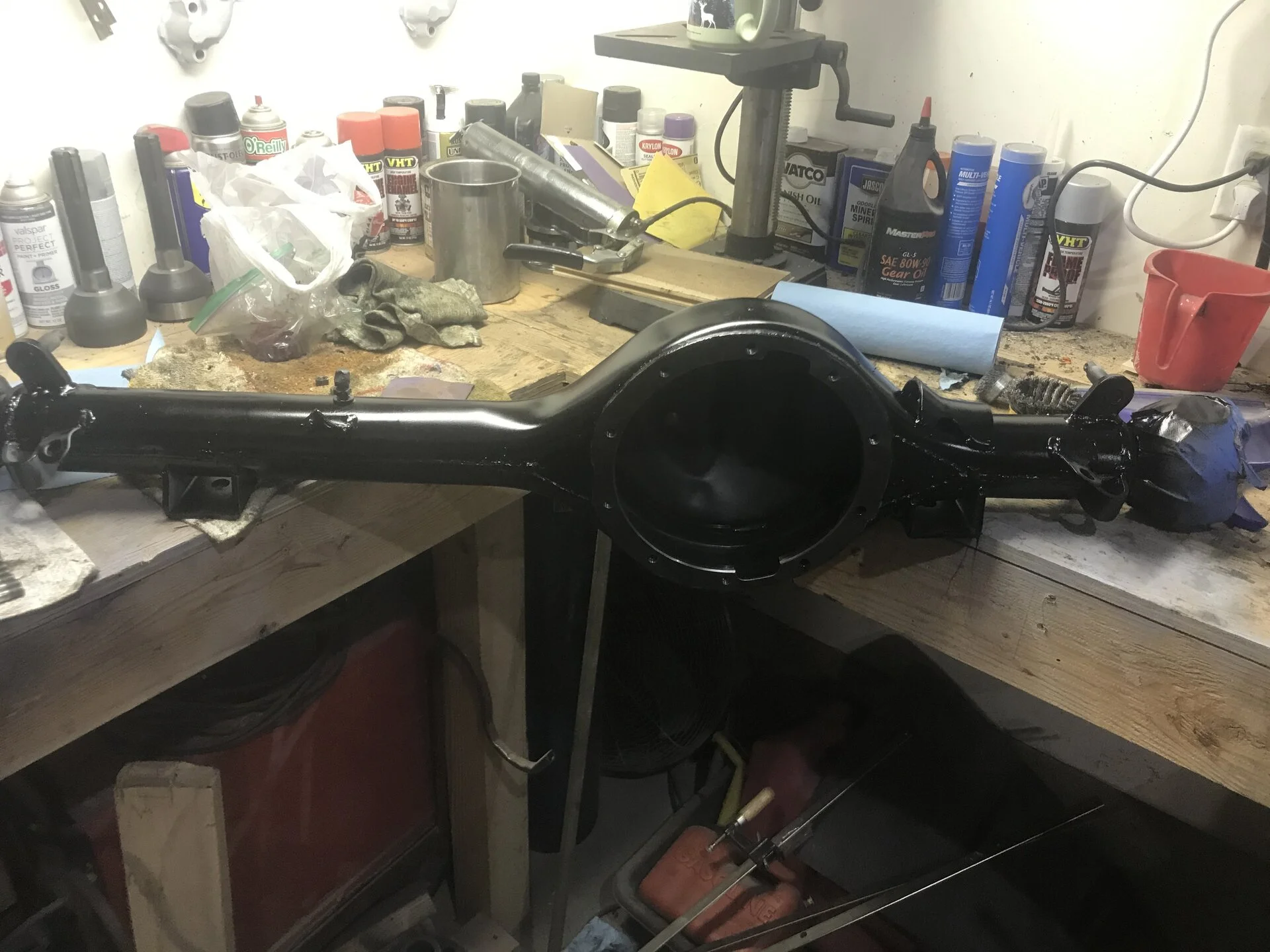

My original housing all painted up and ready to go in:

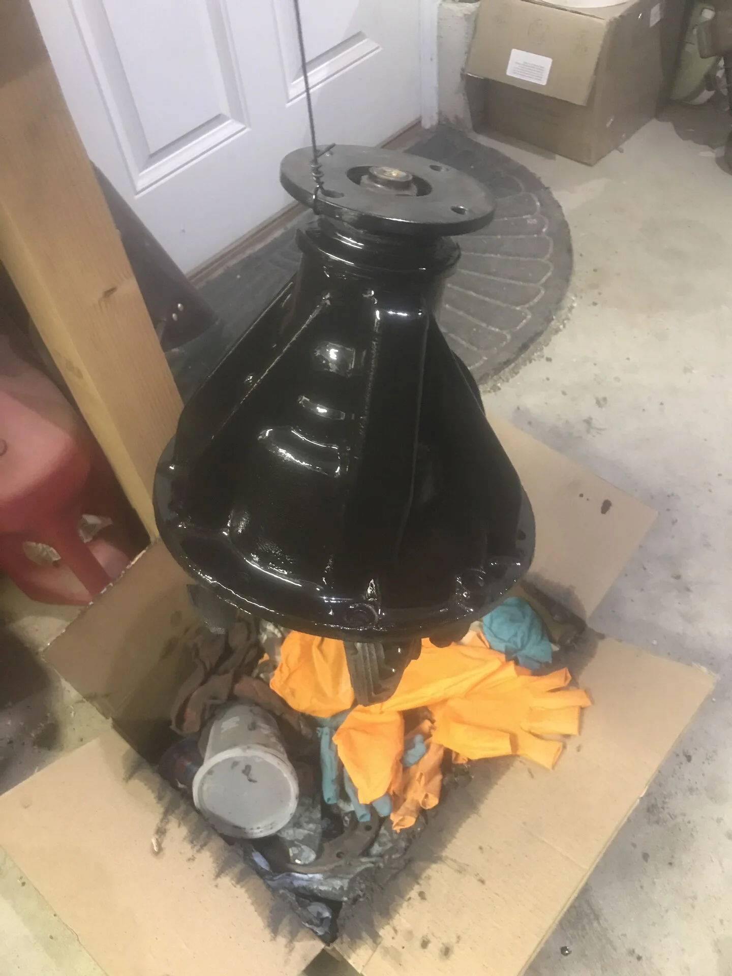

Ready for the third member:
Third member in and new knuckles installed:
Final product, minus new rubber of course:
