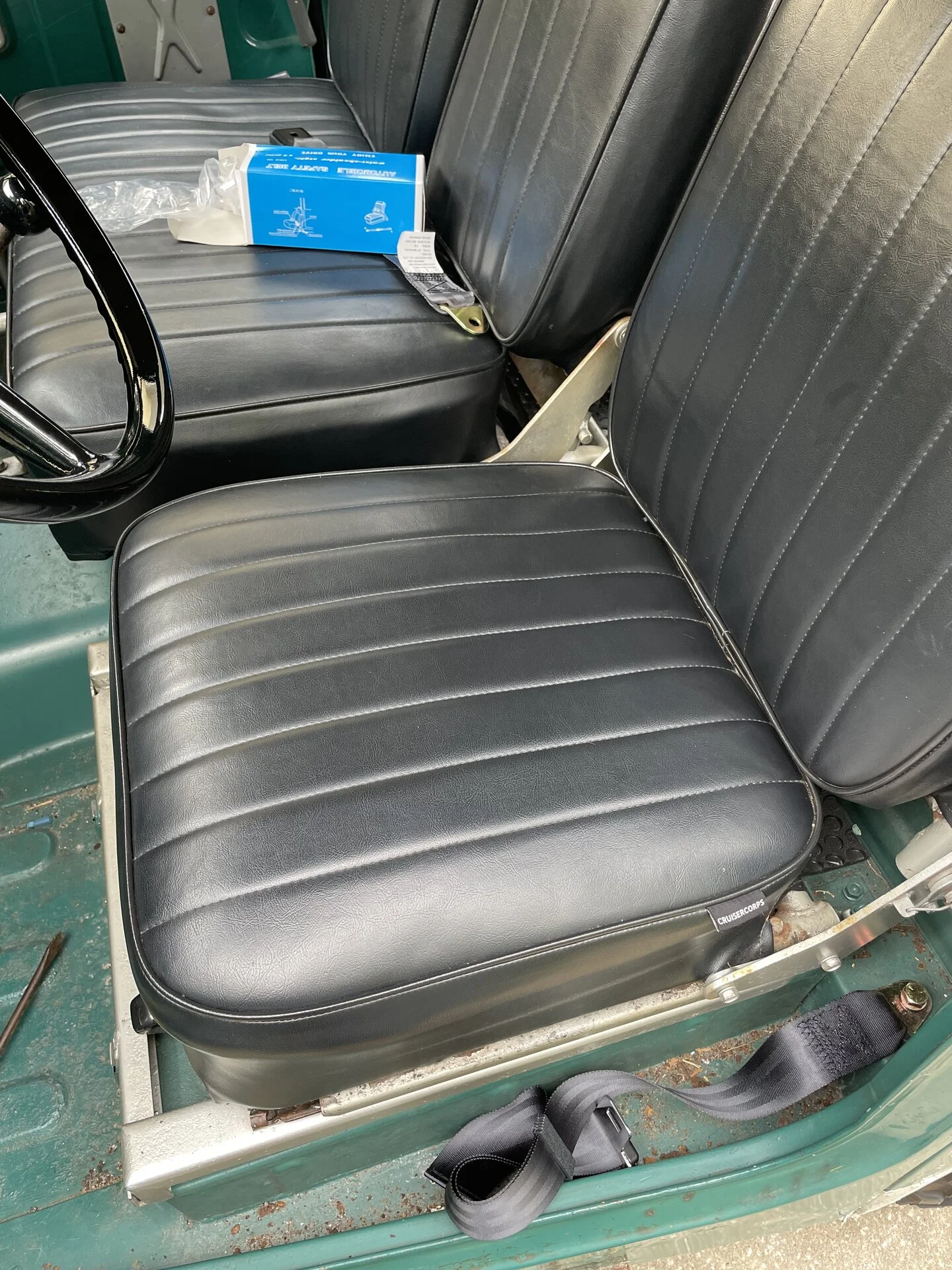

I’m trying to put in replacement front lap belts (there are none now). I found the bolt hole for the drivers side male end but don’t see where the female side bolt location is? Does anyone have a photo of how this setup is supposed to look? Same question for passenger front side. Thanks for any help.

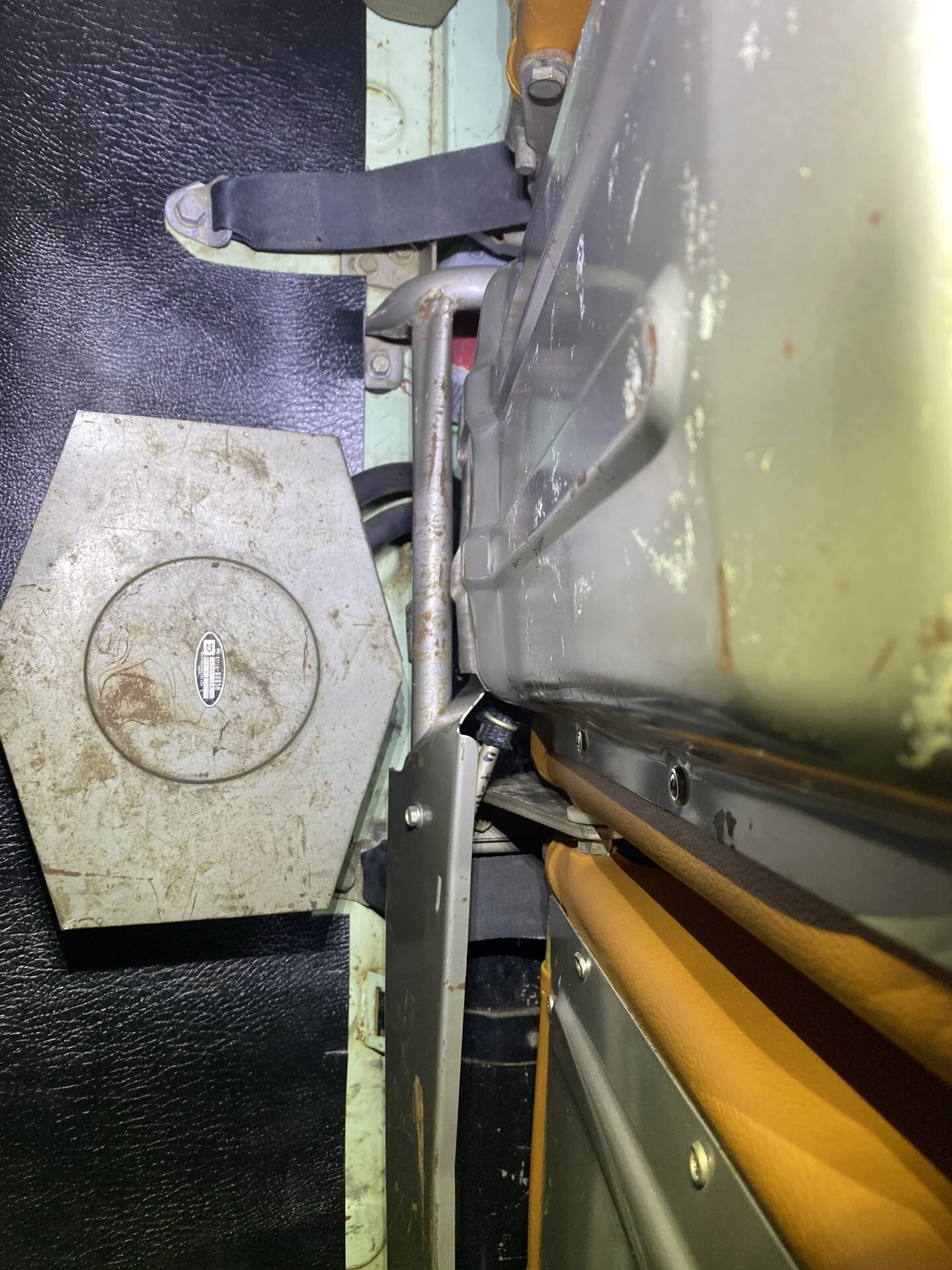

Drivers (male) is obvious in pic but passengers (female) is seen hidden/peaking our under front of heater just left of gas tank strap. Passengers (male) is just outside of seat mounting point.
Edited for more detail in regards to the picture

Thanks I found them and got the new belts in, definitely better than driving without any seatbelts, thanks for responding
