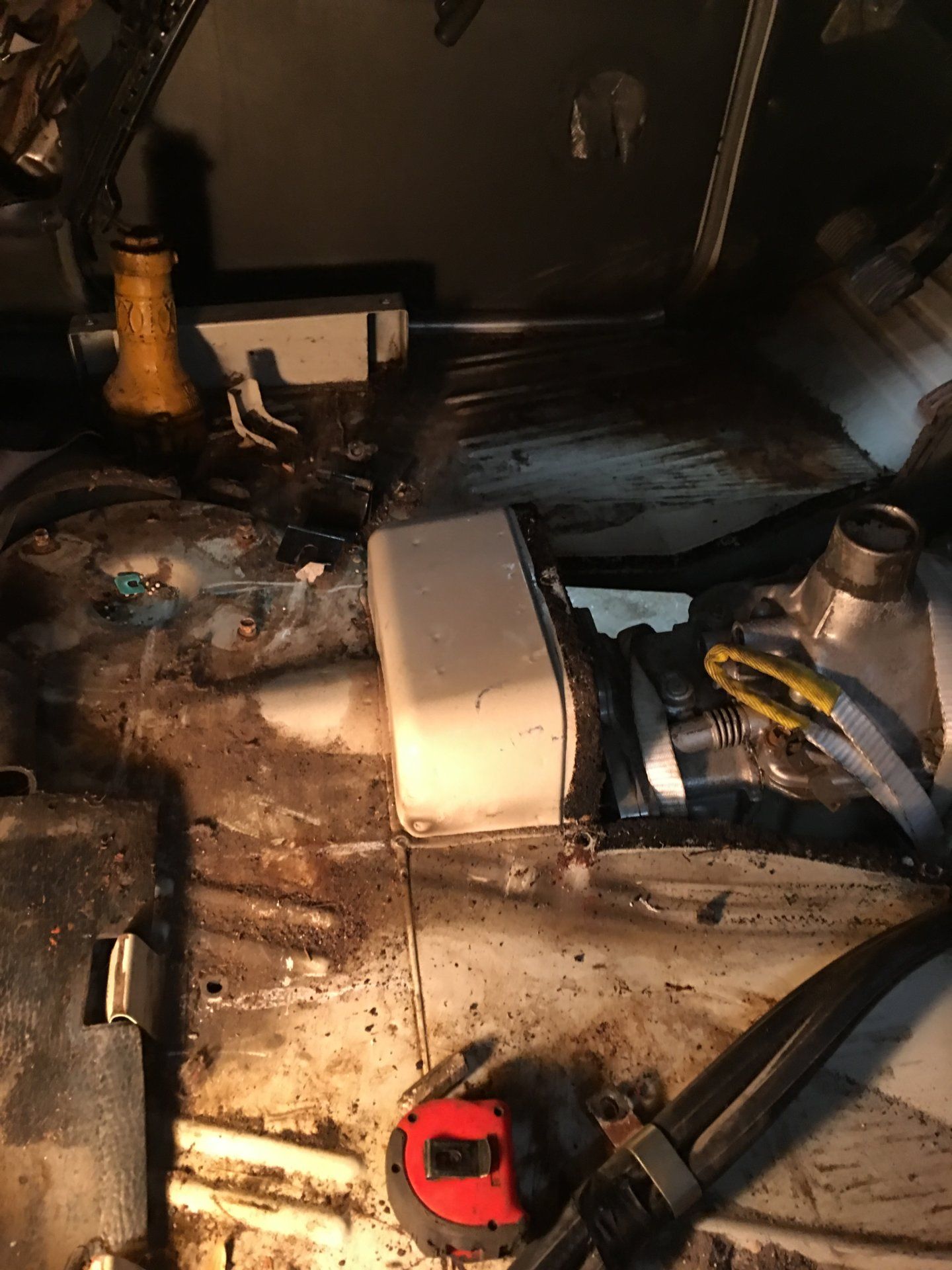

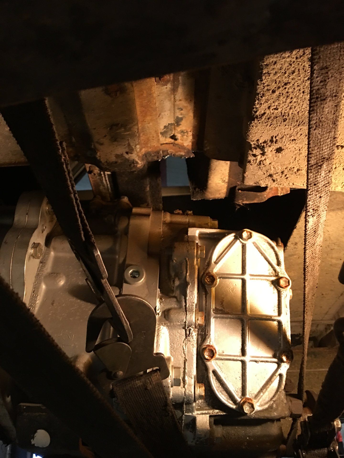

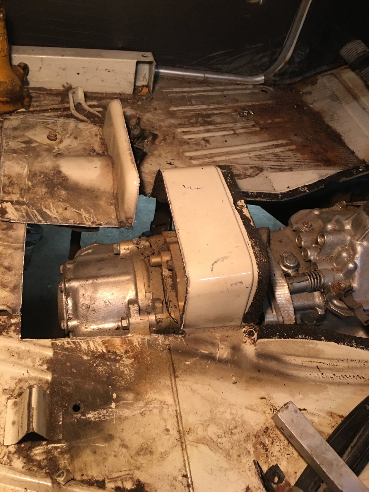

After test fitting the 1hdt,looks like it will fit ,I cut the engine mounts from the hdj81 and welded them to the 55 frame,the H55 with the marlin toybox is a bit too long to fit under the floor,so I cut out about 6” of the floor ....

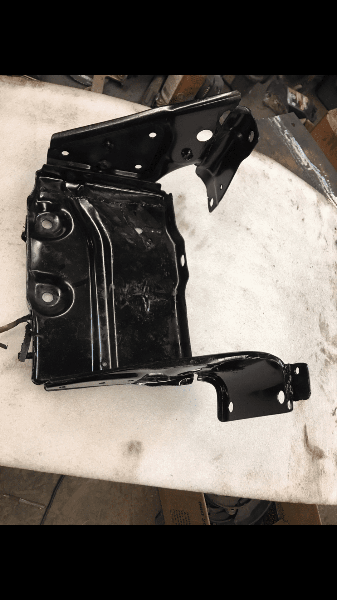

Making a second battery tray for the drivers side from a battery tray off a Mitsubishi Pajero,

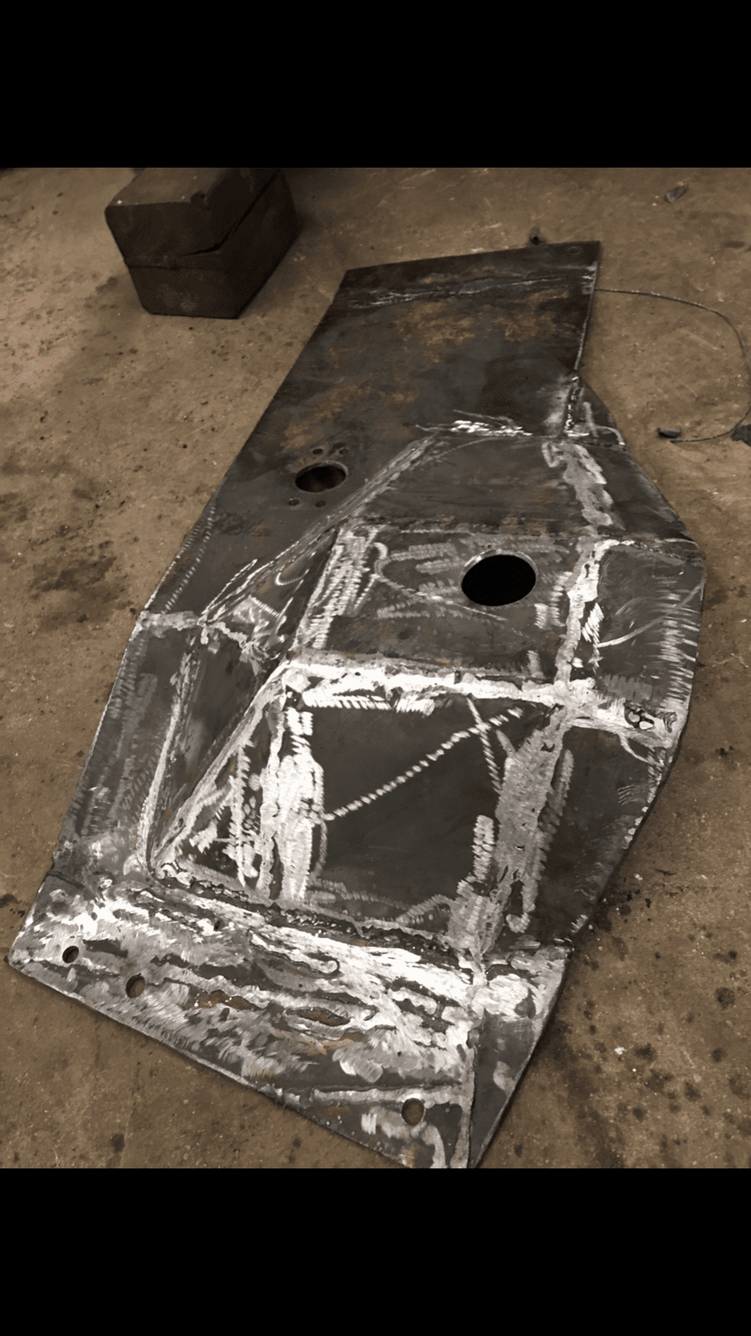

Building a skid plate under the toybox,I’ll build another one under the h55 at a later date
