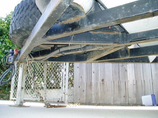

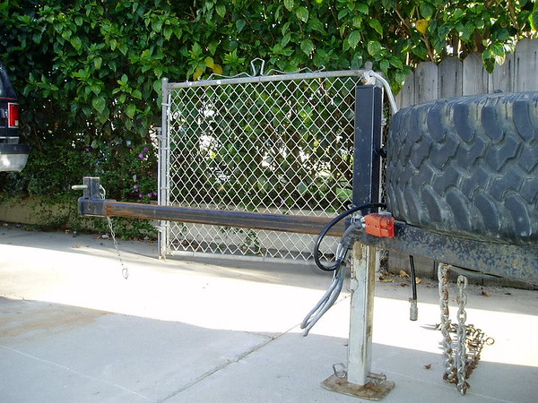

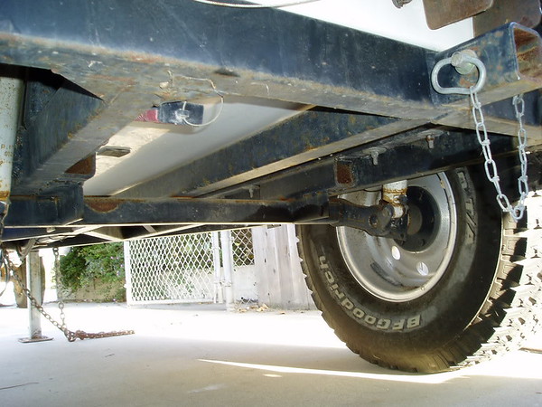

The custom frame under our TrailBlazer features a sliding tongue. I find it useful for moving around the yard w/o a dolly, but have never towed with it extended. The socket receiver tube extends the whole length of the trailer frame and was set-up so that the PO's cradled Warn M8 could be plugged into the rear of the trailer if need-be. I use it for our bike carrier.
That frame is stout.

It's been awhile since I've had a dump truck , but I think when my tongue was extended there was half mybe more of the sliding part of it was always inside the sleeve. If that makes sense. So if thats how yours is set up, you should be fine on the highway. It looks like your thickness is enough.
