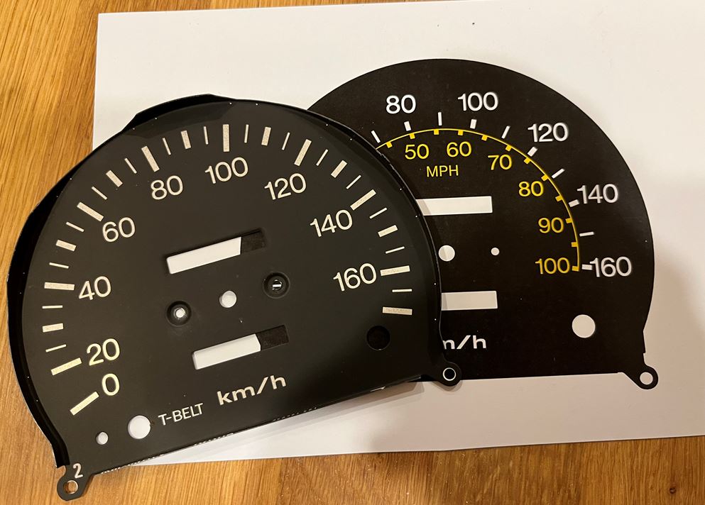

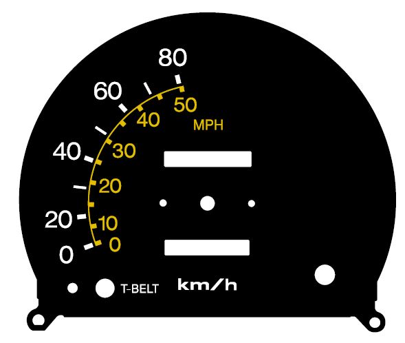

If I am understanding you correctly. I can revise the graphic where it is just the MPH dial but it won't work on the JDM face that these overlays are based off of. Here is a photo for comparison. As you can see the placement and size of the numbers on the km/h only face doesn't leave much room for a mph dial under it. Toyota has so many variants out there though.

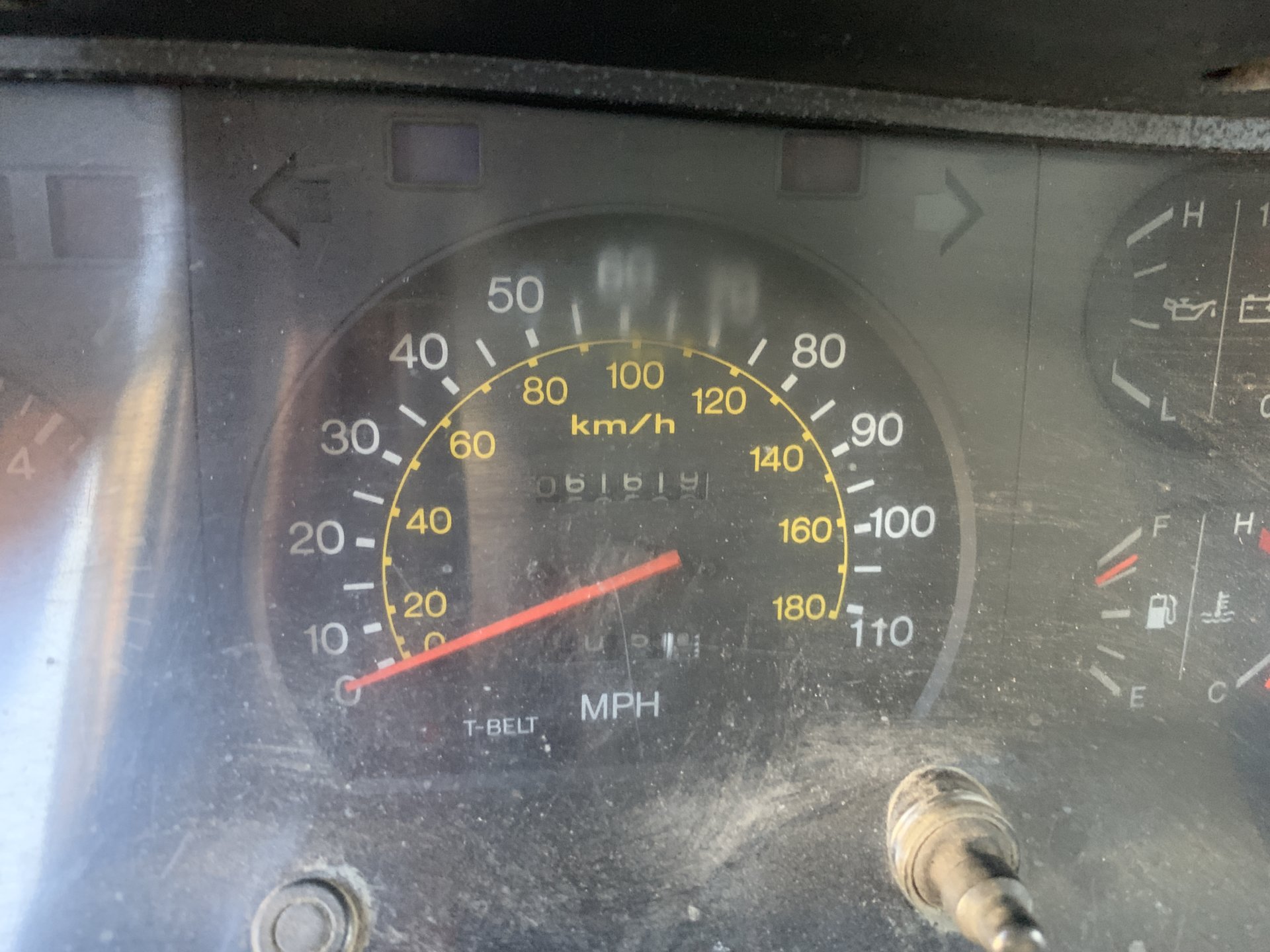

Here is the ultra rare factory version where the MPH is the main dial and km/h is the secondary dial. Problem with this one is you have to remember your odometer readout is still in km/h if this was made into a graphic overlay. Photo courtesty of @Eco 45

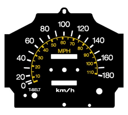

Final version of the 180kmh with mph marks. Probably needs to be tested so I will be sending one out to the donor of the cluster before I post up the printable file.

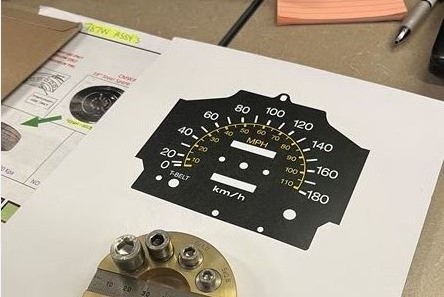

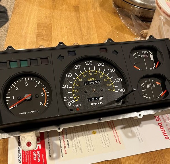

So I did a test fit on a spare cluster I have with the first print out which is just a test print. Lined up perfectly to me. I have no idea if Toyota ever made this version of the speedometer face from the factory but at least here it is now. The 180km/h with mph version!
I am not going to release it yet because I need to work on it some more.

That looks nicely done. If I still had that style of cluster I’d be pestering you for an overlay. 😊
