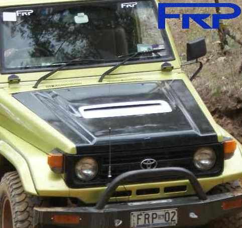

If you don't want to cut your hood you could buy a new one. I just ordered a couple of the hoods below for two of my cruisers as I will be going with top mount inter-coolers.
Who makes this hood? Does it already come with the vent built in?
