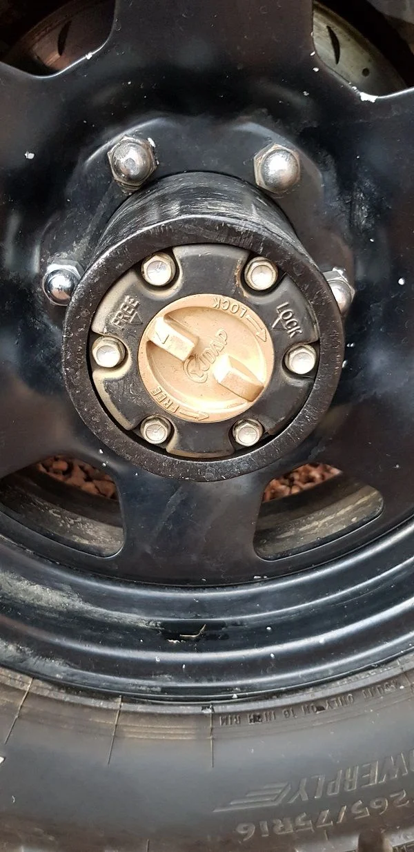

I just cannot figure this out since my truck has manual locking hubs.

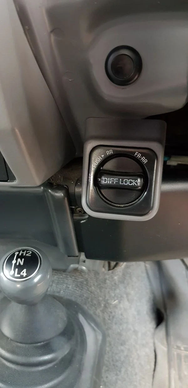

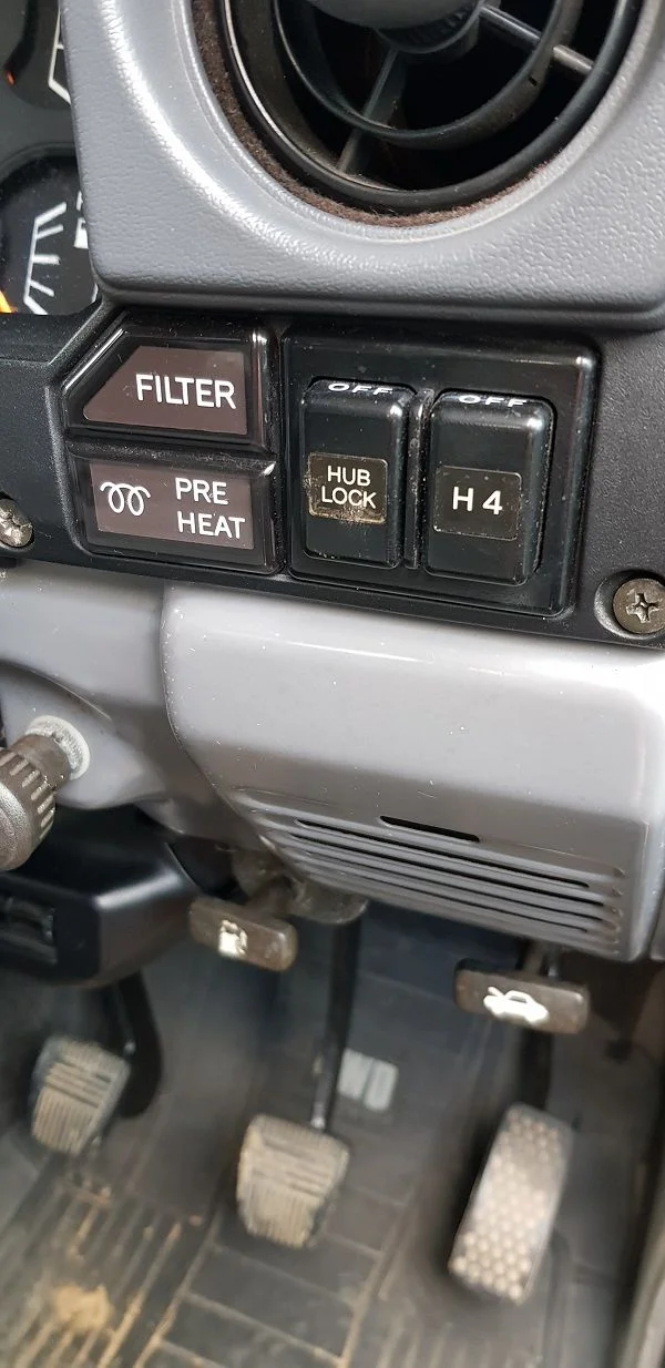

My truck has manual locking hubs. It also has the 'HUB LOCK' switch. I also have rear (RR) and front (FR) diff lockers.
What I would like to know is:
  1. How do I engage H4 (Do I need to manually lock my hubs, press the 'H4' AND the 'HUB LOCK' buttons?)
  2. When can I engage RR and FR lockers (must I have my hubs manually locked, the 'H4' and the 'HUB LOCK' buttons pressed?

Your Cruiser once had electric locking hubs. Along the way some PO swapped them for manual locking ones.

  1. Engaging H4: move both hubs to LOCK and depress the HUB LOCK button before pressing the H4 button. A PO may have deleted the electric hubs circuitry after the hub swap, but there is no way to be sure about it without disassembling the instrument panel.
  2. Engaging L4: stop the vehicle, depress the clutch and move the transfer lever to L4. Make sure the hubs are in LOCK.
  3. Shifting from L4 to H4: stop the vehicle and move the transfer lever to H2. Press the H4/Hub Lock buttons if necessary.

  6. Engaging the Rear Locker: make sure the transfer is in L4. Stop the vehicle, push the switch and turn it to RR.
  7. Engaging the Front Locker: make sure the transfer is in L4. Stop the vehicle, push the switch and turn it to FR.
Do not exceed 8 km/h (5 mph) when driving with the lockers engaged. Thread carefully: locking differentials can take a lot of abuse but break in a million pieces when not used properly.
Your truck may have a 4WD ECU. This module receives feedback from the Hub Lock switch to operate. That is the reason why you should push the Hub Lock button when using 4WD. And a good excuse to take the instrument panel apart and check the wiring...

You cannot engage the front locker only. Either you use the rear locker or both front and rear.
The rear locker will get you out of most difficult places. However, sometimes front and rear will be your only choice.
Steering is difficult when one or both lockers are engaged.

From H2 to L4, just lock the hubs, stop the vehicle and shift to L4.
From H4 to L4, the button is already depressed. Stop the vehicle and shift to L4.
From L4 to H4, make sure the H4 button is depressed.
From L4 to H2, stop the vehicle, shift to H2 and release the H4/Hub Lock buttons. Make sure you set the hubs to FREE.
If the 4WD light does not turn off, drive in reverse a little until the front drive disengages; the light will turn off.
Personally, I prefer to leave the H4 button depressed until I return to the asphalt. I like to stop the truck before shifting the transfer lever and/or engaging the lockers as well. Less wear and tear, but that is just my opinion.

Thanks for all the info, it is really helpful. However I am slightly confused regarding "From H2 to L4, just lock the hubs, stop the vehicle and shift to L4.". Do I also have to press in the H4 Button?
Reason why I ask is because you say "From L4 to H2, stop the vehicle, shift to H2 and release the H4/Hub Lock buttons." implying that H4 Button was depressed when in L4, which makes sense.
Hello,
My mistake, I forgot to write that. Yes, press the H4 button.
