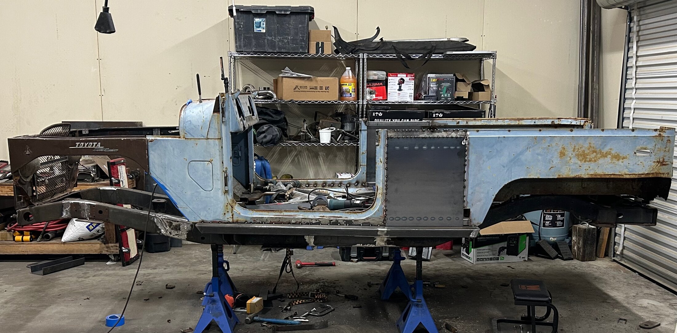

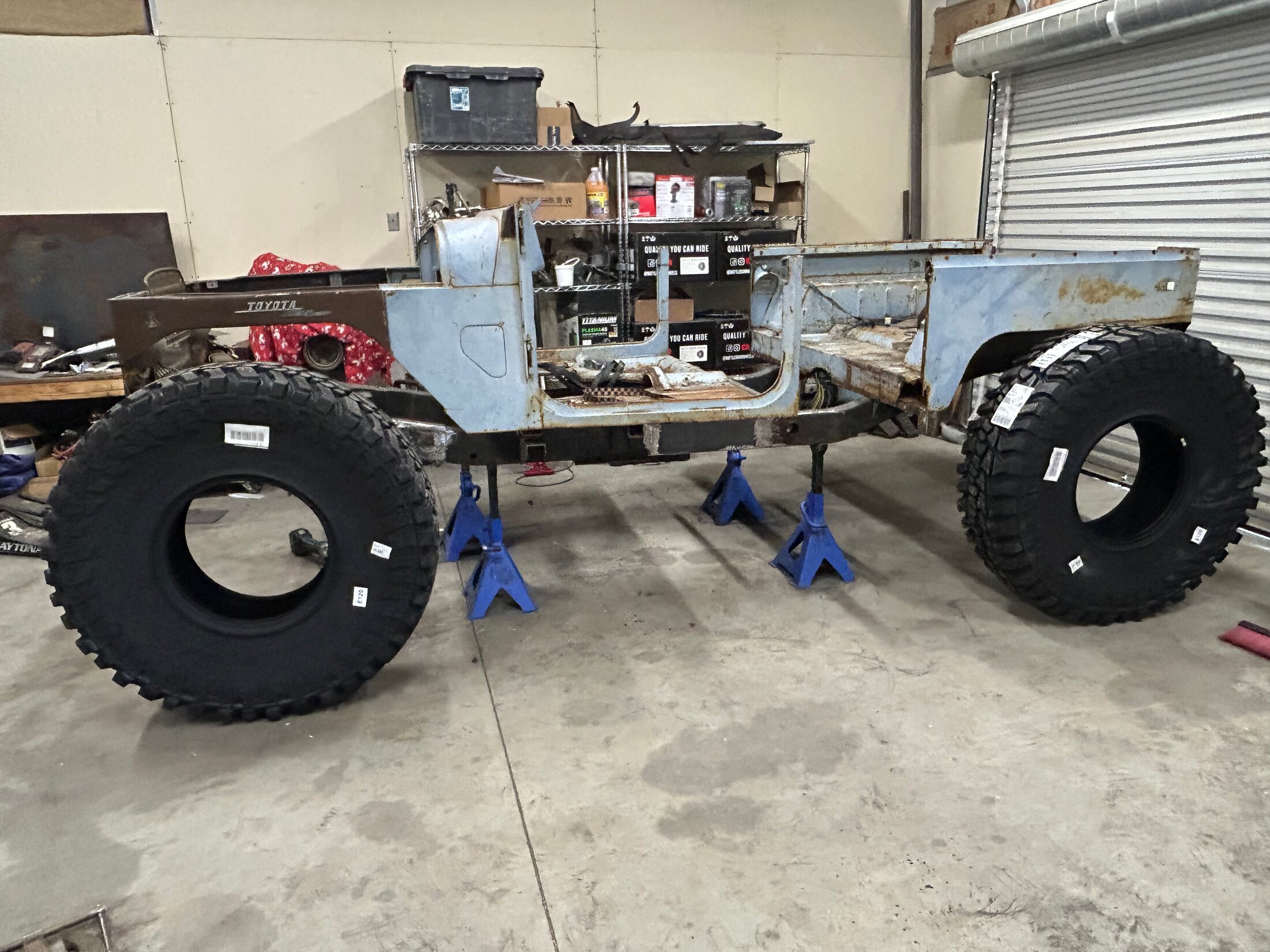

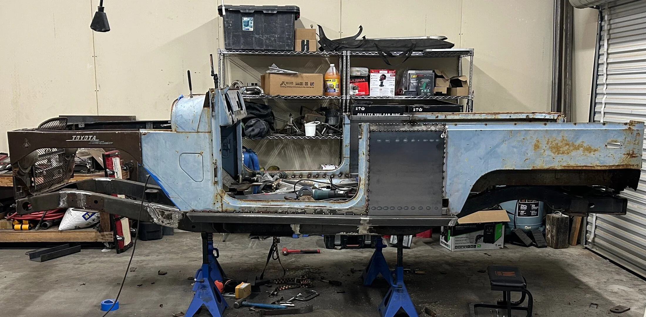

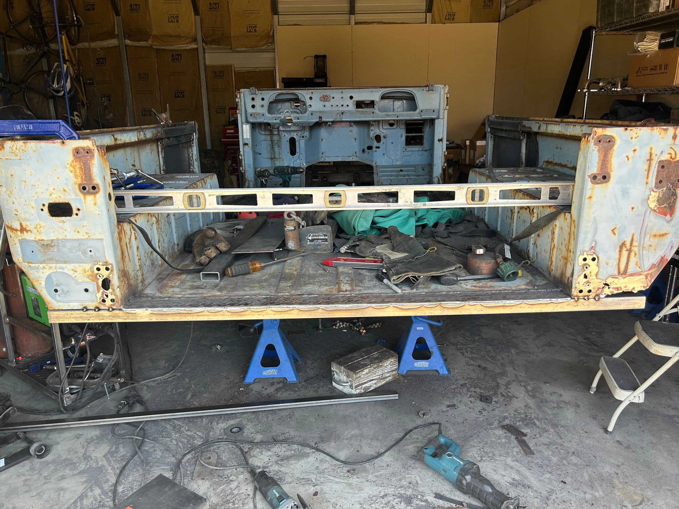

I'm starting the next built I decided to stretch a 40 16 inches and put 42" tires on it.
I found a fj on Facebook had to negotiate for 6 months, but finally got it for a fare price.
I've been working on it for a few months now and collecting pasts.

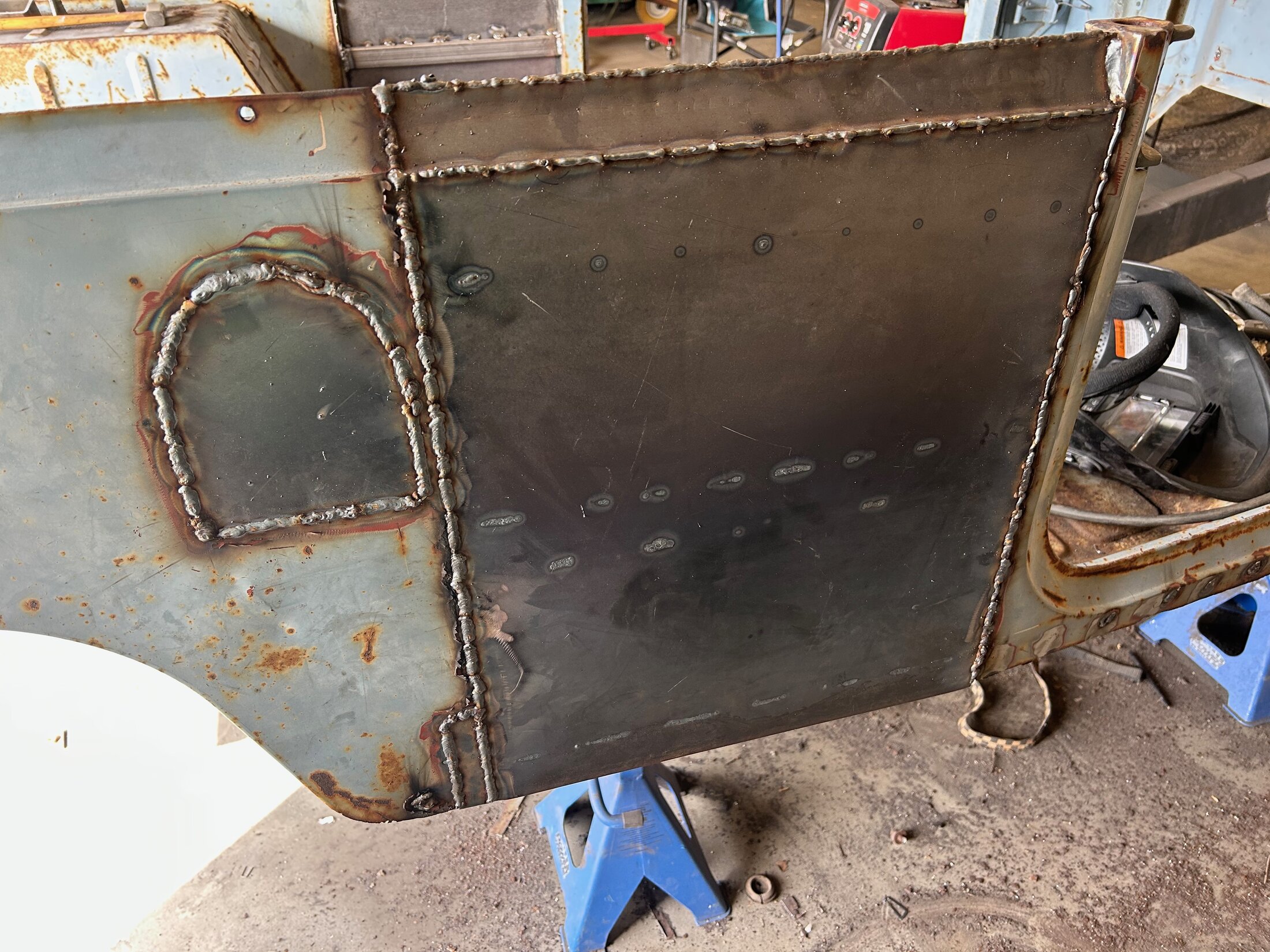

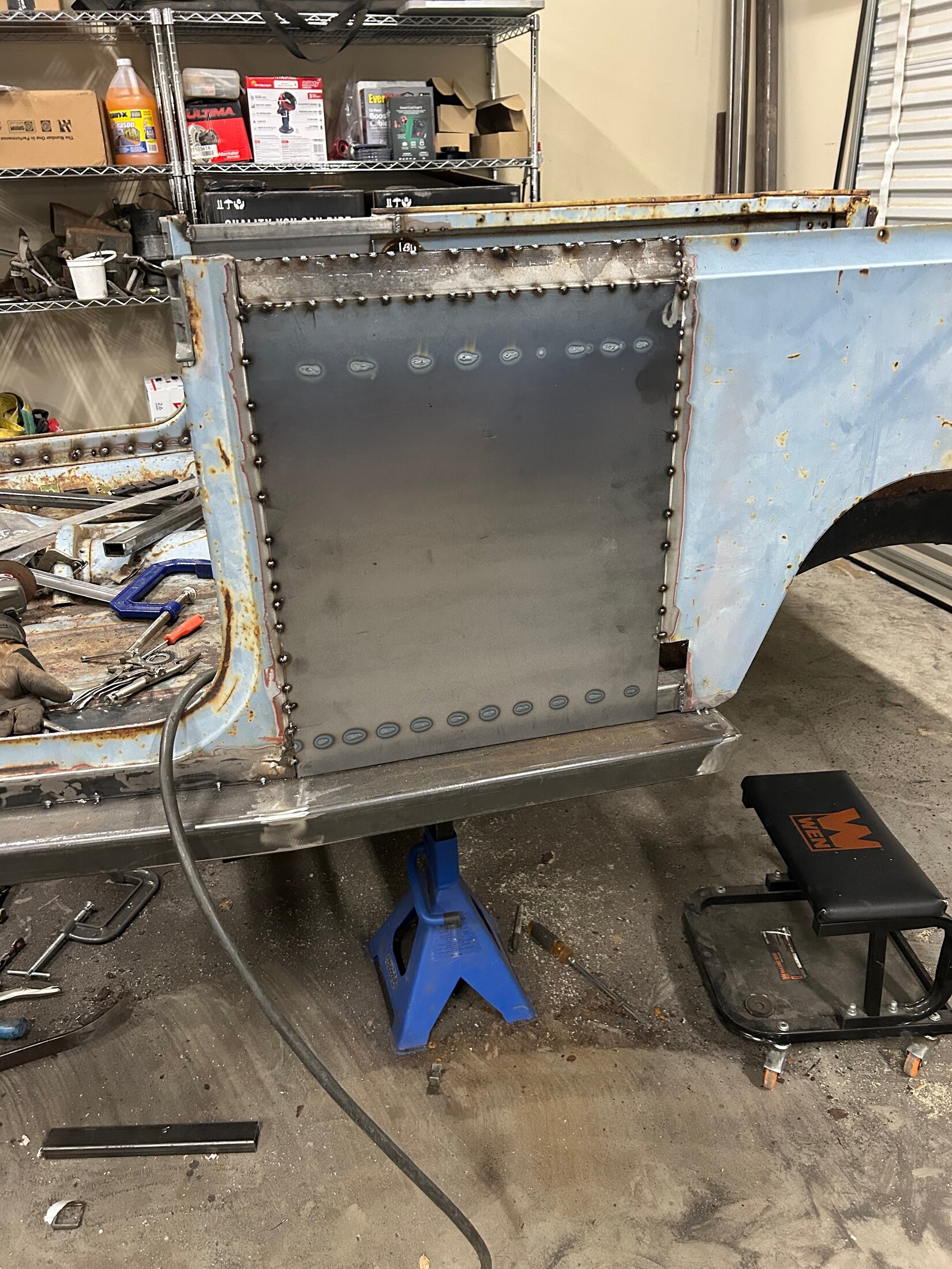

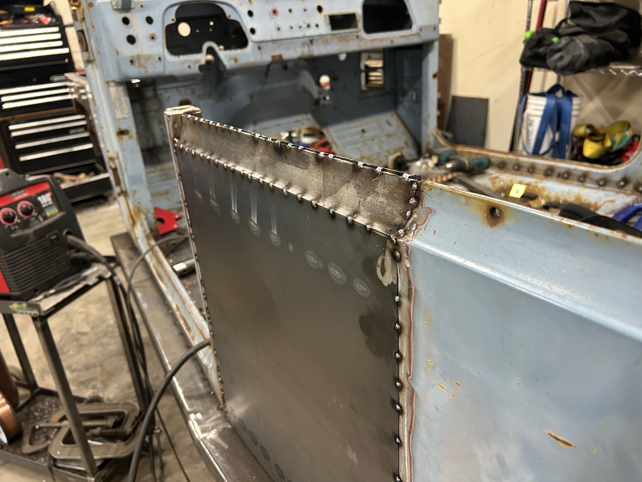

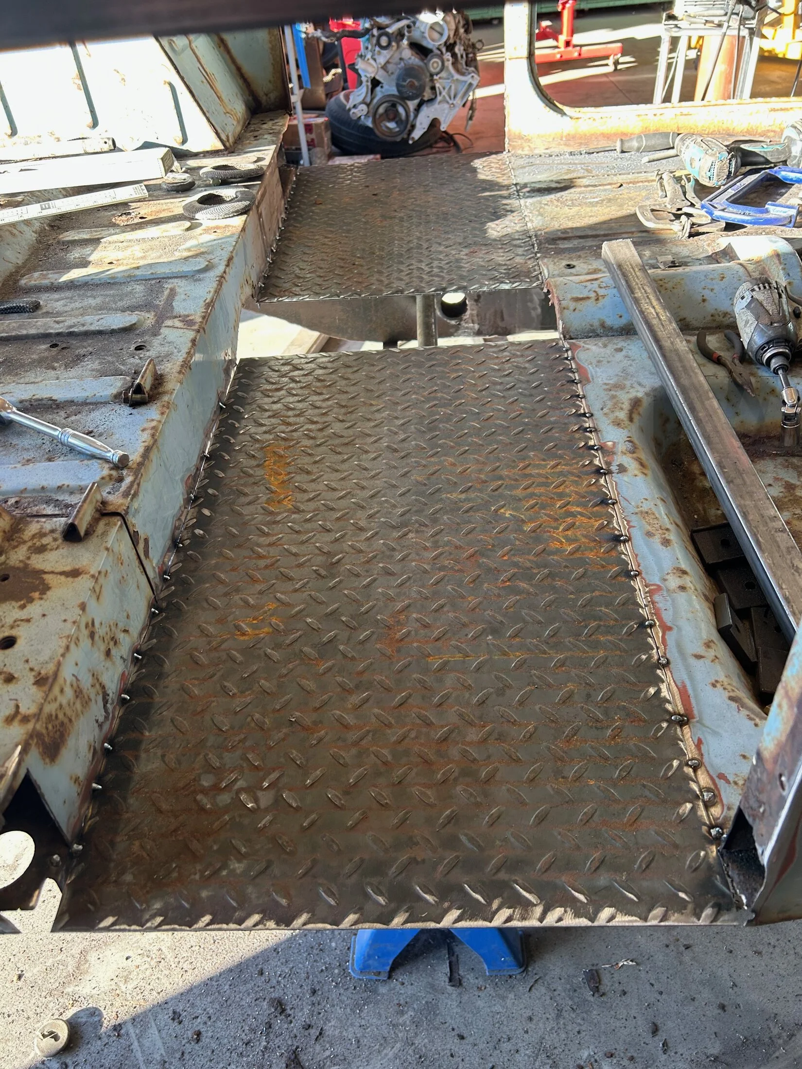

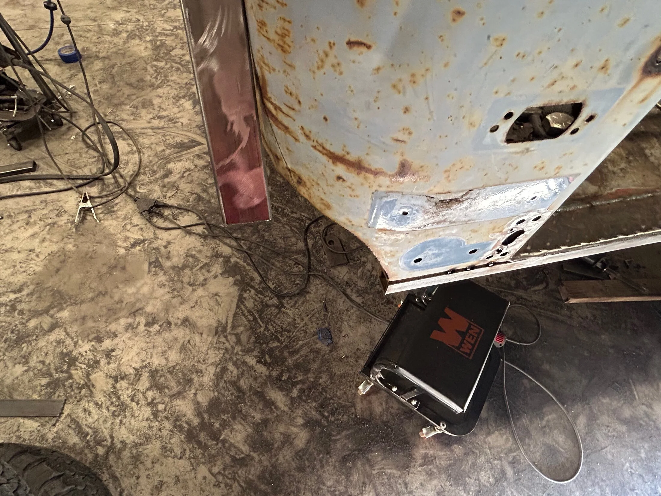

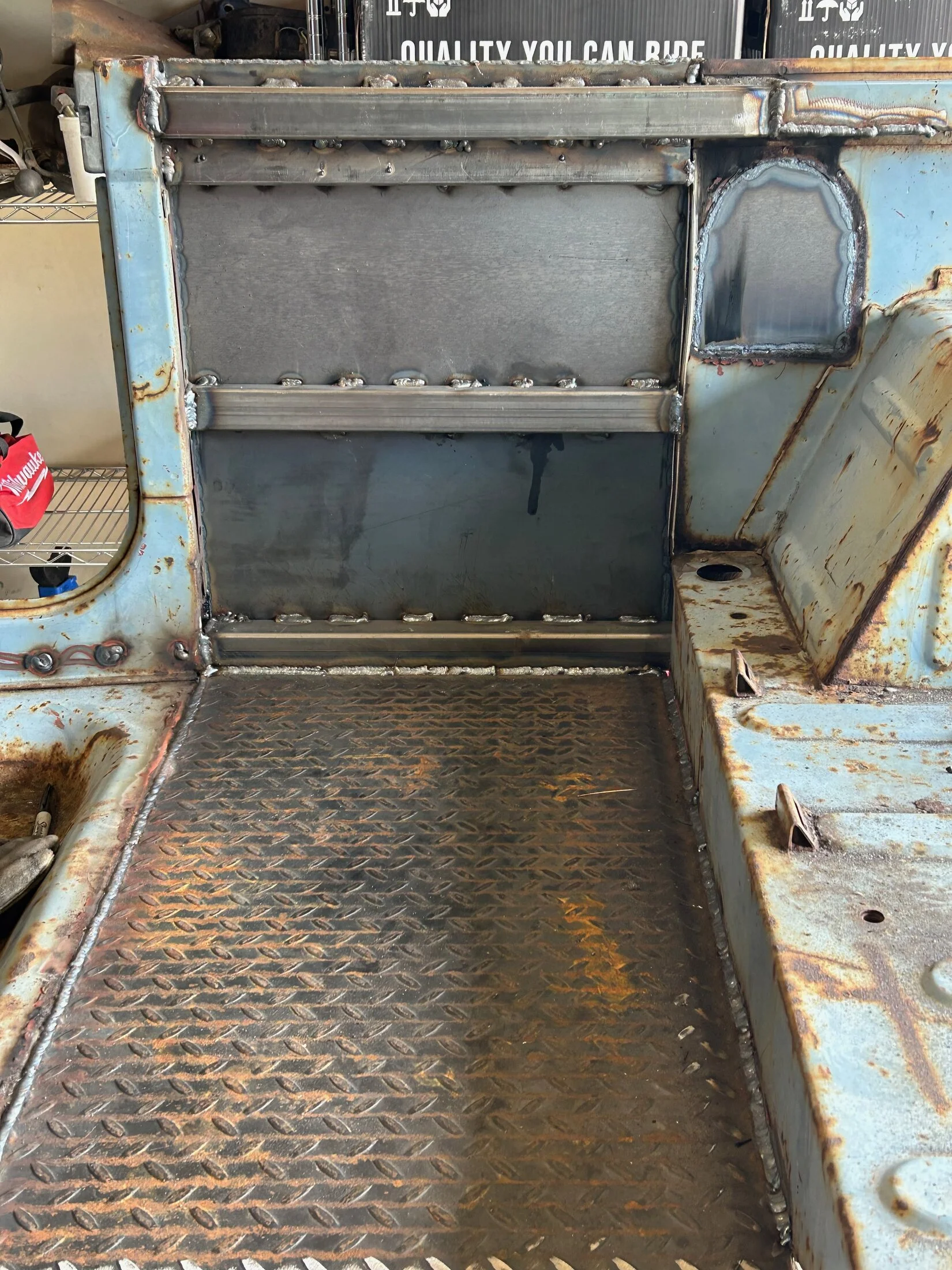

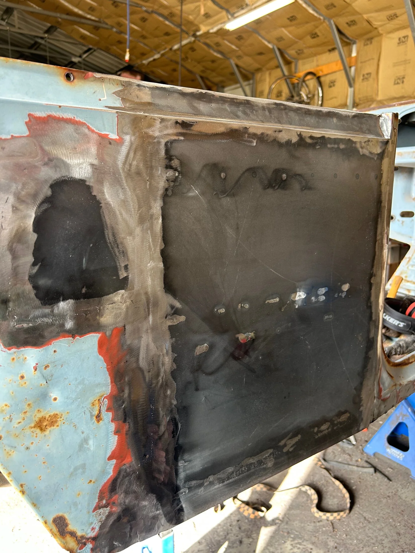

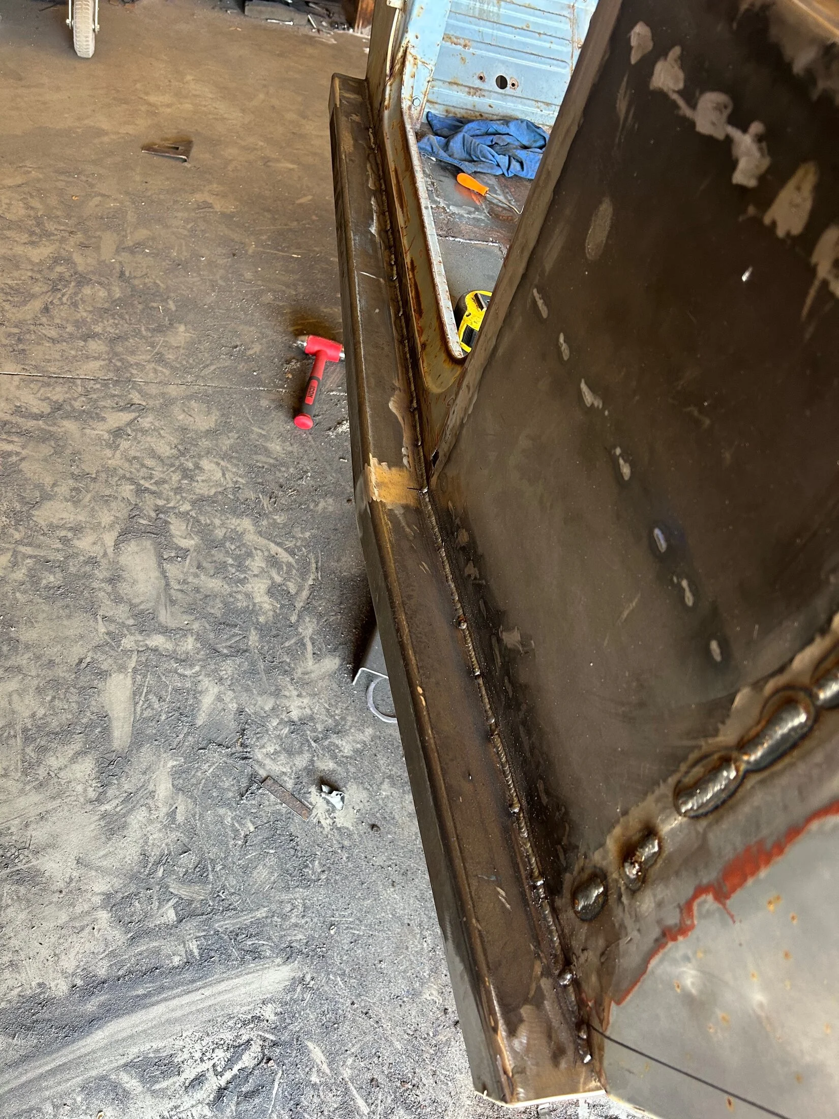

lots of welding and grinding today the panels came out pretty good.
It's is a 16" stretch hoping to get 112" to 114 wheel base.

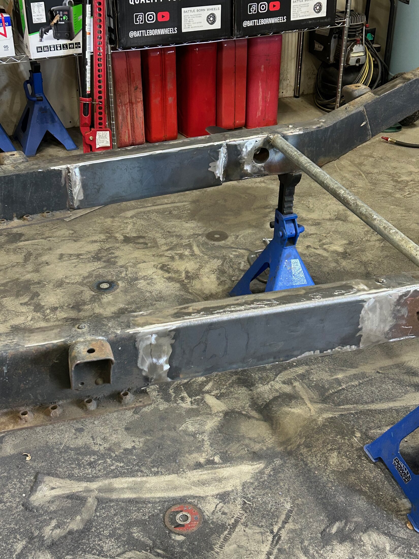

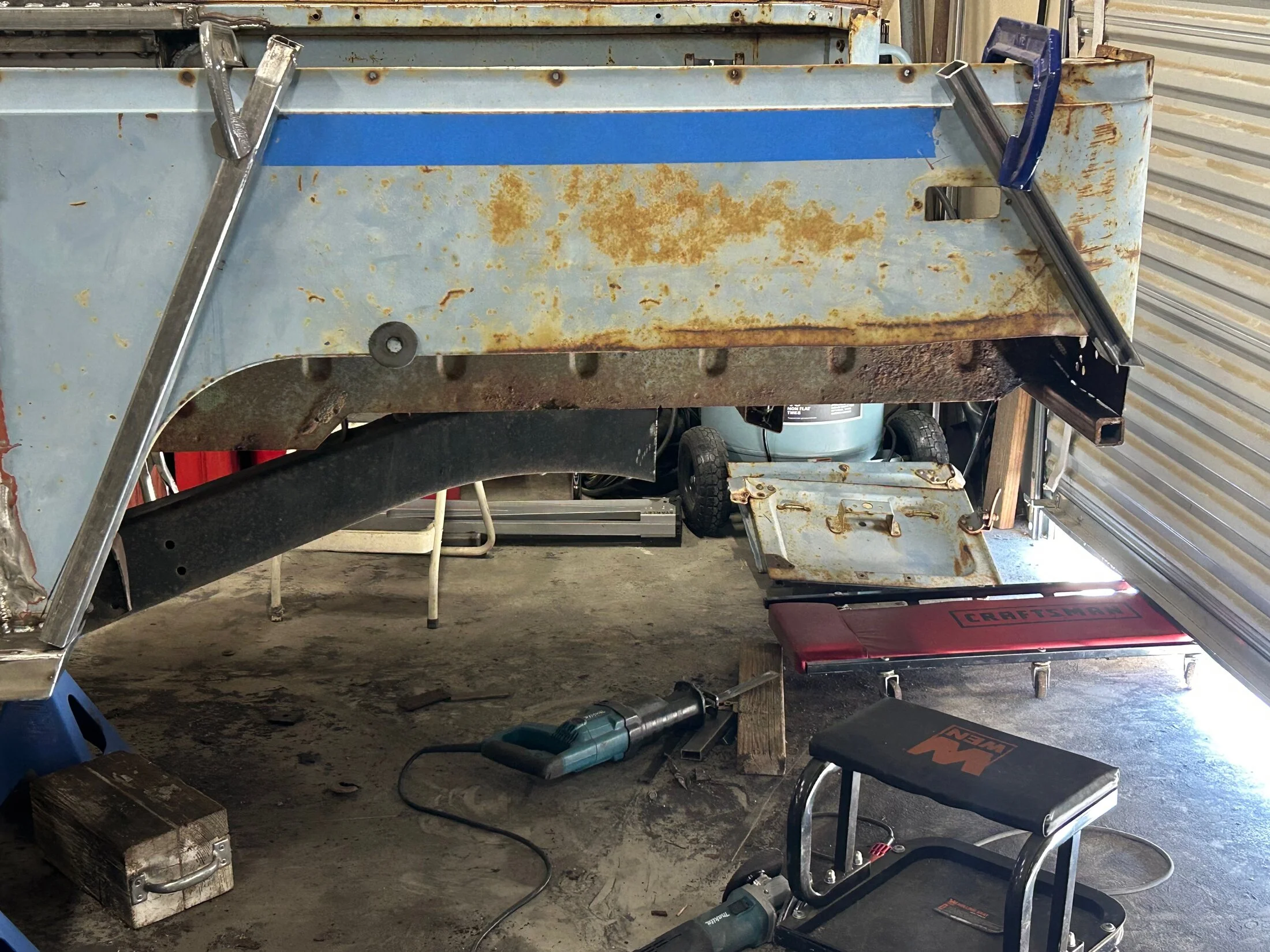

Worked on the back of the rig after welding in rock sliders and cut off back of the frame to raise back bumper. I just don't know how i'm going to tie in the rear body
