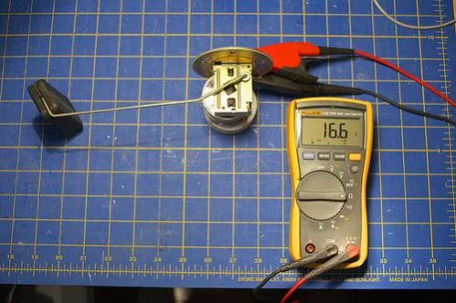

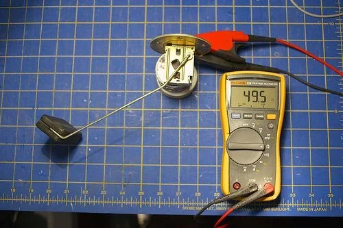

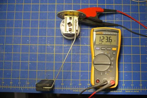

In the meantime try to measure the ohm values of your sender as Mud member FJ718 did.
You should read a steady number with the sender on the table. If you have changing/rolling numbers the sender has a bad contact between the slider contact and the resistor.

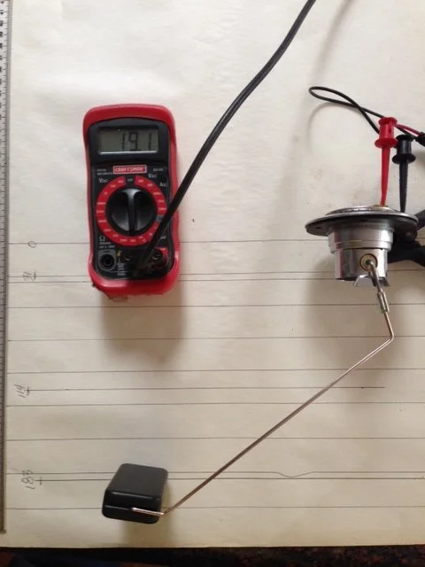

Regardless, I still cant get a number that I believe. It will 'search' for a number from lo to hi or sometimes it will just sit at one number as in the picture where it stays ~19 throughout E to F.
The reason I bought the new one was that my old one did the same thing, constantly searching and not giving me reliable readings.
What is interesting is when it is hooked up in the tank it will read way below E and then go only as high as 1/2F, acting like the scale is shifted to the left.
Are these that fragile? would you suspect a bad sender? I will see about returning it...crossing my fingers

Hmmmmm, I think you're mixing some up
PN#83310-60011 is the FUEL Gauge
PN#83320-35020 is the FUEL Sender
Mud member Downey responded that the values should read:
Empty: 110 ohm
Full: 3 ohm
So far it looks to me that you have a bad internal contact in that sender.
I assume that they are old as in "not recently manufactured" so maybe overtime corrosion had a chance.
