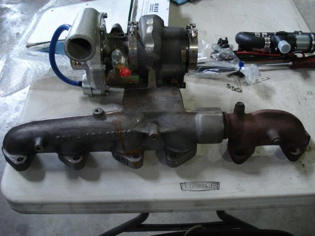

13BT CT26 turbo, manifold grey ceramic coat, hotside and dump black ceramic coat, cold side silver ceramic coat and pot rod adapted to become adjustable...

The ceramic keeps the heat in and spinning that turbine and it is about the only thing that will stick at 1300 degrees.
I wish I had done my turbine when I had it rebuild. I did the manifold and dump on my 1HD-T.

Heat efficiency is the key word for me...if that translates to performance then fine. It was all coming apart for a rebuild anyway, and I figured while it was off and apart...lets see.

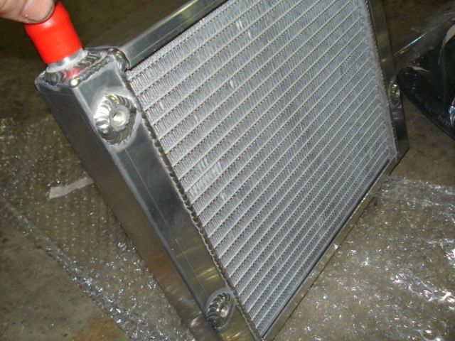

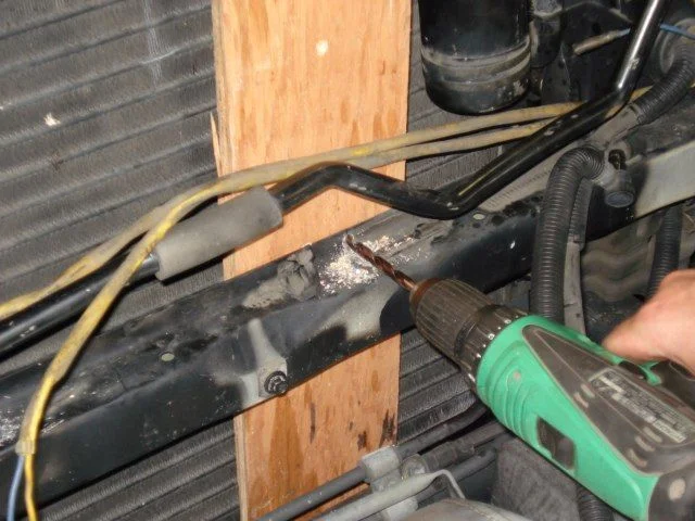

Had to do some mods, the interooler is suppose to come up from under the truck between the condensor and front tube support member, it just would not fit and I could see no fault of mine.
We did several small mods to make it work, the intercooler went in from the front and the original water pump was suppose to be up and down, we changed it to a sidways location and purchased some coolant elbows to make it work.
Nother note, the pump is twelve volt, could not find a bosch 24 volt to make it work, so we are putting in a 24 to 12 volt reducer.
Rob
The rad and condensor were spaced back toward the engine to make room for the intercooler.
Originally the directions said to install from the underside of the radiator and frame support, but there was no room so we changed the way the water pump was positioned from up and down to sideways and installed from the front.
