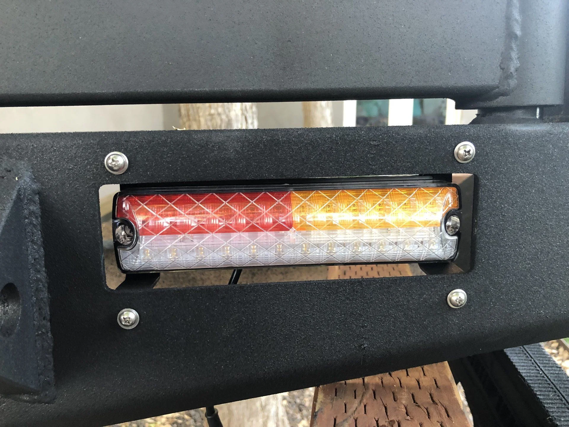

Are you putting these 3 way lights in the bumper as opposed to just backup lights?
I did go ahead and have James add the same 3-way Roadvision lights to my bumper. Same lights he uses on trail tailor bumpers. I'll post up pics on the RLC thread later today of that and my other changes.
