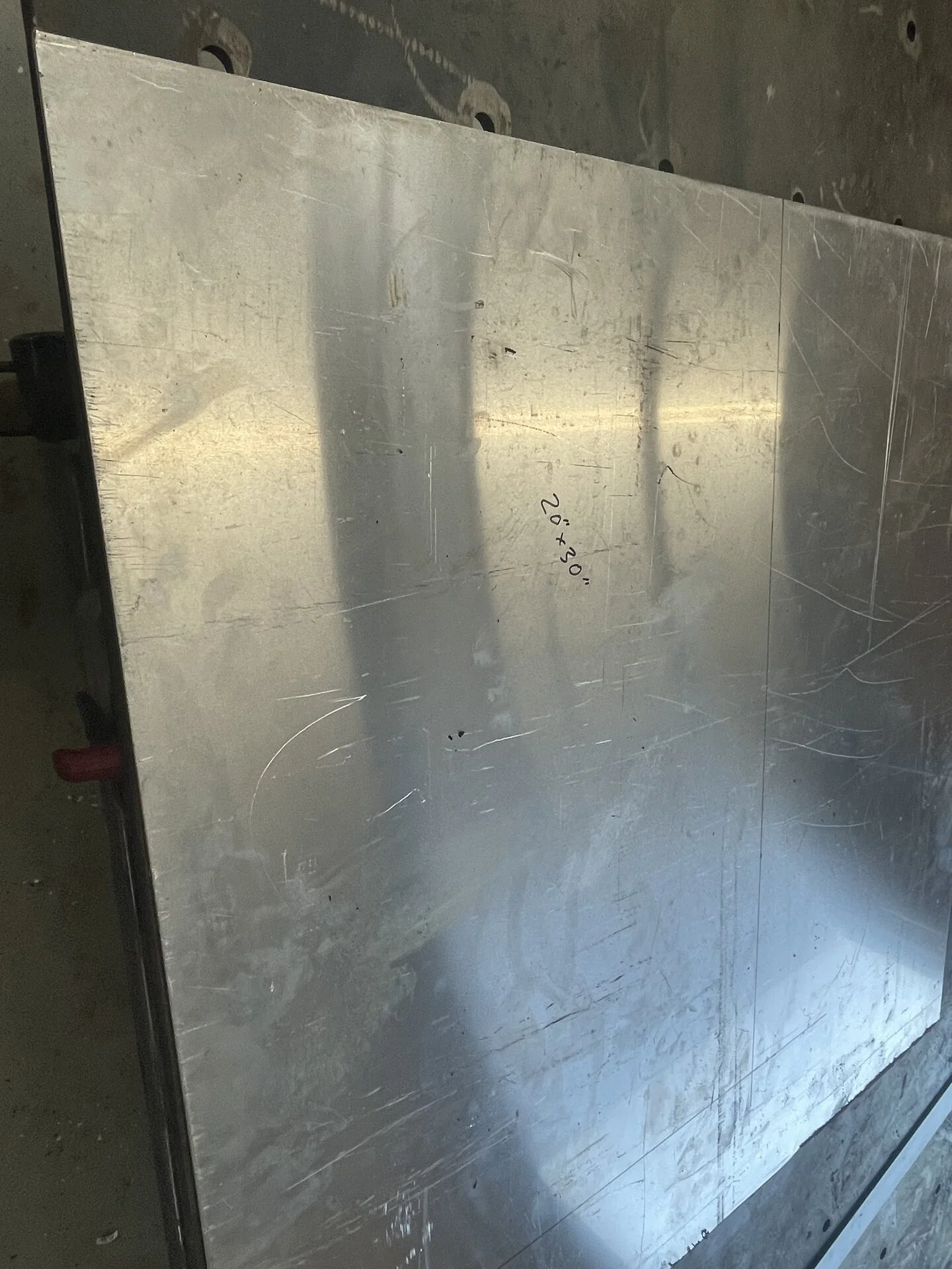

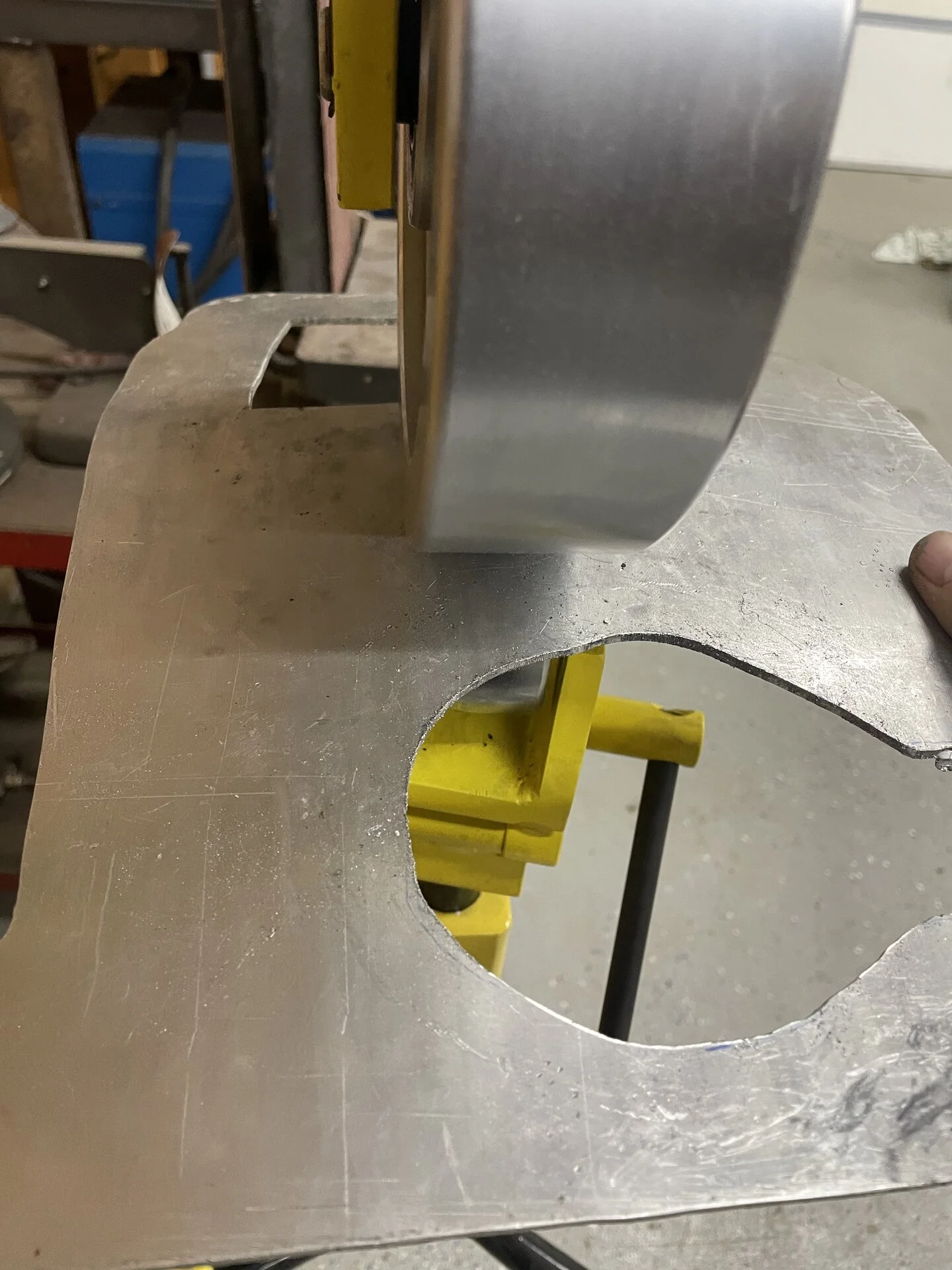

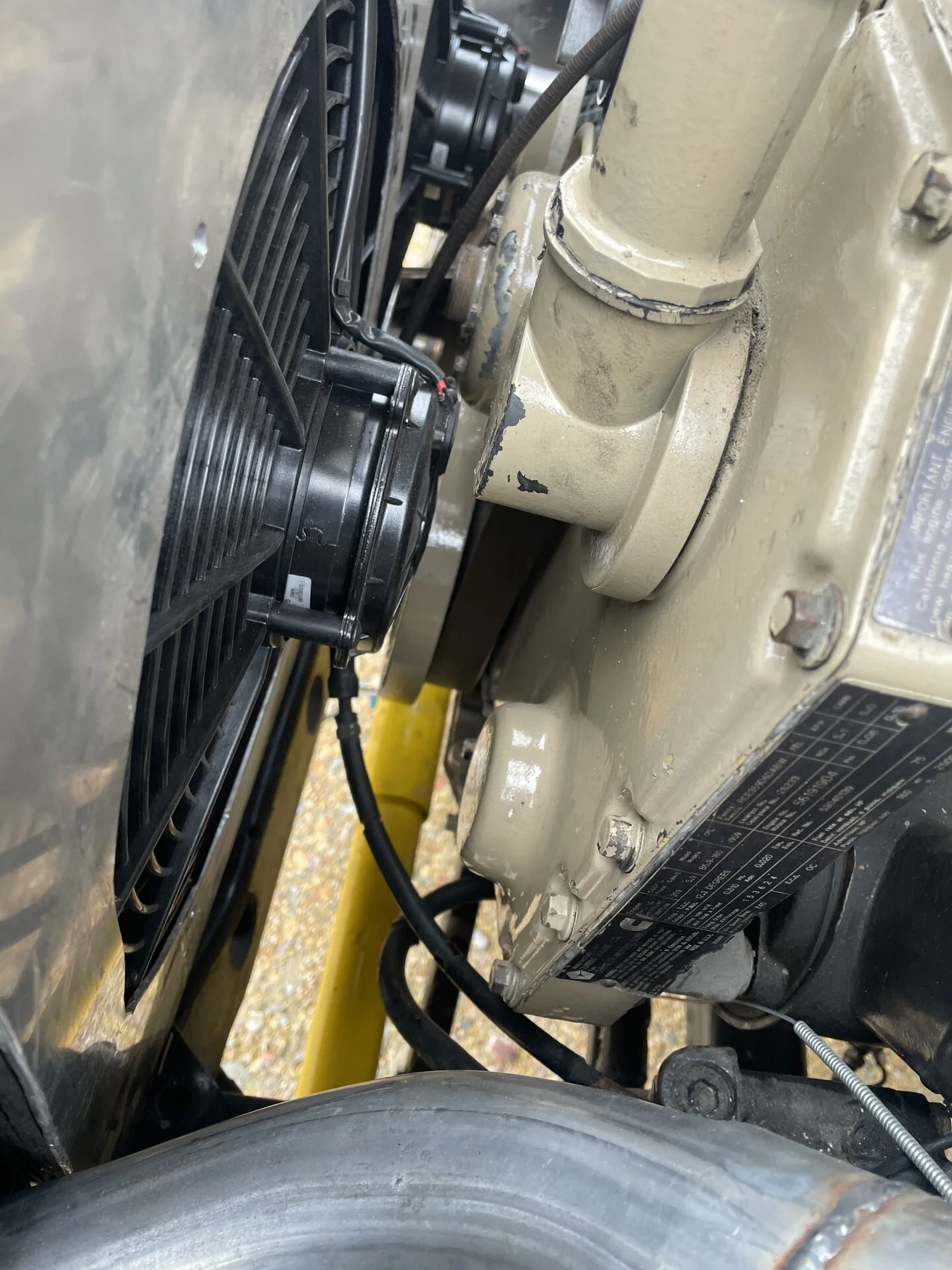

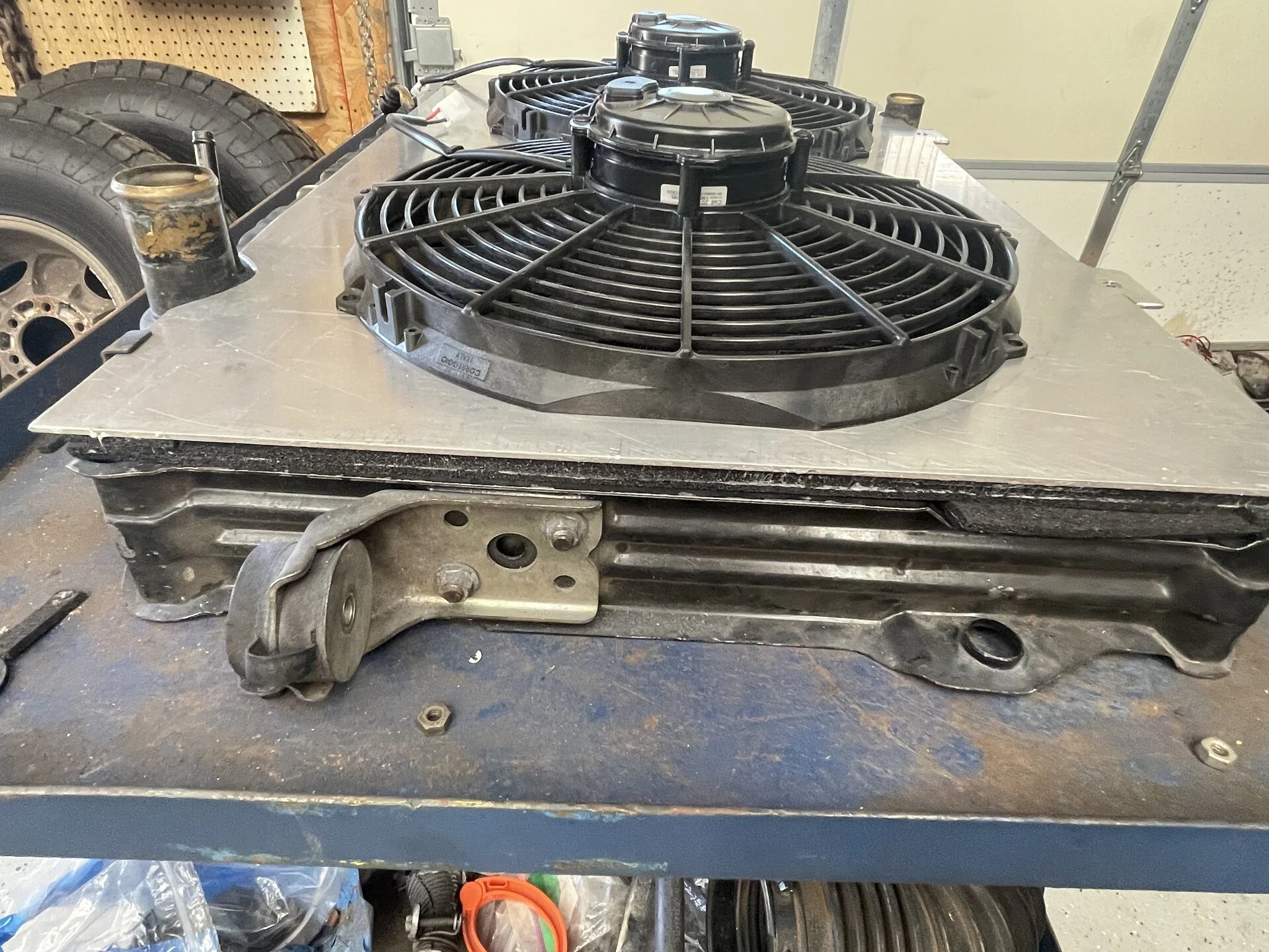

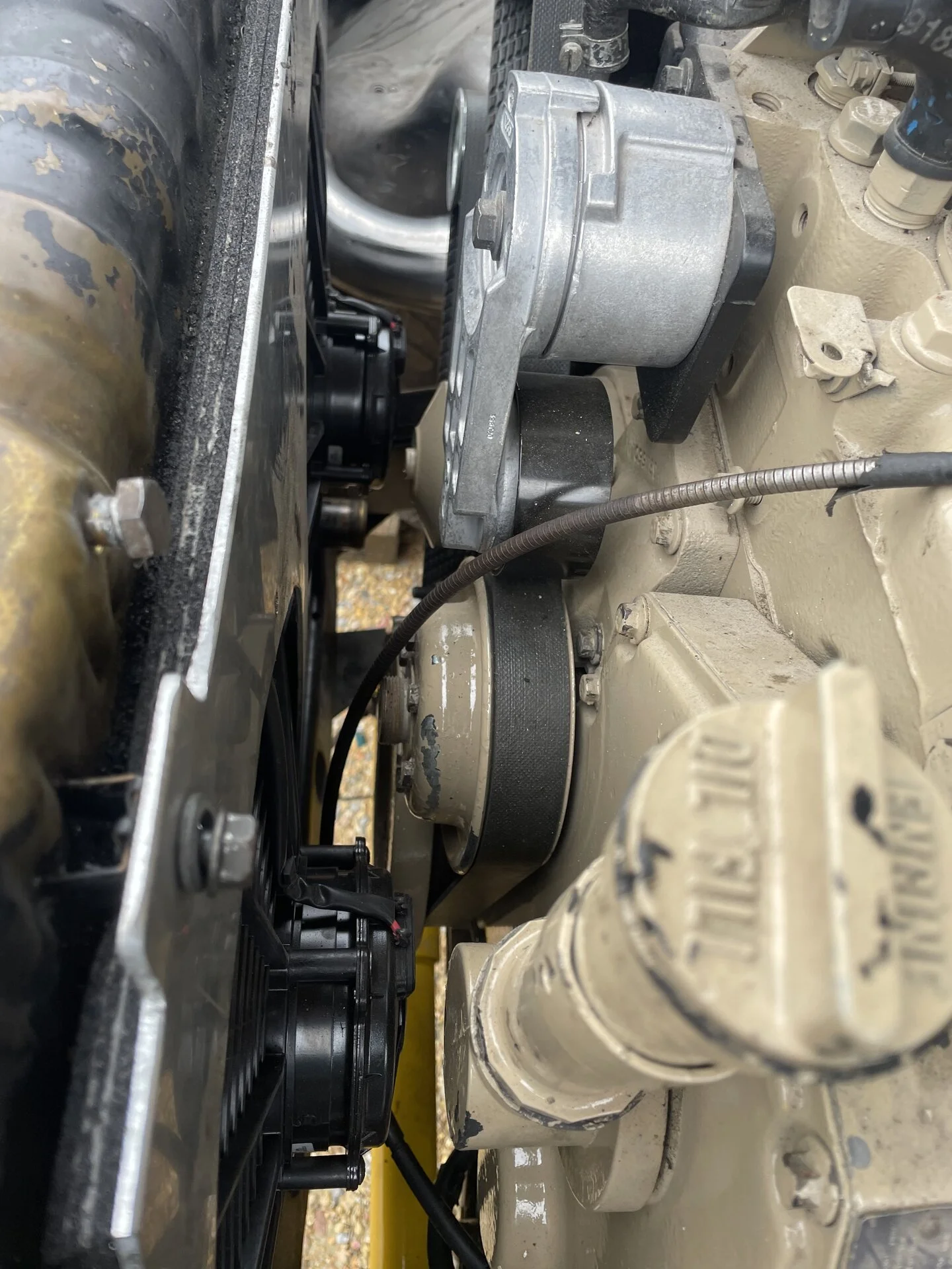

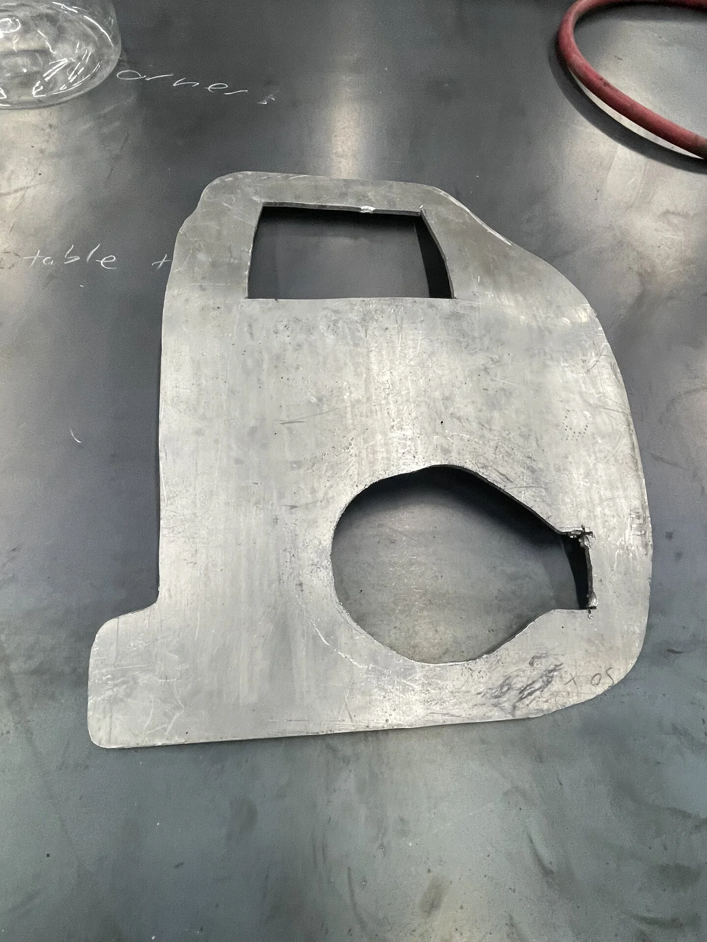

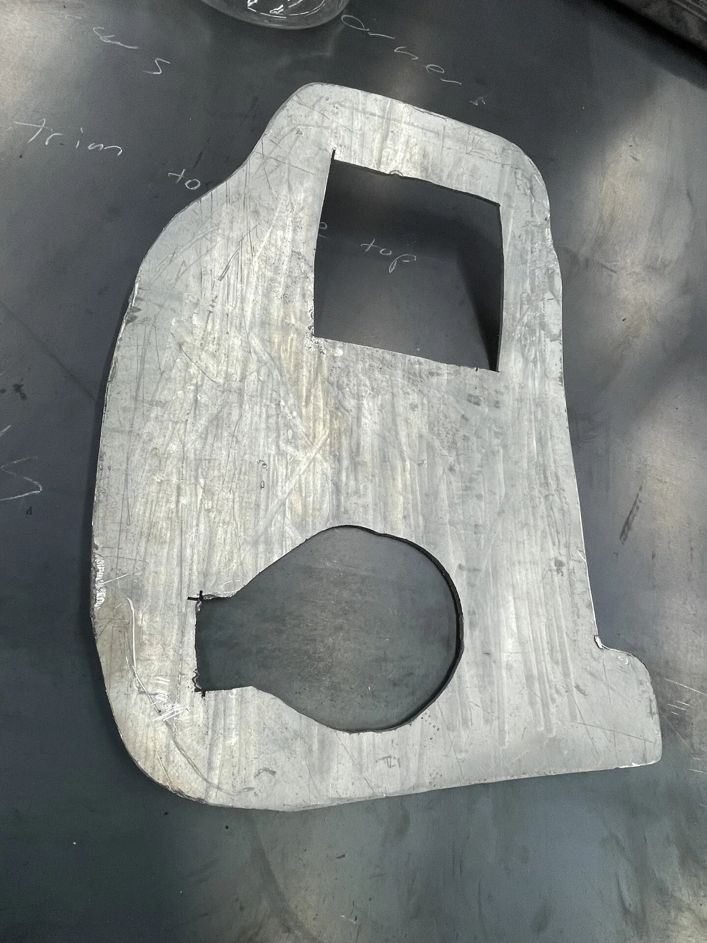

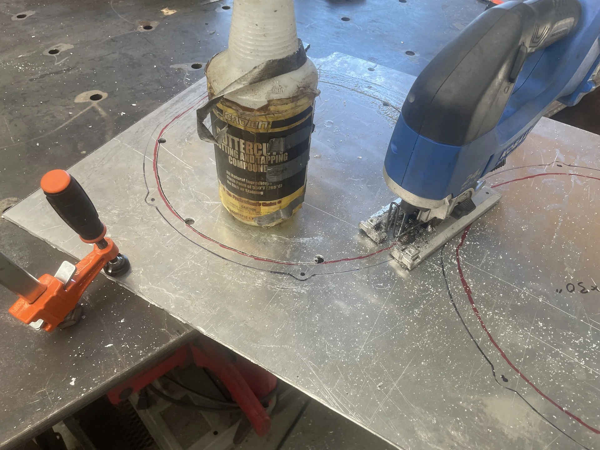

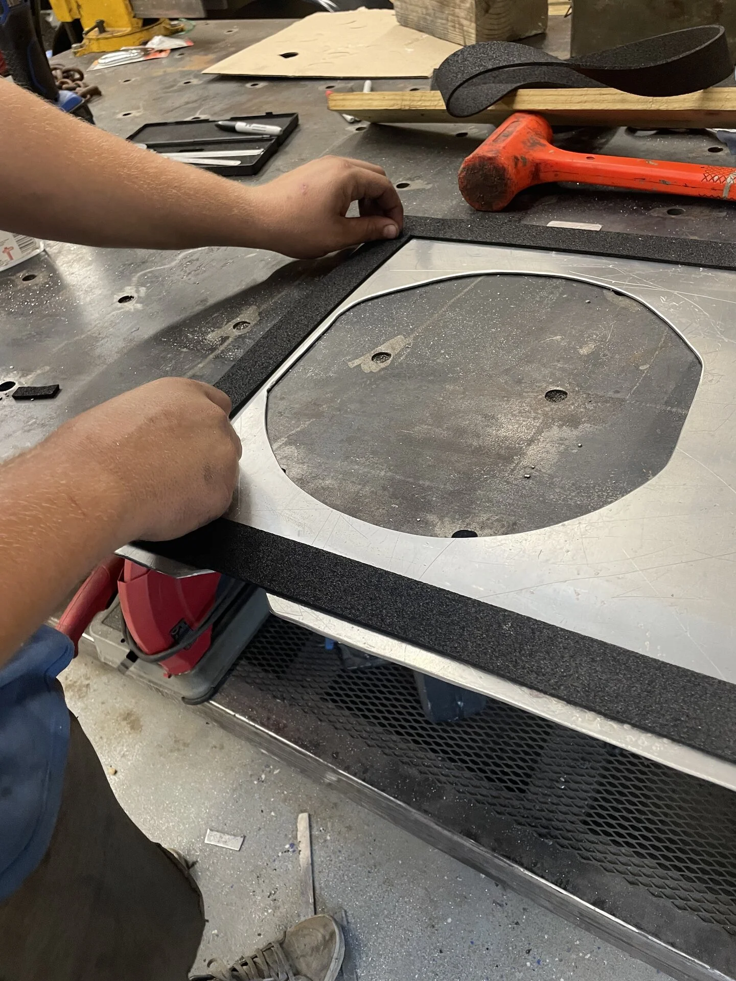

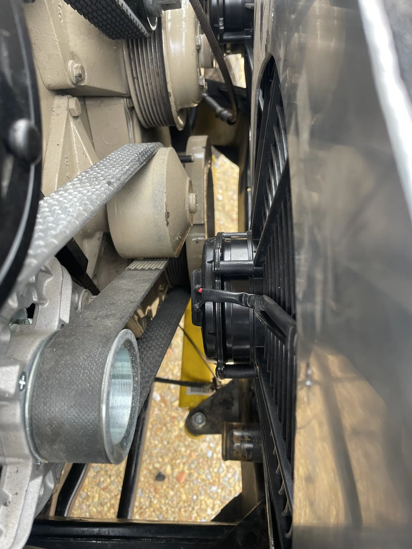

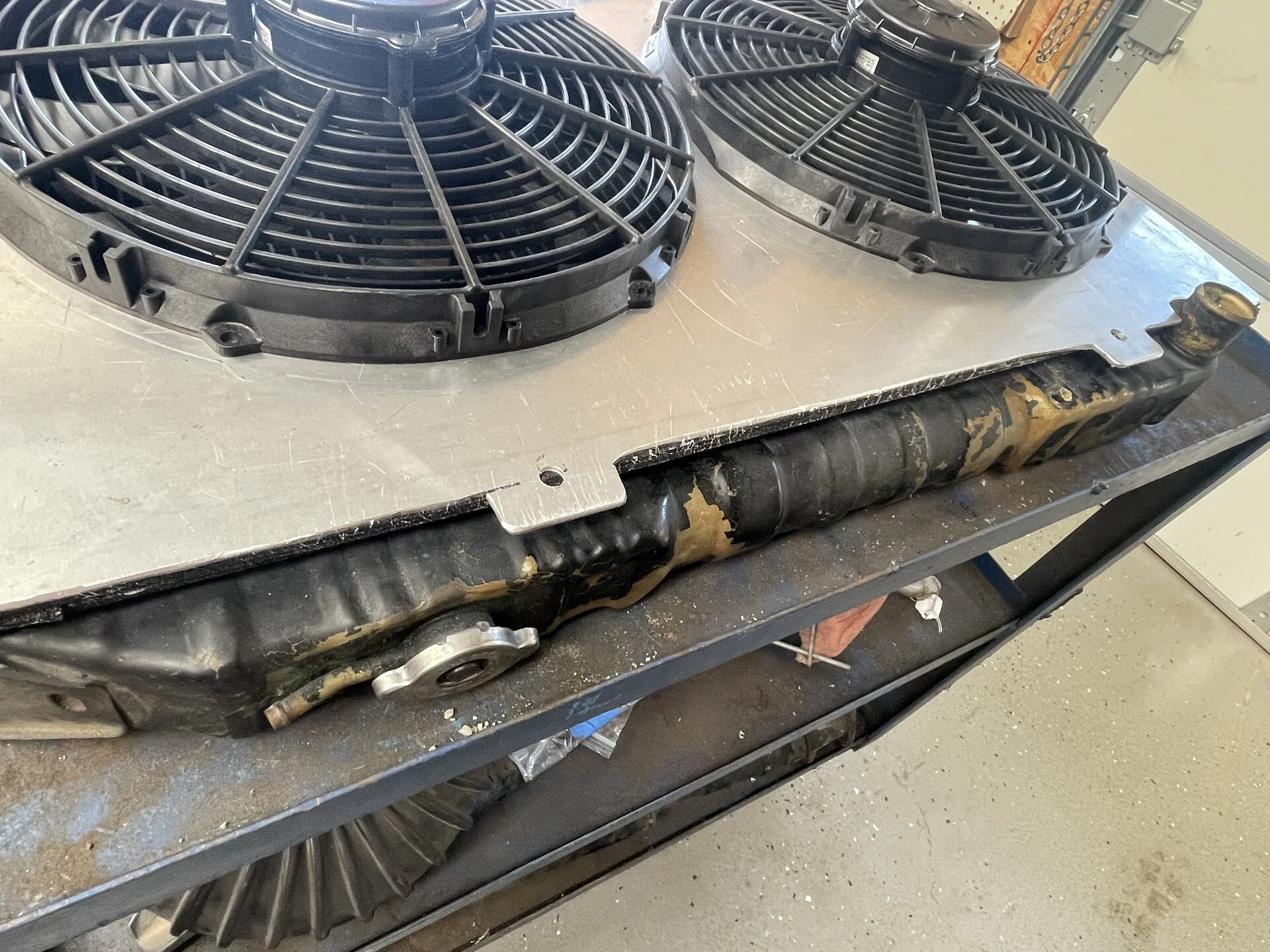

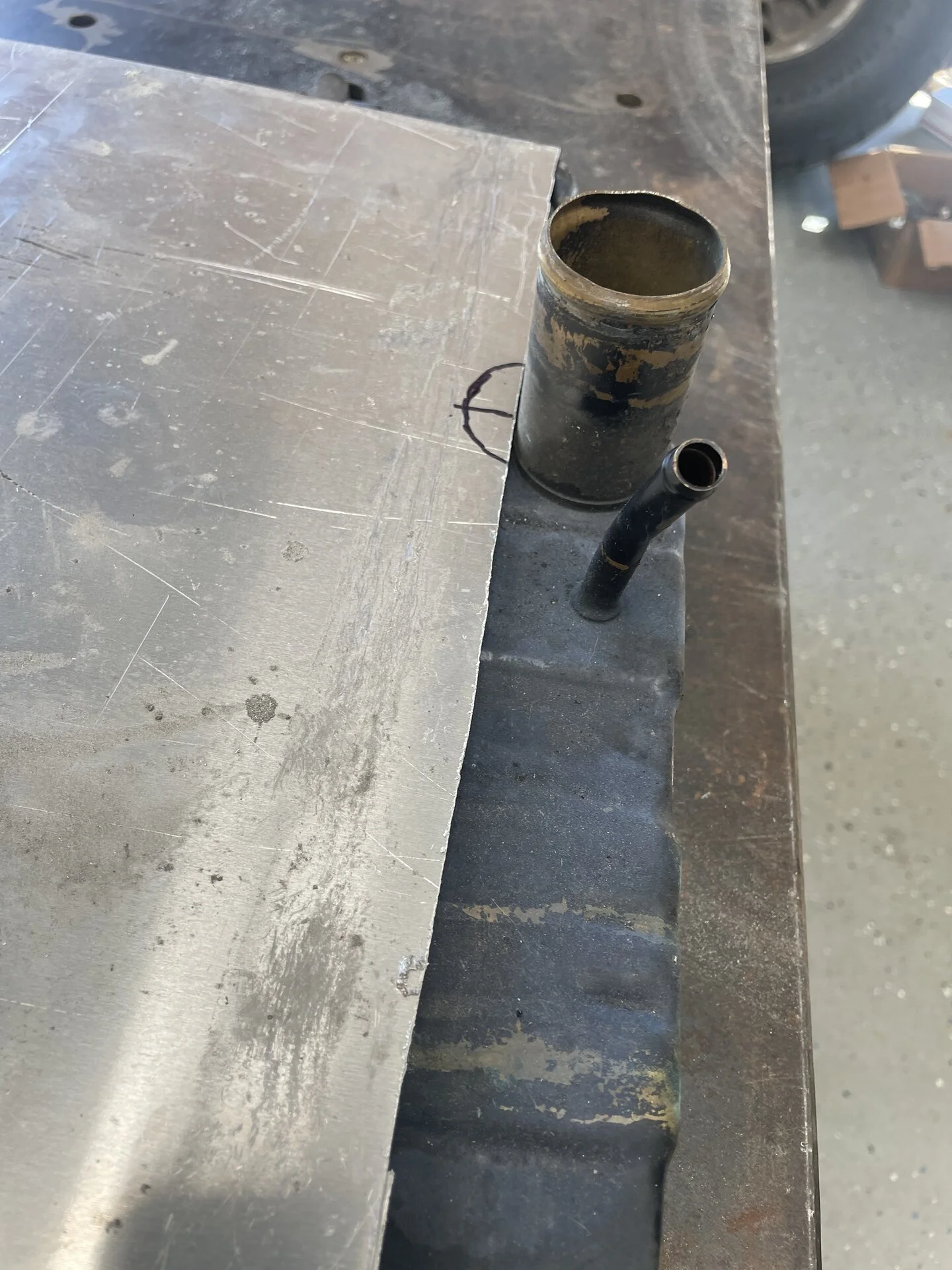

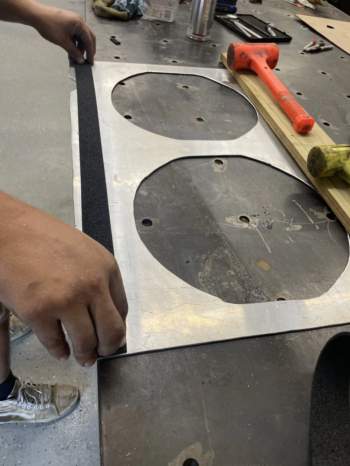

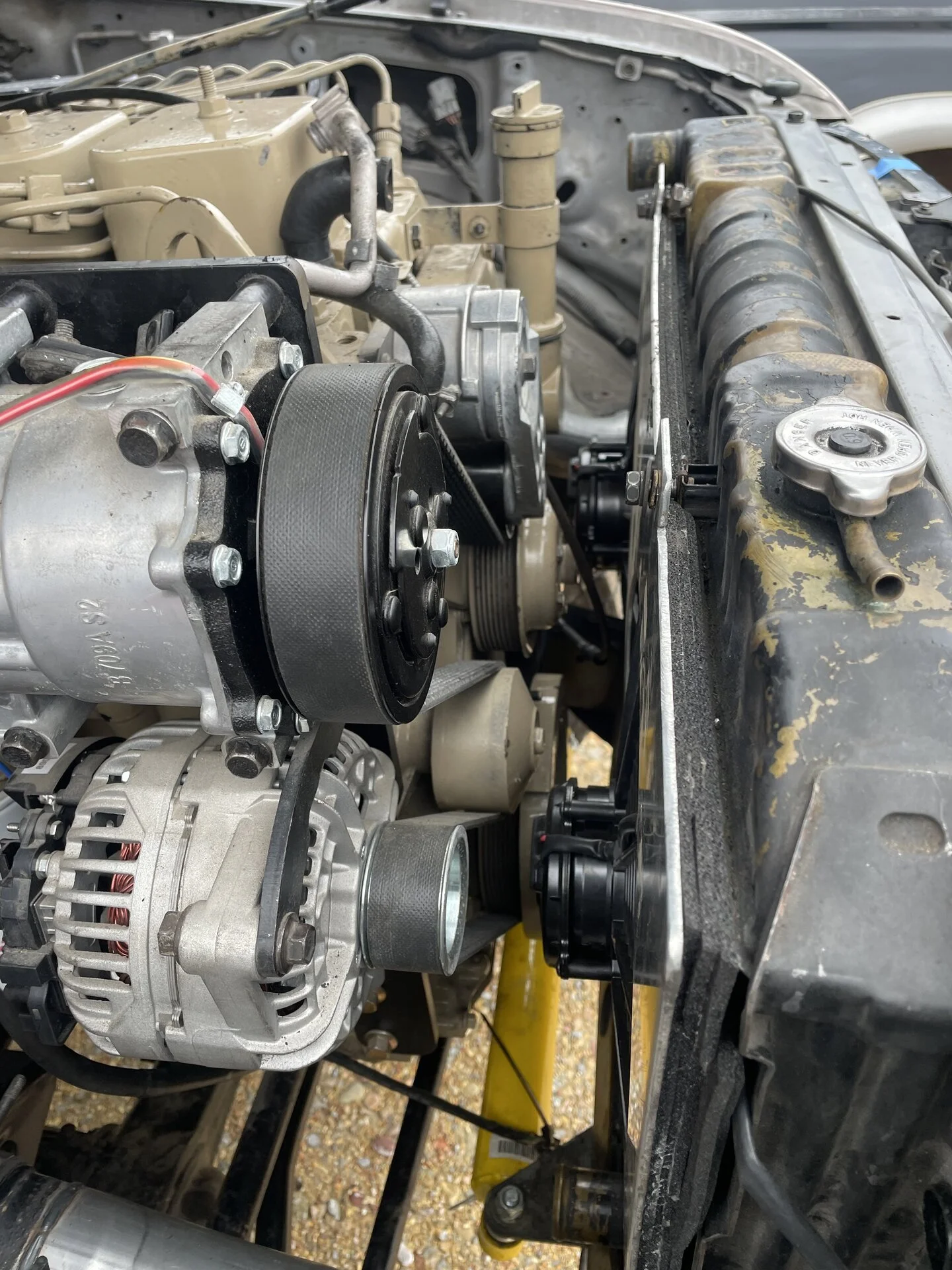

For now, I'm using two spal fans (13") and 195 degree F thermo-switch, wired through the EFI relay. Be sure to oil your jigsaw blade when cutting Aluminum. I first tried mounting the fans to the aluminum plate and mounting the plate to the radiator. The fans did not clear the Cummins pulleys, so I zip-tied them straight to the radiator and then mounted plate over the fans and that worked well. I glued some foam strips around the edge of the aluminum plate to help seal off around the fans.

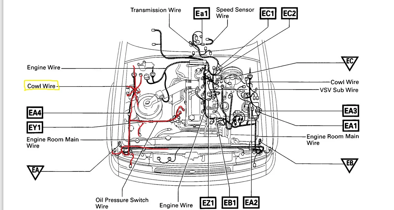

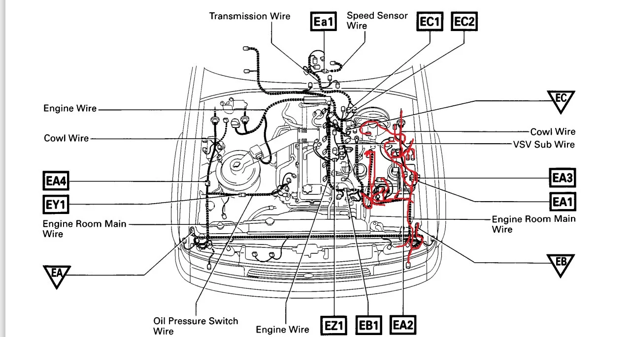

Cowl Wire on Driver's Fender – Circuits deleted
G 1 – Generator
I 2 – Igniter
A 7 – ABS relay
A 6 - ABS relay
A 5 – ABS Actuator
A 4 - ABS Actuator
N 1 – Noise Filter (ignition system)
I 3 – Ignition coil
F 4 – Fuel relay
B 1 – Brake Fluid level warning switch
Cowl Wire on Passenger's Fender - Circuits deleted.
C 4 – Cruise Control Actuator
F 5 – Fuel Pump Resistor
A 8 – Auto Antenna Motor

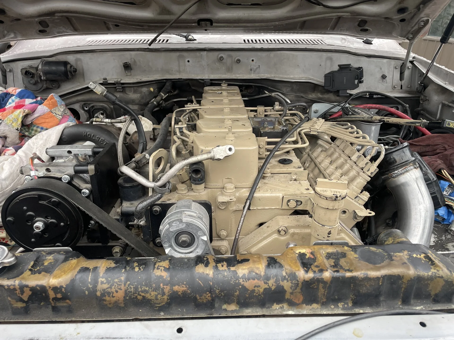

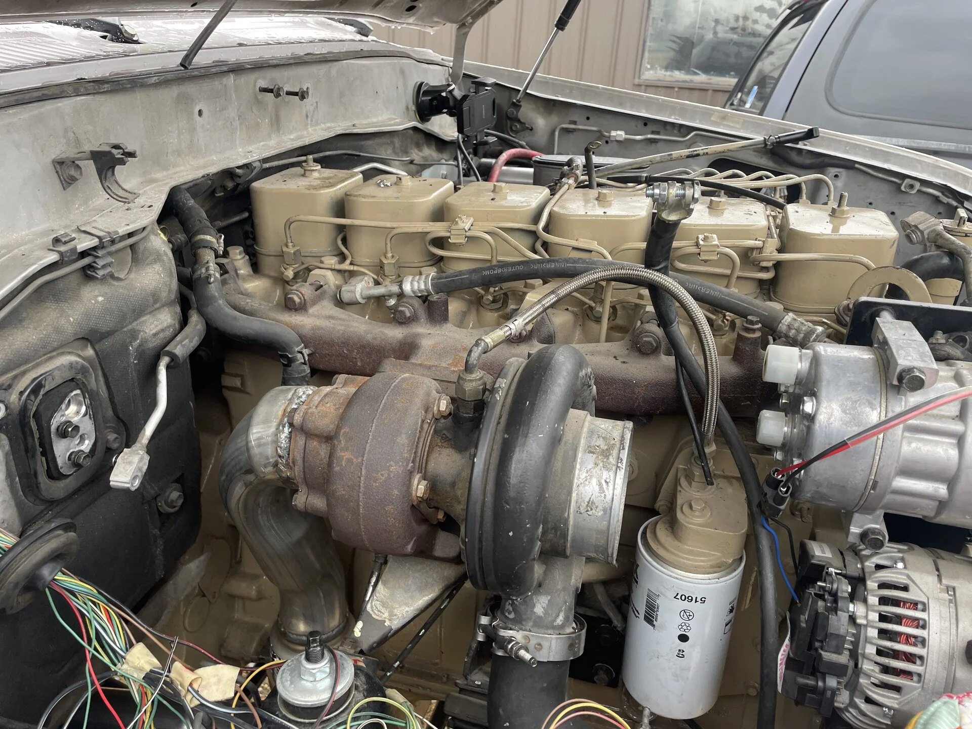

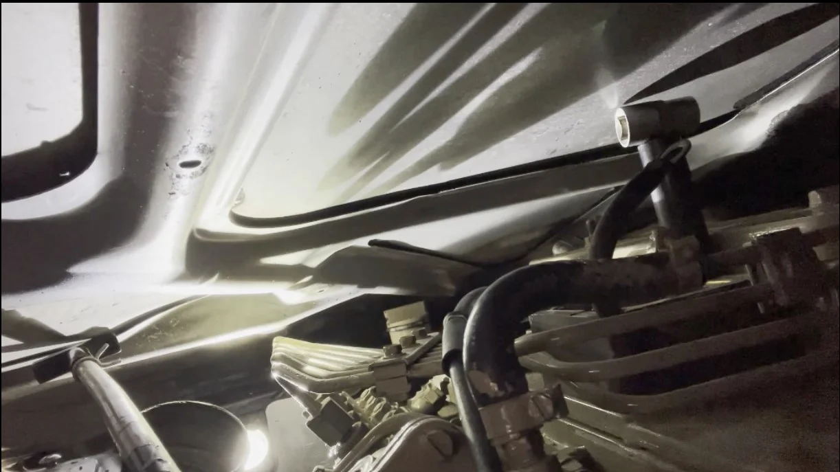

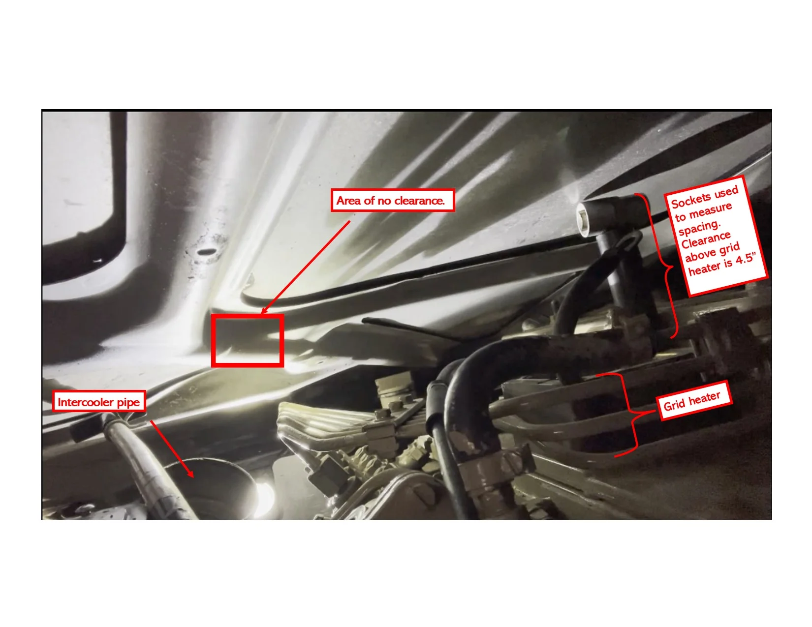

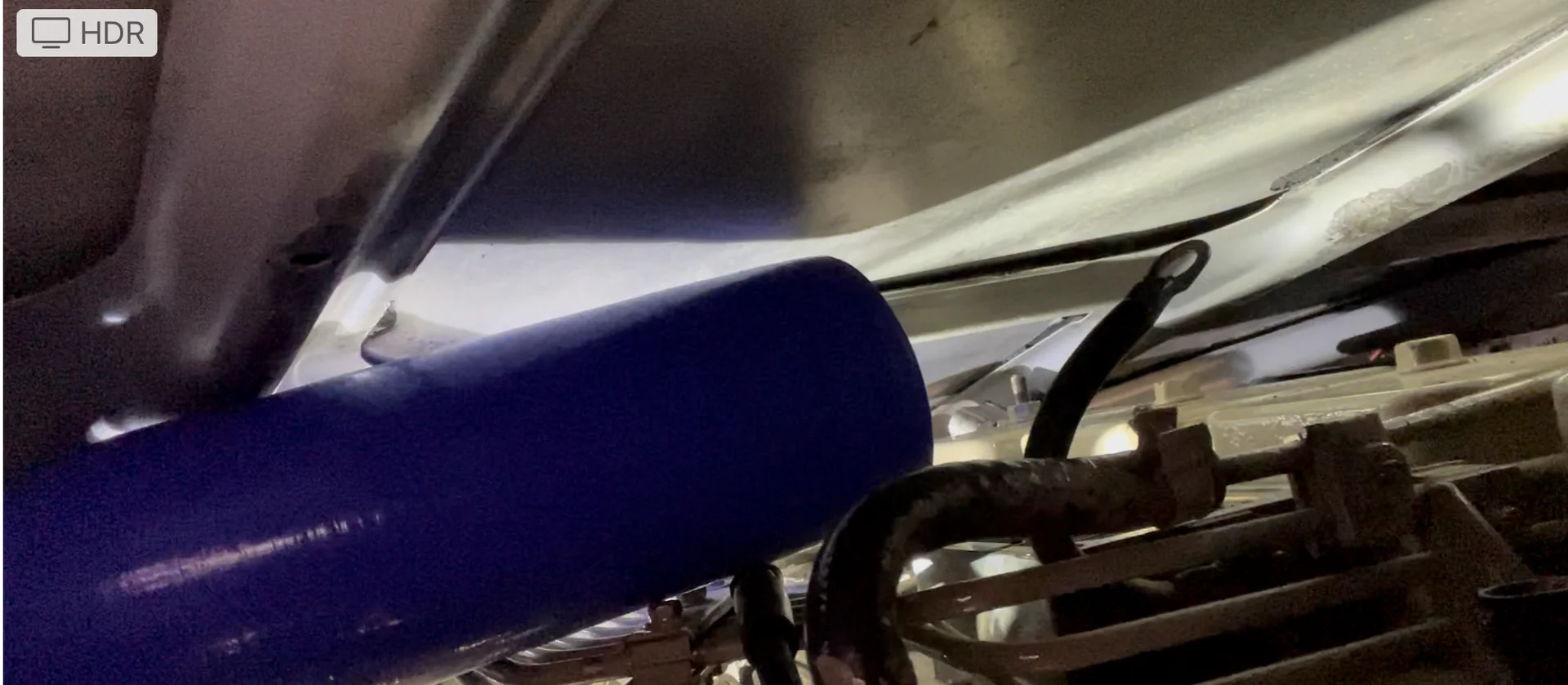

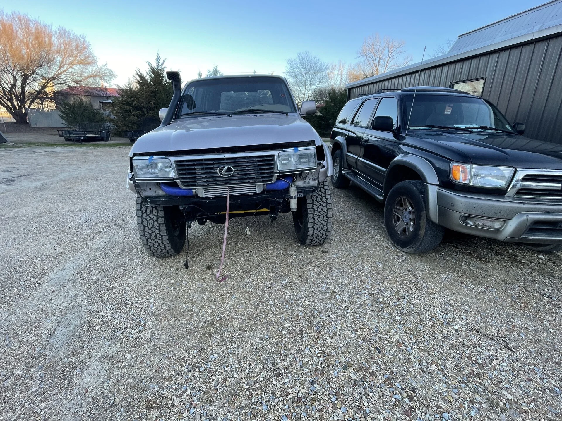

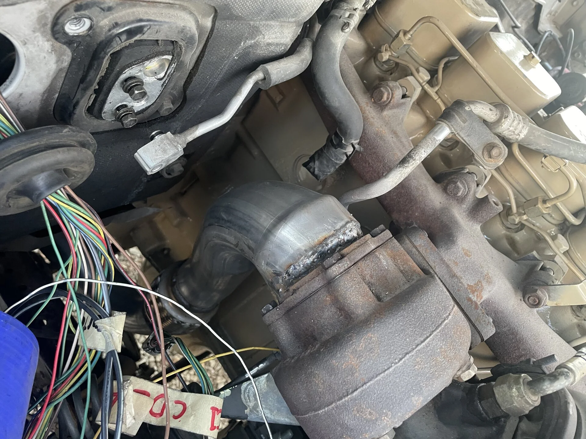

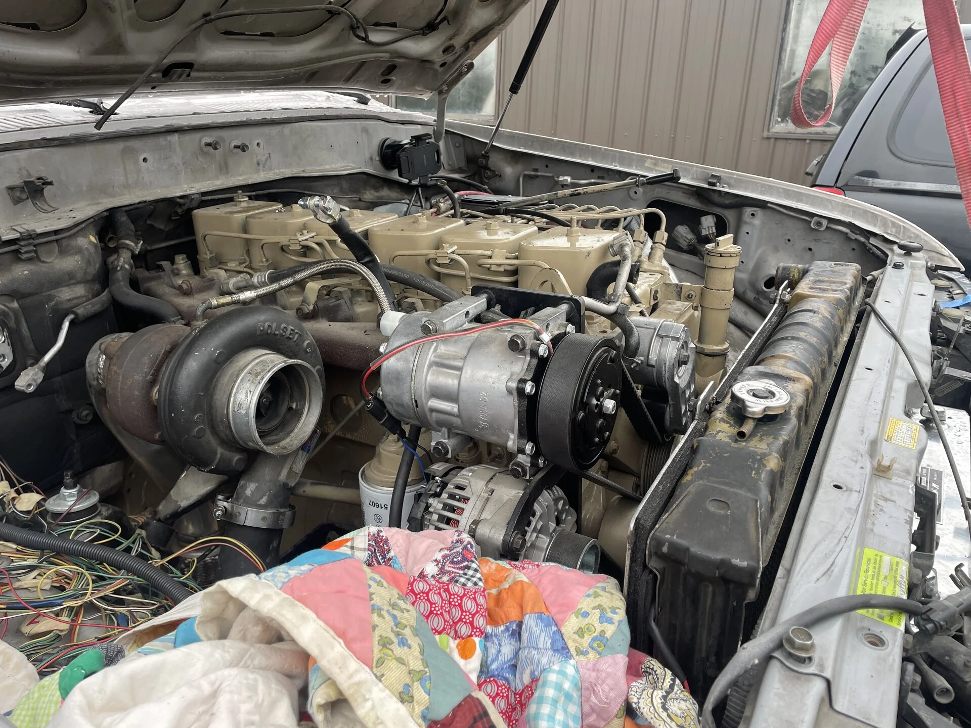

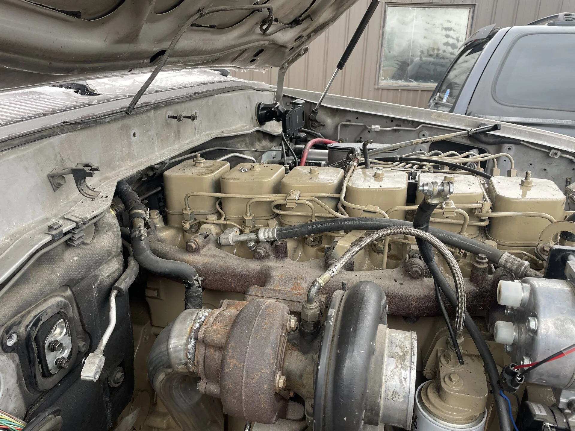

Exhaust is in and so is the intercooler. Right now the hood isn’t clearing the intake on the motor. Right now I’m trying to decide on what to do. Im thinking about making a new nipple that bolts to the grid heater and then using the same blue silicon tubing on the intercooler to connect with. I’m thinking the hood may flatten it somewhat but may still allow air flow.
Next option is to fabricate another intake that is wider but flatter.
It’s slowly getting there.
Nice work!

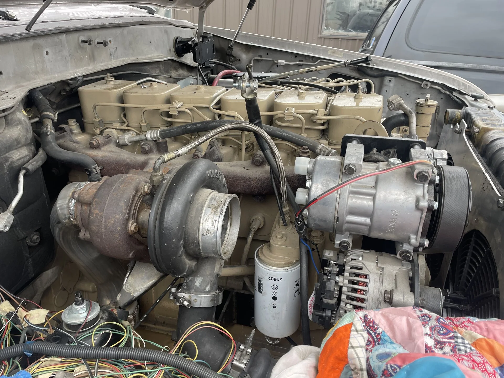

Any zoomed-out photos of how the engine mounts in the bay with the Adventure Vehicles NW engine mounts? Would also love to see radiator fan clearance on your e-fan setup.
Keep up the good work!
I had the same problem on mine and did a few different things for more clearance but ended up adding a 1/2" body lift
I’ve thought about lowering my center diff. Right now, I have a dodge transmission mount under the center diff. It adds about 2inches of height. I may remove it and see what happens.
Nice work!
I will be happy to get you some photos tomorrow. I made some videos today of the hood closing with the factory intake and then without the intake. I have 4.5" of clearance above the grid heater. I plan to weld up a 90 degree nipple off the grid heater and snake a 3" silicon hose behind the injectors. I'll make a test piece with some foam before doing anything.

Do you think there is enough space to run the Dodge mechanical fan with the engine in its current position?
It's very tight up front. I would need a modified fan bracket and would need to modify the radiator position. Some have also custom built their mechanical fan as well. With the current position, the driveshafts and the center diff fits well with not modification. This is sacrificing some room up front. If you went with a body lift, and could more easily set the motor further back and gain some room up front. That may cause you to have to modify the center diff crossmember and driveshafts.
I spoke with @mattimooseprime about his setup and took his recommendations. He said his motor runs pretty cool and that one fan may be adequate. Maybe he can also give some insight.... I plan to test out both and then test them separately and see how they perform. I may be able to keep one disconnected and have for a backup.
