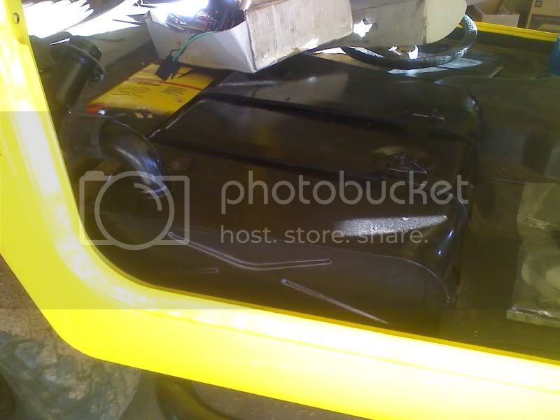

beware the original fuel tank. they typically rust out, and at the MINIMUM should be taken to a radiator shop and powersprayed cleaned out. I had my carb rebuilt FIVE times before i did that! Yeah. That sounds like it sucks, mostly because IT DOES SUCK!!

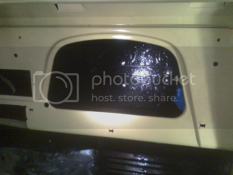

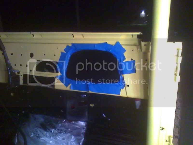

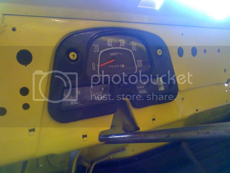

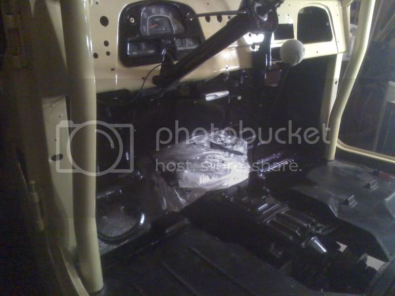

LOOKING A LIL SHADY UNDER DASH HIT WITH POR15 SHOULDNT GET MUCH SUN
THIS SHOULD BE OK FOR NOW WITH THE CLUSTER

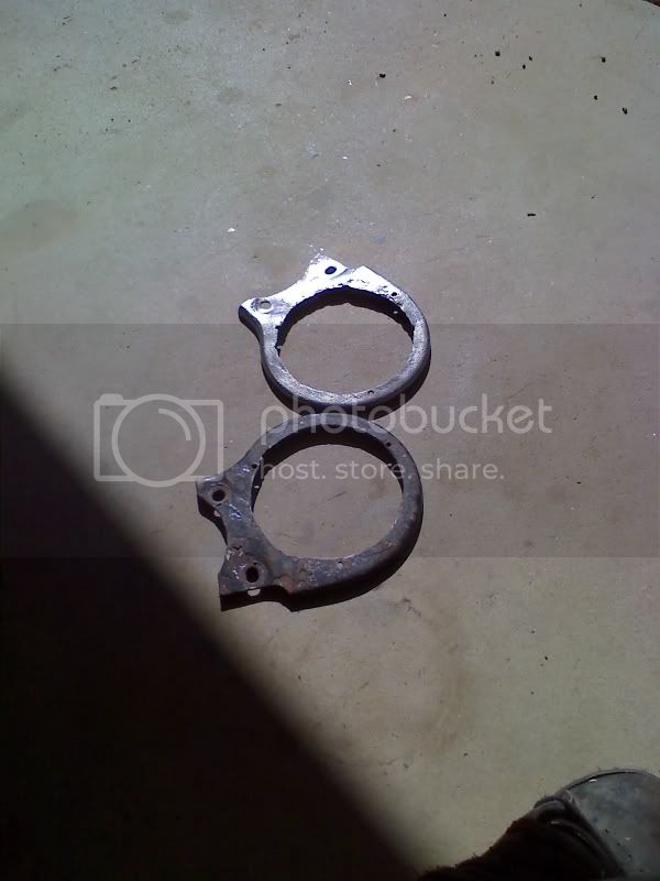

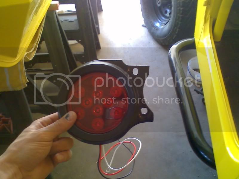

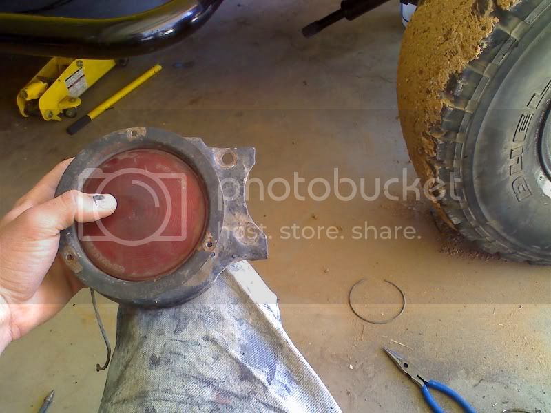

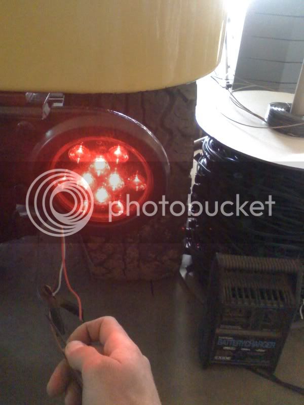

MODING THE LIGHT TO FIT THESE LED I PICKED UP AT HARBOR FOR 16 BUCKS
oh and with the tank was about the only thing i didnt sand blast... i was able to eliminate all rust with a wire wheel there was minor pocketing but after i ran a three rince cycle with the inside then painted i feel with a lil luck it just might work haha:steer:
no no i mean on the INSIDE it's rusty. a LITTLE flake will screw things up quite nicely in your newly rebuilt carb. Did i mention rebuilding carbs 5 times by reputable people and shops sucks?
nice job, you are putting a hell of a lot of sweat into the rig instead of money, I really like the tail light mod, I might have to steal that idea. Oh and peiserg, he said he did a three rinse cycle on the inside of the fuel tank, so hopefully he wont need to worry about rust getting in his carb, me myself I just run three fuel filters.....just kidding, I should cause I keep getting rust in my carb...ha

ha. laugh (if you must!) but i DO run two filters, after all the frustrations of the carb. It helped, but not much.. i guess if the FIRST filter isn't catching the particles because they are too small, the SECOND filter isn't going to catch them either.
I distinctly recall the mechanic, 2 weeks after a rebuild... telling me i need another one... me questioning his expertise, and he in turn turning the carb on it's side, and knocking out sediment from the tank right in front of me! doh!

the tips are totally needed and appreciated is there a good way to check the inside of the tank just to make sure? when i ran some solvent with a lil gas even the first time after letting sit and shaking the tank all around i pored it into a bucket first to check and looked clean is there a better way?

ya im pleased with the tail lights i just know ill fab a new bumper at some point but for now was worth doin for the price... i did have 2 trimm a lil bigger hole with the origanal brackets im sure you could figure it out but let me know if u need more pix or info:cheers:

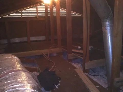

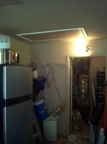

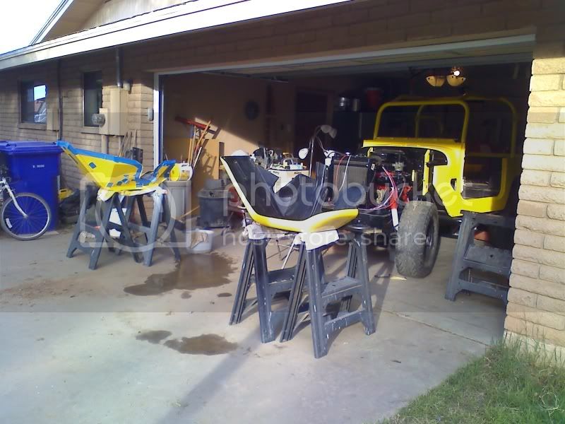

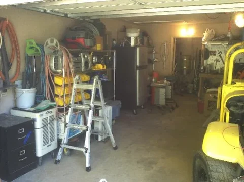

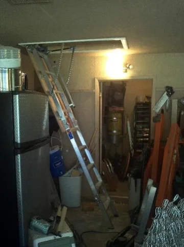

I'M BACK! and with a little luck I will finish the cruiser up this time once and for all! I'm excited motivated and saved up a lil cash for the parts I need! I just spent the last 2 weeks un burying the cruiser in what they call a garage but looked more like a dump! Lol first I had to store some stuff somewhere so I installed a attic ladder

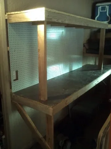

and built some shelves up there
then built some shelves in the garage

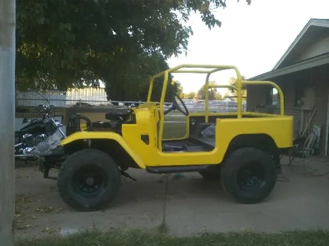

and after getting some bakers racks and countless I mean COUNTLESS hours of organizing setting up throwing away boxing cleaning finally got down to my cruiser was able to roll her out and give her a quick spit shine more like dusting the thing for more work:)
I'm so excited to get back into the cruiser and the fact I can walk around in there, know where everything is given it's all organized now!
