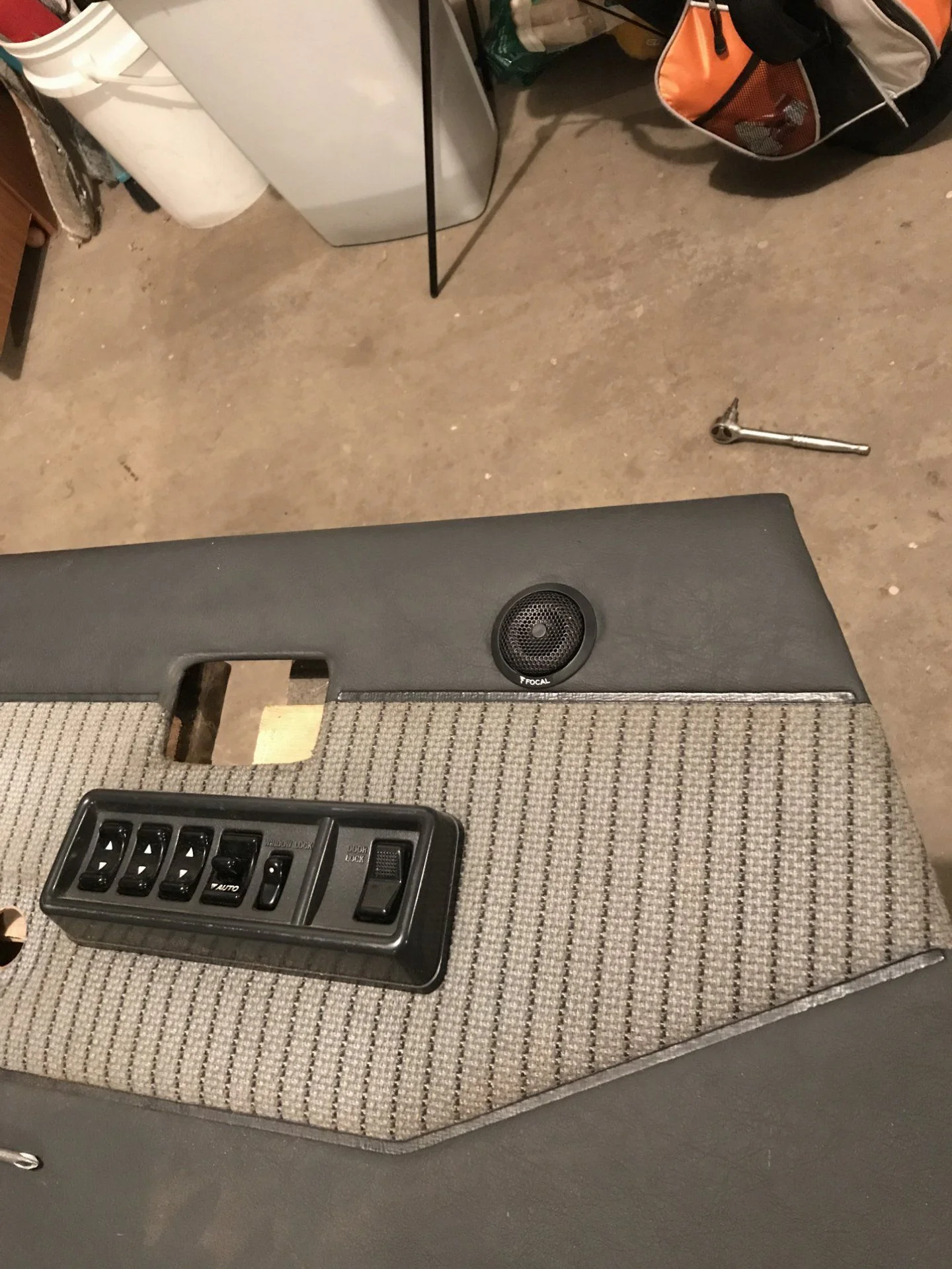

5 1/4 are the right size. the toyota ones are mounted on three holes though not 4 like most aftermarket speakers. i had to drill a couple new holes to get a set of sony speakers in there. in the end they sounded like crap anyway so i put some 6.5 instead and modified my door pannels. i did some component speakers and put the tweeters up high on the door. i too am not 16 looking for bass but i do like good sound and these are WAY better sound than the 5 1/4 can give. i wish i could have kept the factory look but function beat out form in my case
you got any pics of the door/mounting mods?
appreciate that! last bit- and I'm sure it could be useful even here- does that interfere with the window at all?
these don't hit the window because i put a 1/4 thick ring between the speaker and door card. otherwise they would have hit. these are focal flax series to be specific. they have a pretty big magnet but sound absolutely terrific because of it.
i also took a stock speaker cover into a auto paint supply store and had them custom match a spray can. i painted all the speaker grills and the rings so they match my interior quite well
