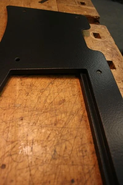

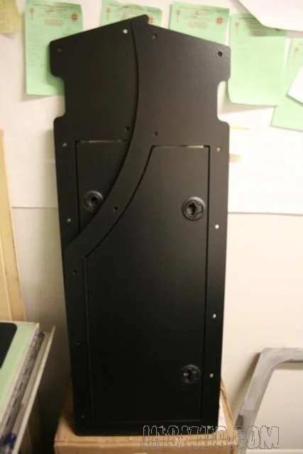

I have been working on prototyping the 1/4 panel storage and I finally have a little bit of something to show for it.
I will be up and running with these soon

I know that I want to make a few more design changes, you see how you can see air around the panel? If the lower 1/4 panels are not sealed up, a lot of dust can get thrown up into them. On my truck this was not a concern because I know they are sealed, but I would rather not have my panels spewing dust into peoples trucks, so that needs a bit of attention.
The ones pictured are for a striped down truck with no trim, rear shoulder belts, speakers, vapor holder, washer bag or wheel well trim. For simplicities sake I made them just like mine.
So I don't really know, you are close to the top though and since these can be made alongside the tailgates (they dont take the same jigs) I'll bet we can get you a set next month. (along with one or two others, I will get a list and another thread going soon for those)
