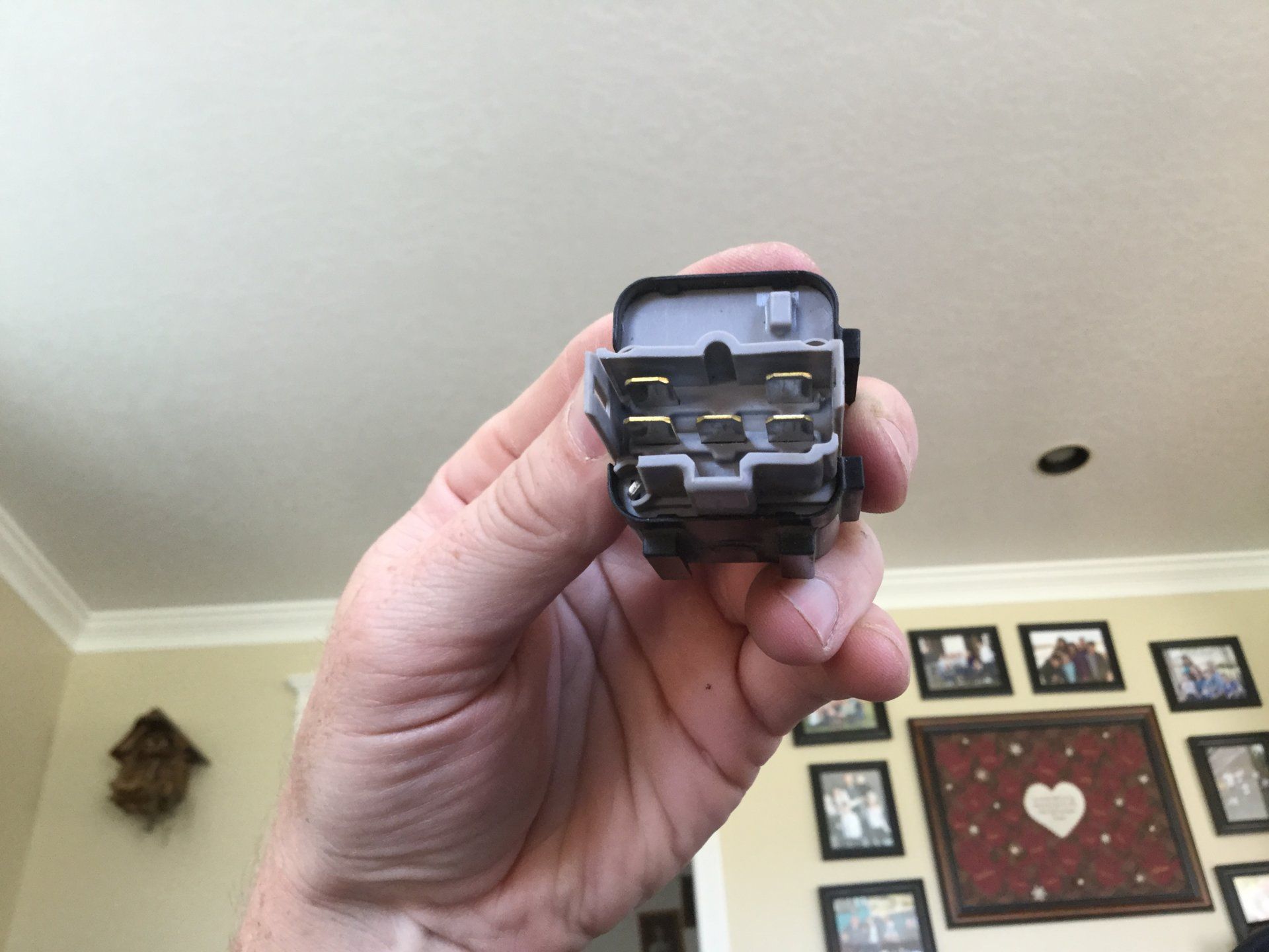

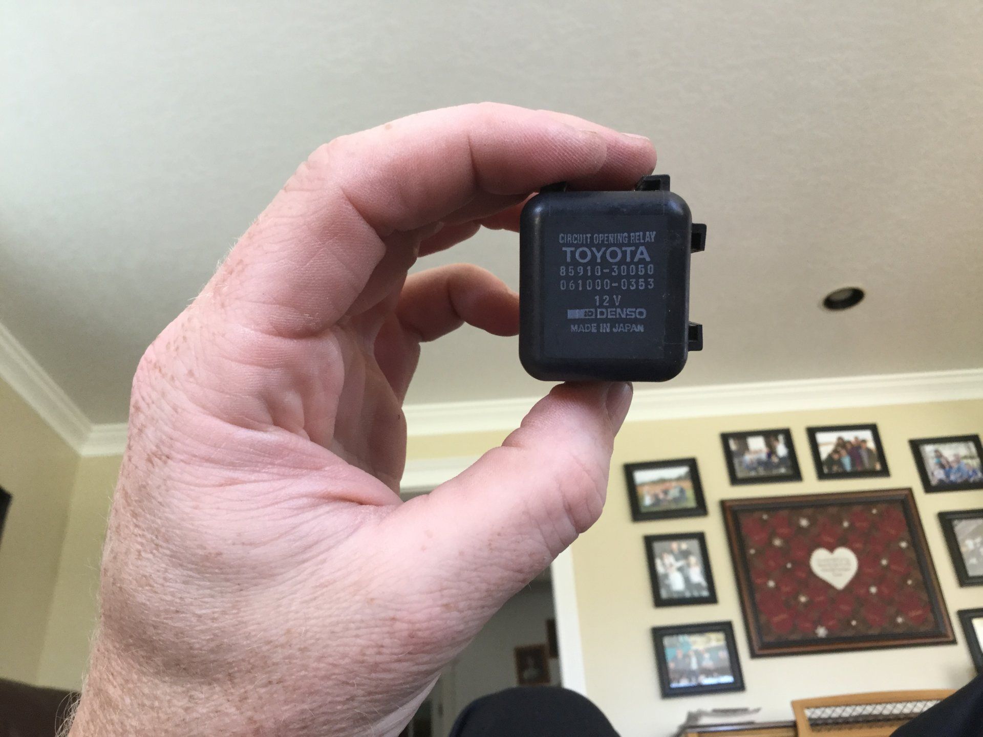

Anyone have instructions for testing this 5 pin openings relay? I’m having starter problems with my 92 LC, and I can hear this guy clicking down by my feet when I try to start. I’ve tested all my grounds, fusible links, starter, and battery are new. I’ve also unplugged my aftermarket security system.

ok fella's, I'm a dumbass, my new battery terminals were reversed, so in the process of swapping the wiring, I connected the starter wire to the negative terminal of the battery. Thanks for the help regardless
