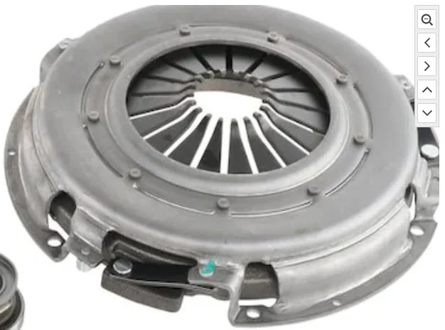

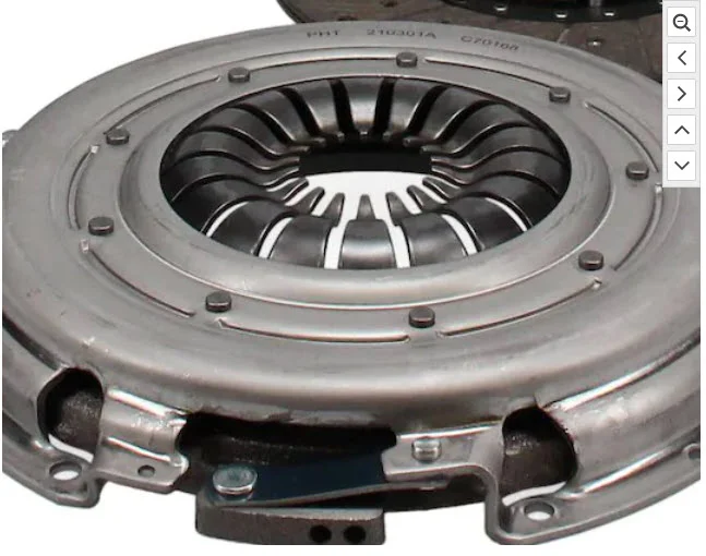

Can anyone help me figure out what clutch kit I need for my build? I rebuilt a 5.7 Vortec engine from a '99 Yukon, and ordered a rebuilt NV4500 to mate to it, and even though I've hit some snags along the way, the clutch pack is driving me nuts
. I installed a 168 tooth flywheel, a Powertorque K70149-01 clutch kit, and the AA Bellhousing 712577, but the throwout bearing that came with the AA kit barely touches the diaphragm when I press the clutch pedal, and because there isn't any tension on the fork, from the pressure plate finger springs, the fork comes close to coming off the pivot bolt when I depress the clutch pedal. I noticed that where many pressure plates have raised "finger" springs that extend outwards towards the tranny, the one I have goes inwards. Is this something easily fixable just by replacing the pressure plate with one where the springs extend outwards, or is there more I need to replace? Thanks in advance, and Happy New Year.
