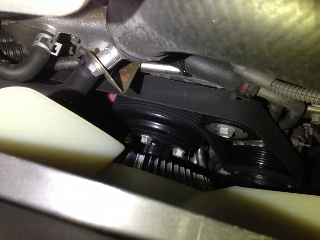

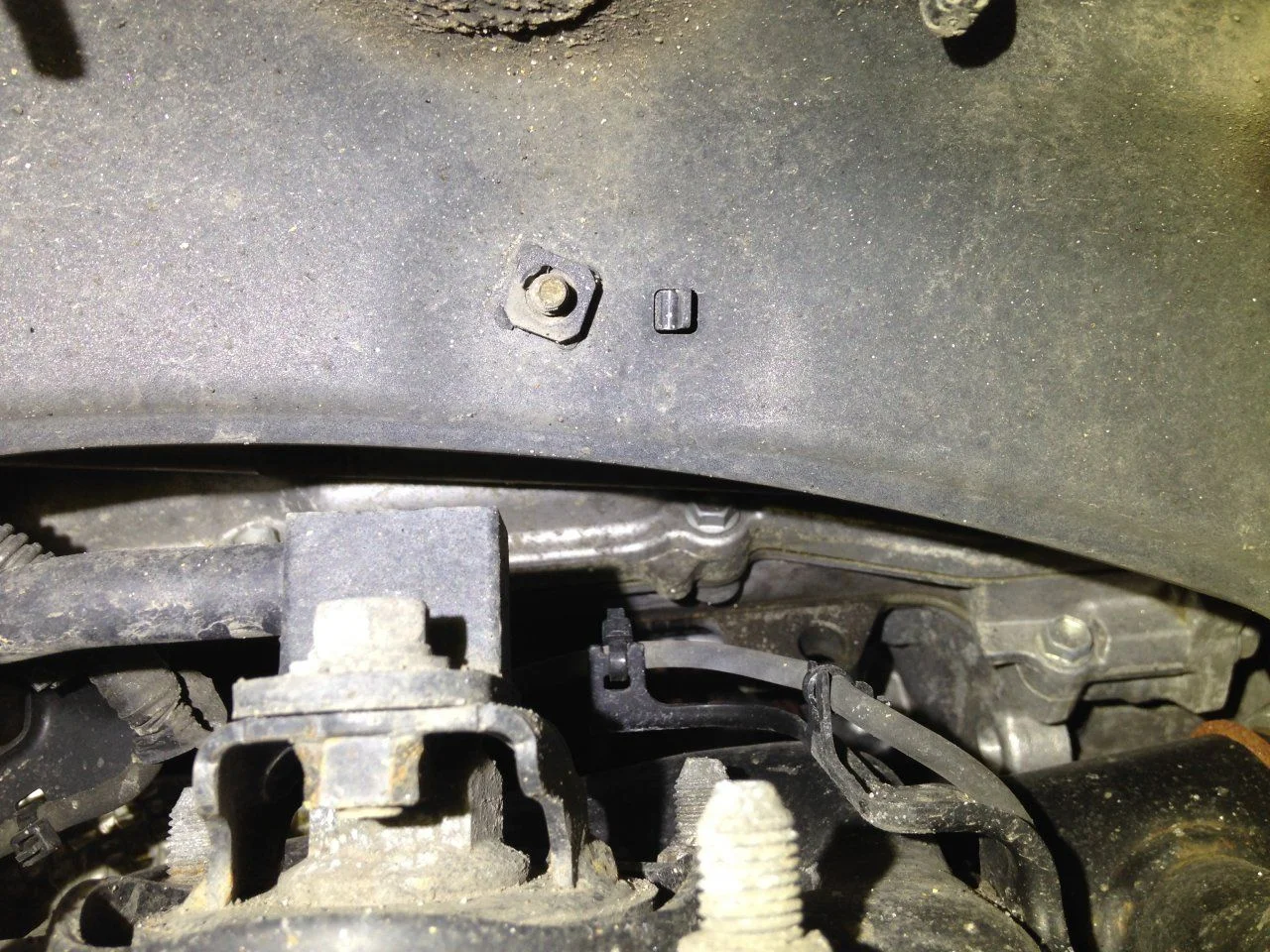

For reference, this is what mine looked like. Pic 1) leaking water pump - view from top of engine bay. Pic) leaking water pump - view from bottom. Pic 3) valve cover gasket leak - view from driver side wheel well above the top of the tire.
