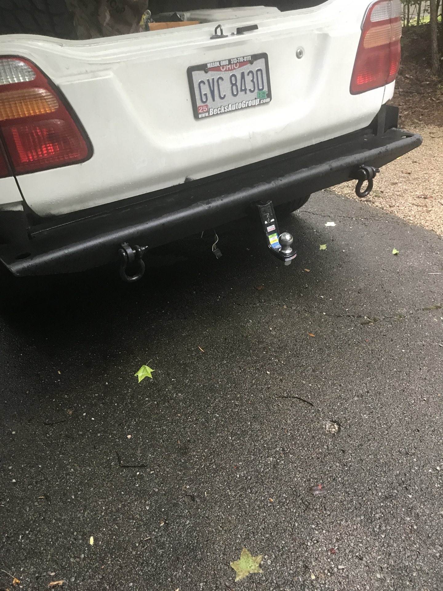

Very nice! I already have a steel rear bumper, but not as nice as that one. Mine didn't negate the frame cross member, so the integrated hitch mount is lower than I'd like it. I think I'm going to take mine to a fab shop and have it modified, but I'm loving that design. If I pick up another 100 series in the future, that'll be the bumper for me.
I just finished building the same bumper a week ago, was under the gun with an upcoming camping trip and did not do a thread. Nice job! The only thing I changed up with the build was adding some corner gussets behind the cross member as well.
