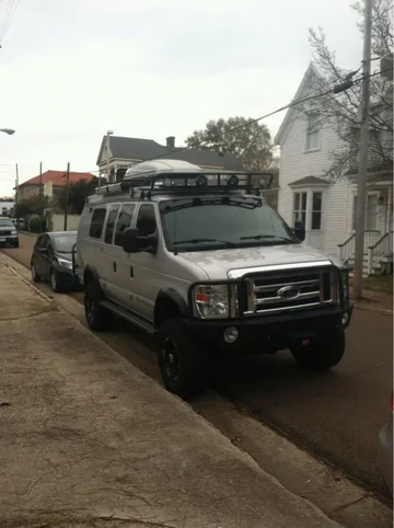

Saw this on the set of Get On Up
In natchez

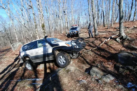

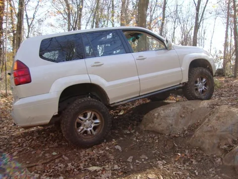

My friends at ACC did a GX recently for Dan Kunz. They ditched the airbags, stuck FJC upper spring buckets and fabbed up bottom brackets on the rear axle. Added Ironman (Oz Prado spec) springs/shocks all around. Ironman front bumper and custom rear plate bumper. Turned out pretty sweet.
lift, sliders and skids
with armor, plastic panels/fenders removed, holes patched and body lined.
