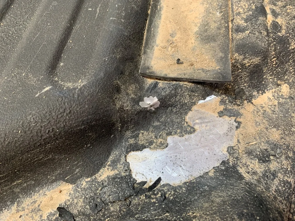

In 18 months, I'm on my 4th gas tank from Lexus, always cracks in the same spot. The last one lasted 2 weeks before it started to leak. I've looked through several post in here, and I know it has been an issue with others. Has anyone every came up with a resolution? Is it just poor craftmanship on these tanks? Are the OEM tanks bigger and the straps are crushing the tank? Should I go back to a used tank from the 97 era?
Thanks for the help in advance.

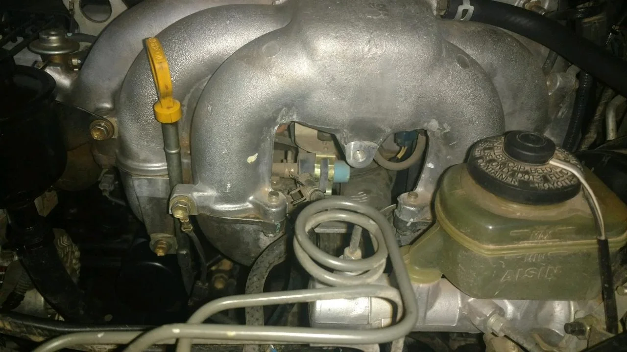

After the original tank flexing and breaking and a new OEM being installed and breaking, Toyota took a close look at the pressurization controls and found a $2.50 vent / vacuum solenoid mounted at the upper intake manifold which was faulty, preventing the release of pressure in the fuel tank. The FSM refers to this part as the VCV Valve for Evap (vs. EGR), and theres a one-way valve upstream from intake manifold vacuum. This is most easily located by tracking the hoses from your Charcoal Canister to the valve under the intake manifold.
Once replaced, the tank pressurization was no longer an issue with big venting in or out when removing the gas cap, and the tank has not failed. Sorry I don't have a part number for you, I went out and looked through my receipts and couldn't find it. Good luck,

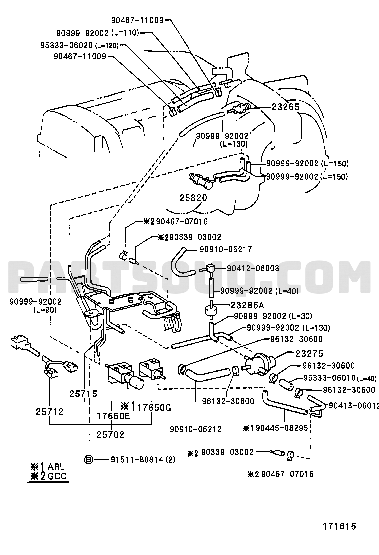

Here's another diagram that may be useful:

Throughout the diagnostic and the dealer putting in their own tank and having it fail shortly thereafter (within a week), I recall replacing these parts;
I also remember the Tech telling me it ended up being the cheapest part of them all that actually fixed the pressure problem, so it may be the one-way valve that was to blame. Regardless, with fuel tanks in short supply - as I was told at the time - I felt it was cost effective to pay for everything to be refreshed, and be able to sleep at night because my LandCruiser sits in the garage. Next to the gas water heater...

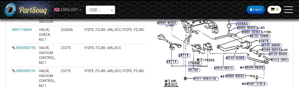

The vacuum control valve 90925-03192 may be it but I doubt that part was ever $2.50 though so it may have been some other valve @LongDuck was referring to. I would guess the FSM has a test to see if the VCV for evapl is working.

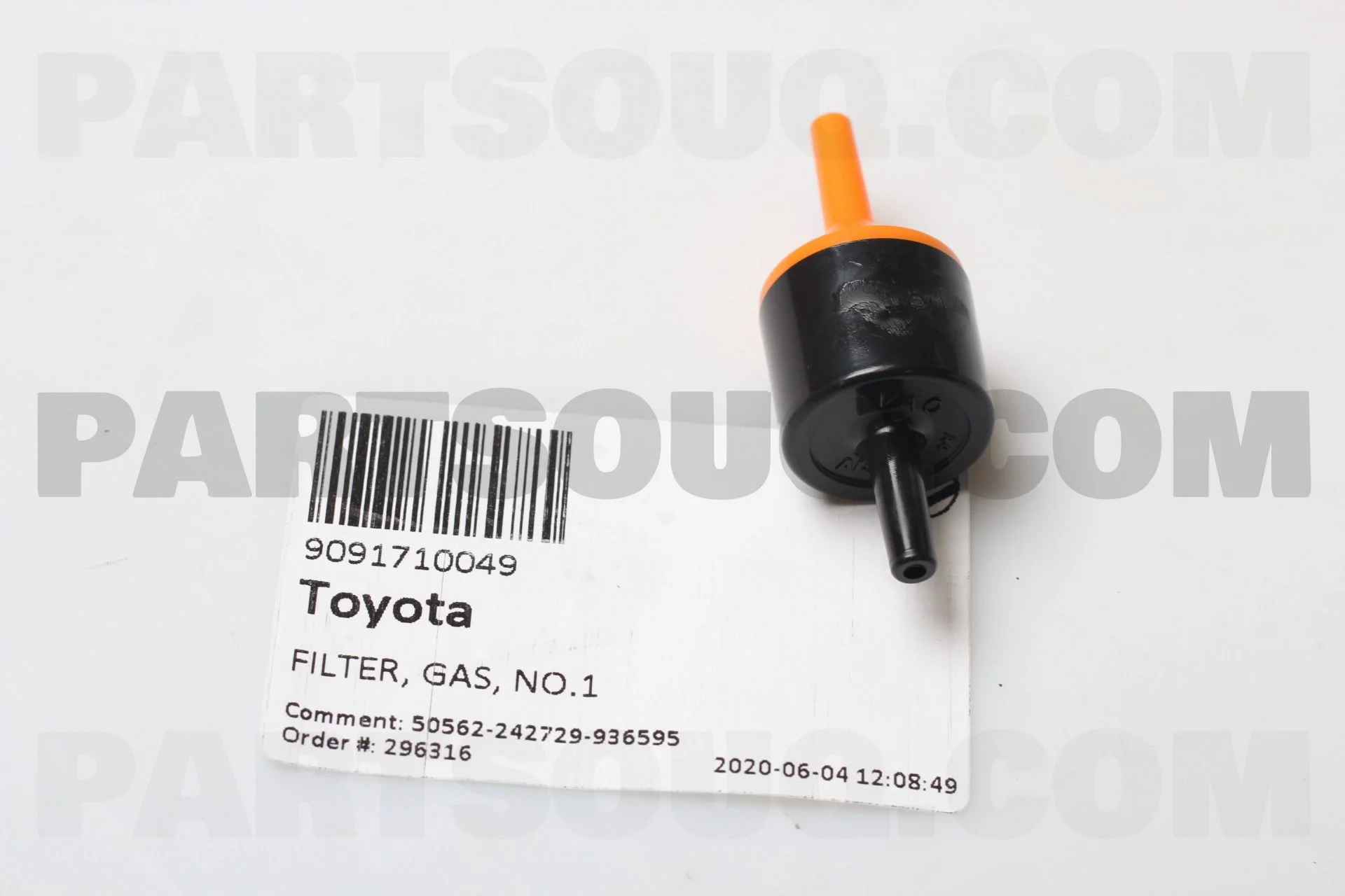

The part downstream or upstream just next the you listed costs 3.95 on partsouq called valve check no.1 9091710049 (labled check valve for evap in the FSM) that looks like a one way valve that only costs 3.95 on partsouq sounds more like it. On partsouq once you click on it is labled a fuel filter but it looks a lot more like a check valve though that you listed above and may be the actual part. For that price it might be reasonable to replace it.
23285A in the partsouq pic
It's a small plastic, possibly possibly oragne in color, check valve in the vacumm tubing.

Sorry to take this a bit off topic - but I'm interested in the part 90917-10049. Could anyone confirm if it's a filter, or a one-way valve?
I'm hoping to use it as a filter on the idle-up vacuum circuit on a diesel 60, but it needs to flow air both ways.
Thanks
