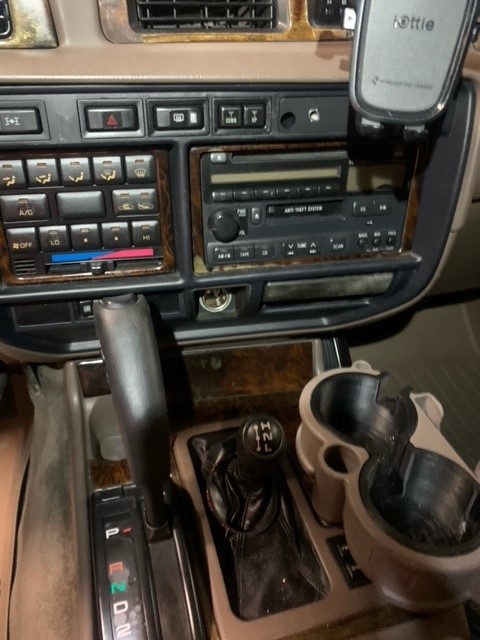

Hello everyone,
Hoping to contribute a bit here. I gain a lot of knowledge and rarely post from the forum, so here goes.
A lot of people complaint about the 80 series shifter. If you're tall, like me, your knee hits the lock-out button and it's uncomfortable to keep your knee in an akward position. The shifter is dated and awkward. There are some comments about using a third gen 4runner shifter floating around out there, but the closest thing to a write up was lacking and completely different than my experience. Almost the entire thing ended up being sorted out with critical thinking. I will say, it was not hard. It took more time in thought than actual time working. Its certainly not for the light of heart, being more than a 1/8” off on any cut will ruin both assemblies and you wont be able to go back to your oem set up once you start.
For those interested in doing this, you want a 1997 4x4 4runner shifter. It has the correct OD button, the 99+ is def wrong (learned that… and had to order a 97 overdriver button from toyota). Im not sure what button 98 got. The entire 97 assembly may fit better, and require less work. I simply dont know, i used a 99+.
100% worth it. My knee no longer contacts the shifter button.

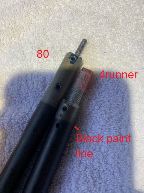

  7. compare the rod from the 80 to the 4runner (pic attached). Youll see the 80 rod is longer and needs to be cut down. You could probably make this work with it being taller, but the shifter would contact your dash because the 4runner shifter goes forward. Mine is about an inch from contacting the dash. You want to compare the rods and where they mount, like a fulcrum point. I noticed on mine the black paint stopped at exactly where the rods were lined up based off the bottom leverage point. Yours may not. In the pic i added, you can see my 80 rod is cut. See the black paint lines?

  9. 4runner rod has 2 set screws for its knob, closer together. The 80 is further apart. Mark, drill and tap the 80 rod to match the 4runner. I dont remember the size, sorry.
  10. cut your 80 rod to length, again mine ended up being able to be aligned off the paint transition (see line I drew on the pic).

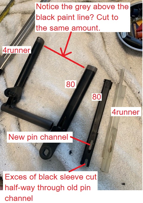

  12. Pay attention. The internal guts on these works differently, this means the plastic sleeves cannot be swapped. There is a channel for the lock out pin to travel, that pin pin you pushed out, and you will make a new one in the black plastic sleeve of your 80 guts. Insert the black sleeve into the 80 rod and mark where the new channel should go. I put 2 pilot holes at each end and 2 in the center and used a drill to make the new channel. With the drill, make a nice groove and file it smooth. Patience goes a long way here.
  13. Once you're happy with with the new channel for the pin, reinsert it into your cut black sleeve and cut the part off the black plastic sleeve that sticks out below the assembly. You can see the black plastic sleeve in the pic i attached, my cut was about half way through the old pin channel and the new channel is there.
  14. Put your metal rod in the sleeve and put them both into the cut down 80 shift rod. You'll see your threaded metal rod that is is too long. You will need to cut it and then use a die to thread it. Start longer than you think it should be, you can cut more. Make small cuts. You will revisit this step. If you cut too much, you're going to need a stiff drink

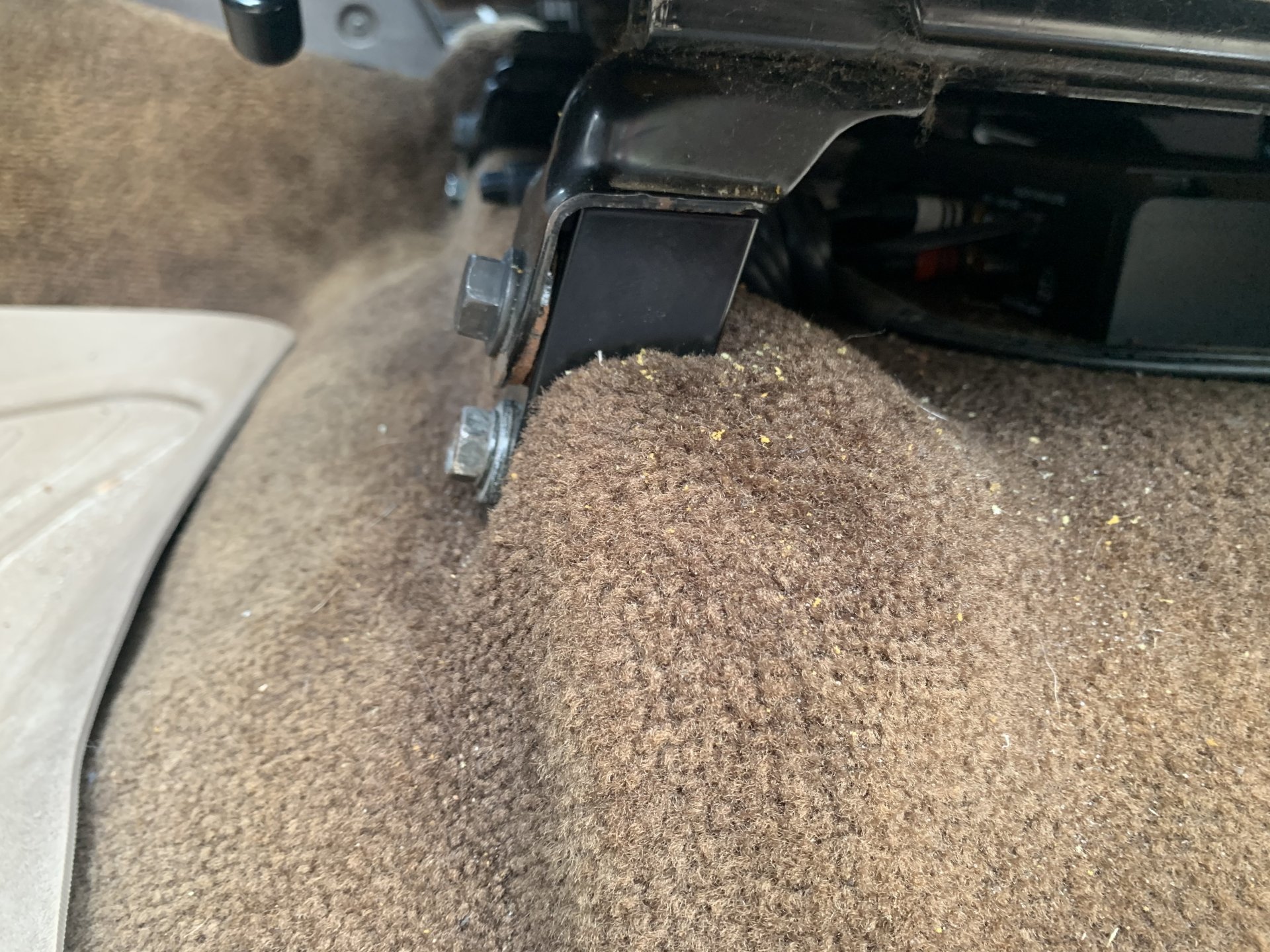

If you are still using factory seats look into raising the front mounting points about a inch or so. Adds support under the thighs. Tremendous increase in comfort for me.
