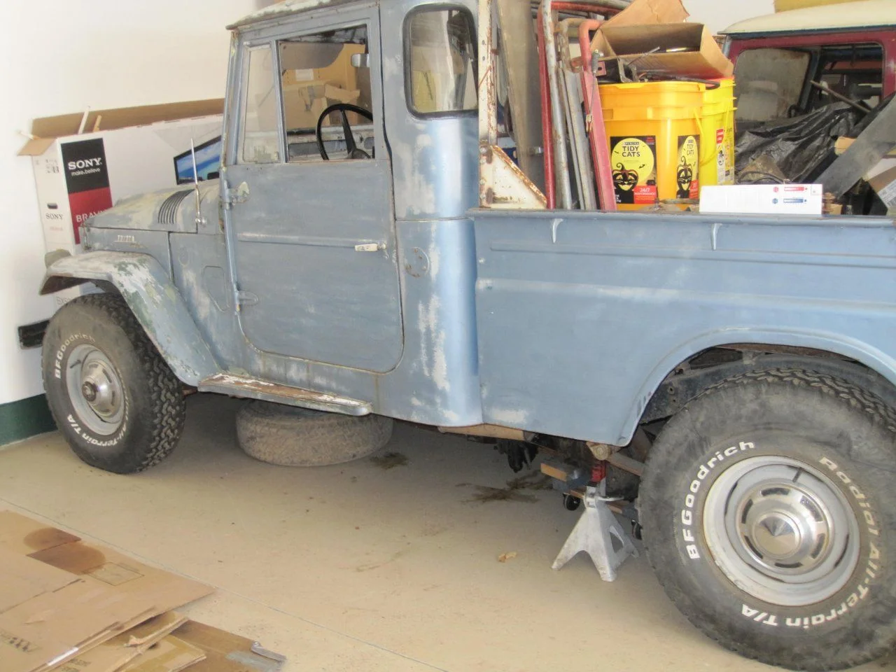

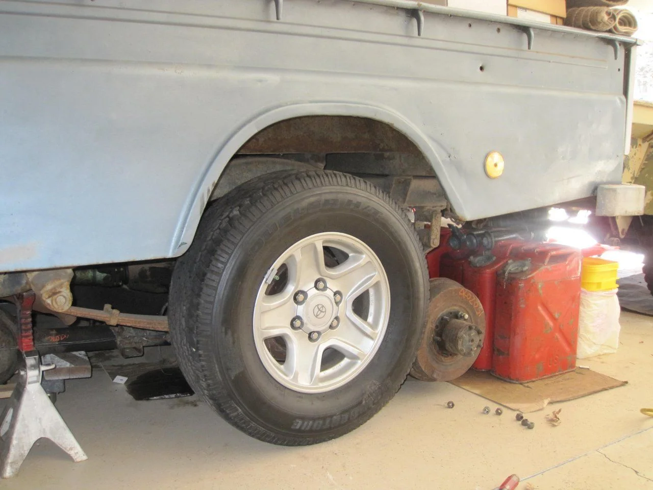

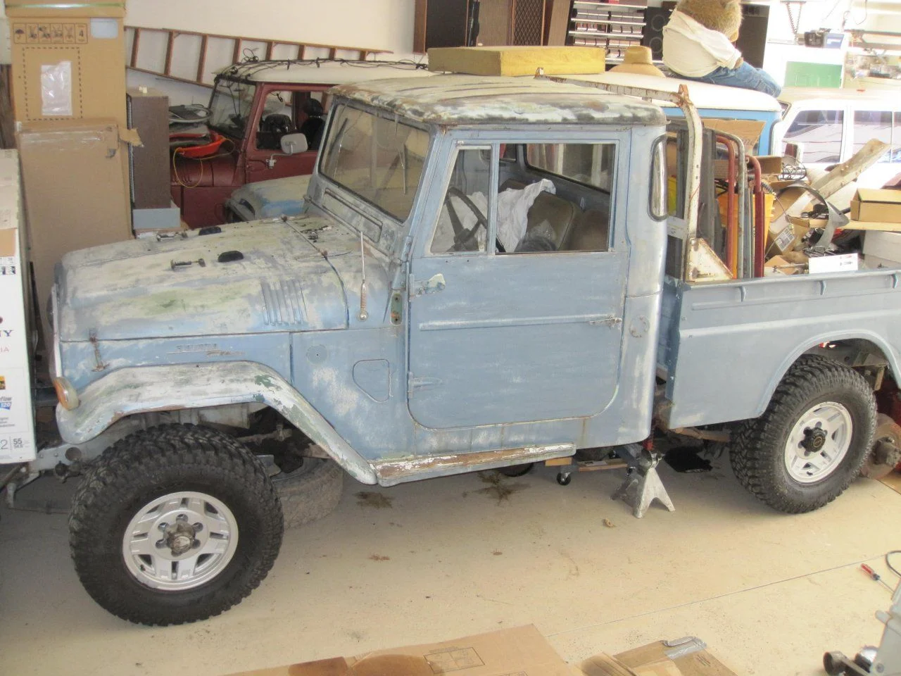

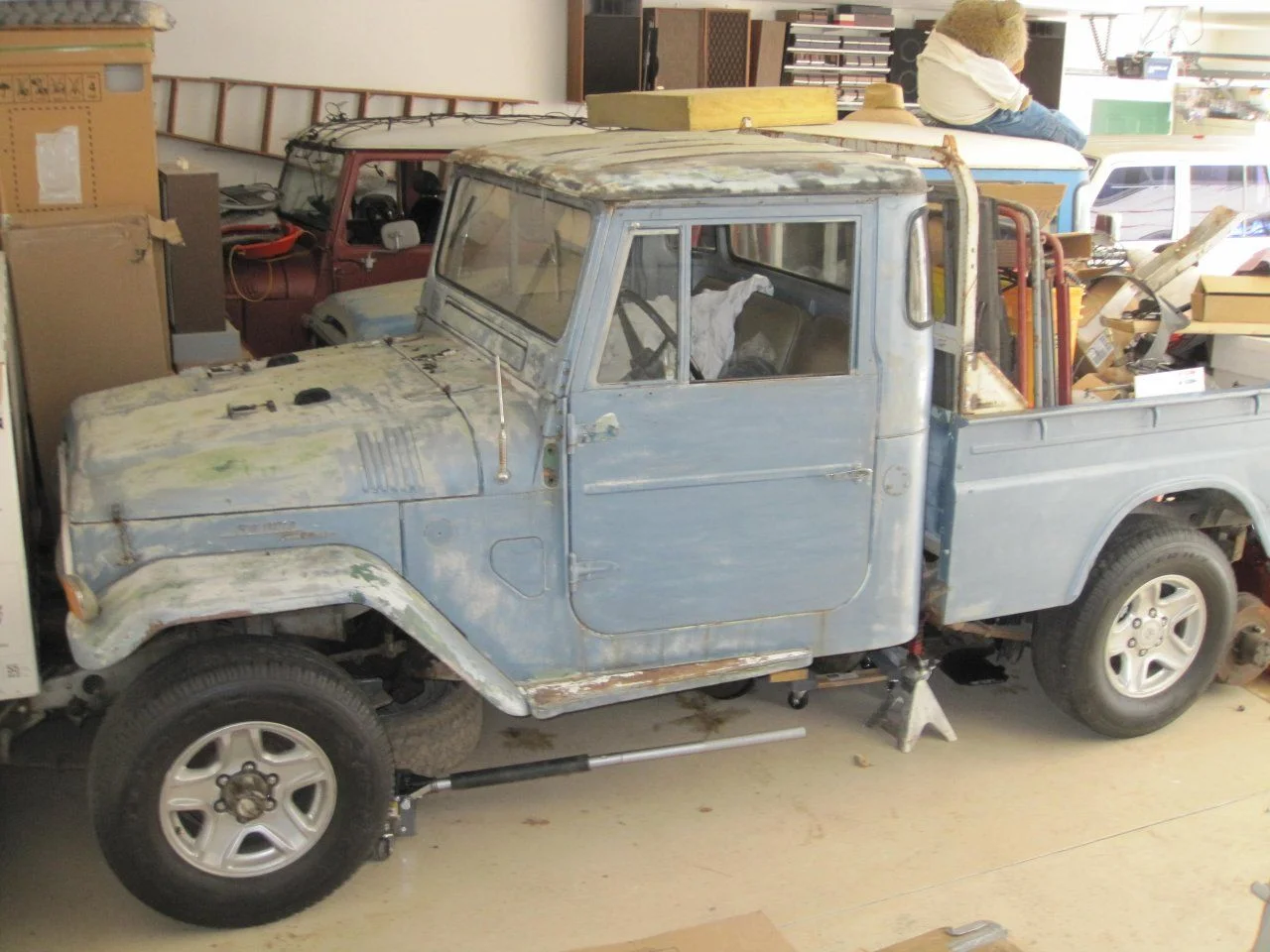

Finally got around to trying some 16" 4Runner rims off a third generation. 65 with stock axles, even with a 1/4" wheel spacer the rim hit the tie rod end. Same rim on a 76 disc brake axle with the 1/4" spacer it barely clears. Might hit a balancing weight.

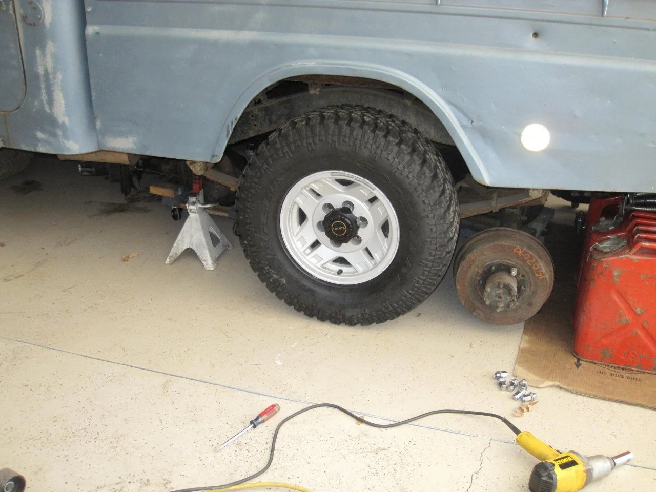

While only 15" I prefer the earlier second generation rim. I have these in three different offsets. The 80 series rim uses a tapered lug nut while mini truck/4Runner use the shank style which uses more thread with a wheel spacer.
I really like the five spoke on my 99 4Runner but think the standard third generation aluminum rim might look better on a 4X series. Those came in both 15" and 16".
