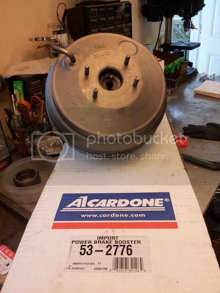

could you please post the Toyota number from the four runners brake booster .
Sure, it was Cardone 53-2776. It's for a 1995 4runner WITHOUT antilock brakes.

I have ordered the booster and it fit perfectly in my hj61.
The performance is way better than before and it feels much safer now :bounce:
