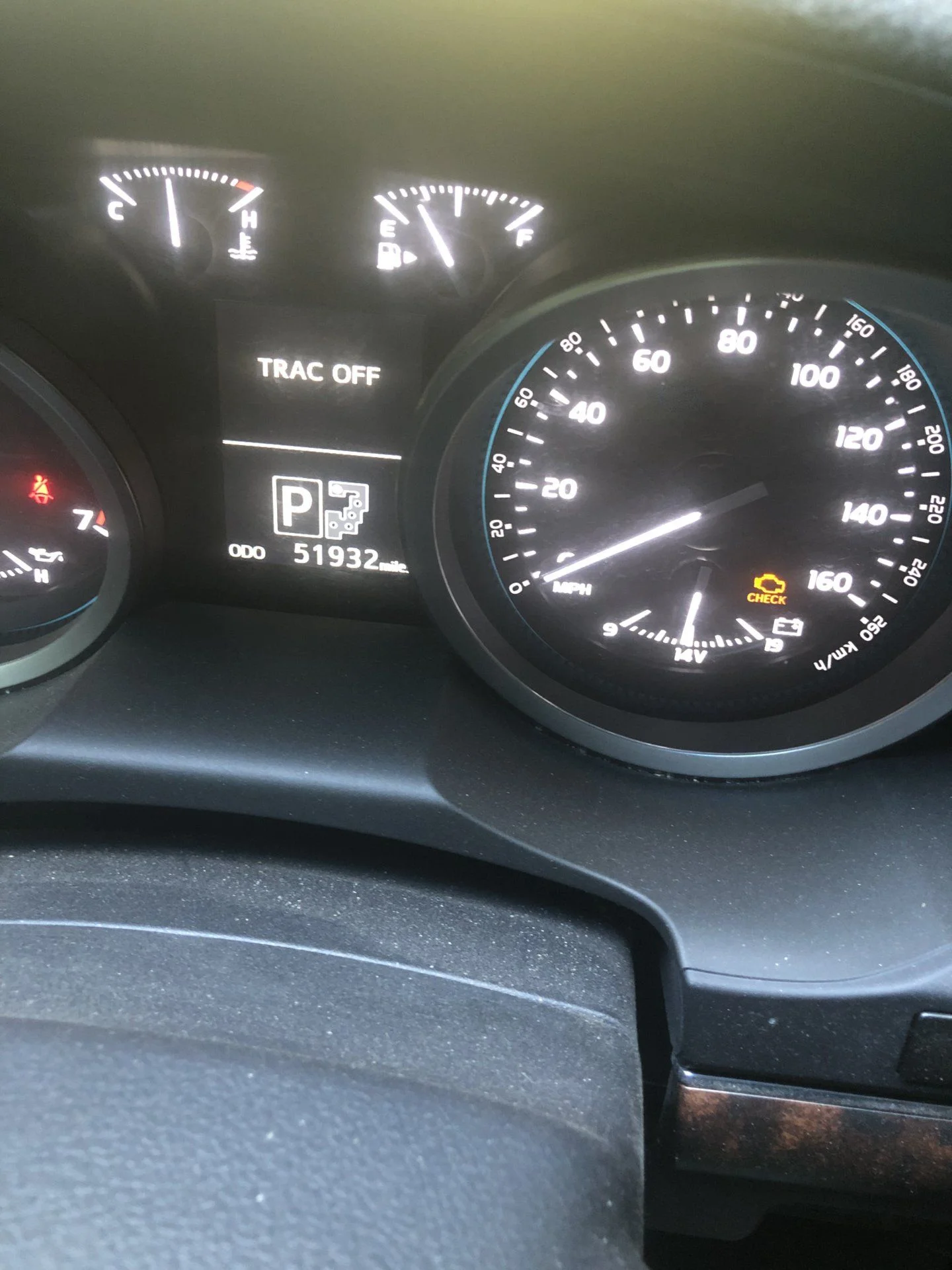

4lo light flashing,check engine light and Trac off on display.Took pic
Nov 22, 2005
100
872
Santa Cruz Mountains,CA. TLCA#7702
Hello all,I apologize for not searching but wife’s 2014 all stock LC had the lights on as described.She drove it 15 miles or so.Now it’s home please advise looked at owners manual didn’t see the 4lo flashing light on there but did see the trac off.Tried to shift into 4 low and wouldn’t engage.

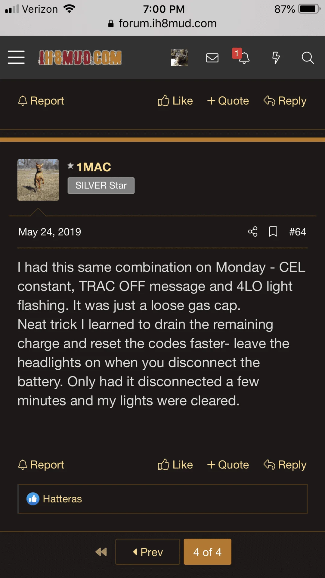

Might just have to do this! Just read another thread about disconnecting battery.This guy was saying to leave the lights on?
you can man, or just let it sit about 5 minutes
Thank you all for the help! Just got back in from disconnecting battery with the lights on.Waited a few minutes hooked it back up and it was weird on the 1st push of the button truck didn’t start.Maybe I didn’t hold it down enough but it started right up after and No lights on it’s all cleared! Now just have to deal with this damm maintenance required light ha don’t have to search on this.And the horrible daytime running lights are up next.Going to try and turn them off on the screen menu a bit off topic but I think they totally outdate the truck.
