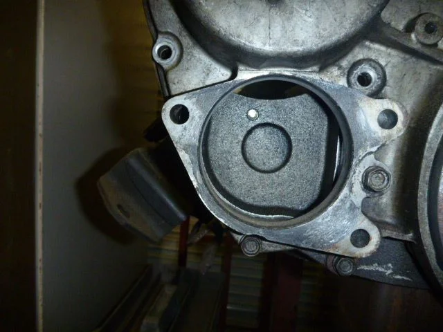

I just checked my spare 4BD2 engine to see if you could rotate the PS pump...NO!
First, there are only 3 bolts with odd spacing on a triangular pattern on the mounting face.
Second, the pump will not fit into the timing cover in any position other than stock. Any position than stock, and you would have to remove a timing cover bolt also.
Third, rotated 180, the suction pipe flange hits the timing cover protrusion for the IP drive gear. The inlet is part of the pump body also.
Sorry for the news, but it was easy for me to check this for you. Here is a picture of the timing cover at the PS pump area for reference.

Can anyone advise me what the little hole is on the inside the area where the power steering pump mounts? Its visible in the picture kinda in the middle of the opening in the 11 o'clock position. It also goes to the back side of the mounting flange where the IP bolts up.
That is the threaded hole that is used to bolt the bottom of the injection pump to the case (only one that bolts from the back to the front the rest bolt from the front to the back).

Do you see any reason that this hole can not be retapped if it were stripped out? For some reason mine is stripped and I don't want to put the power steering pump back in with out fixing it.
Not that I can see, its just one of the bolts that holds the injection pump to the case. I would not go any larger than needed. Also watch the length. If you go up in size remember to drill the injection pump mounting plate out to match the new bolt size.

Cool, about the same stage as me. Just make sure your replacement bolt does not protrude out of that hole into the PS pump area.

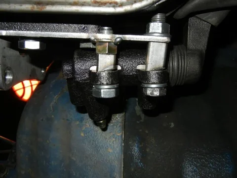

My fix, a 2003 Camry Slave cylinder with a custom adapter works well....or there have been no problems so far is more accurate. The adapter has extra holes in it....lets call them weight saving holes.

Ah ok. The stock clutch slave cylinder did not work with adapter kit as it was too long and with the hose coming out the long end, it would not fit. Thinking now, I never tried a right angle bend out of the slave cylinder but I am pretty sure it wouldnt have worked either way.
