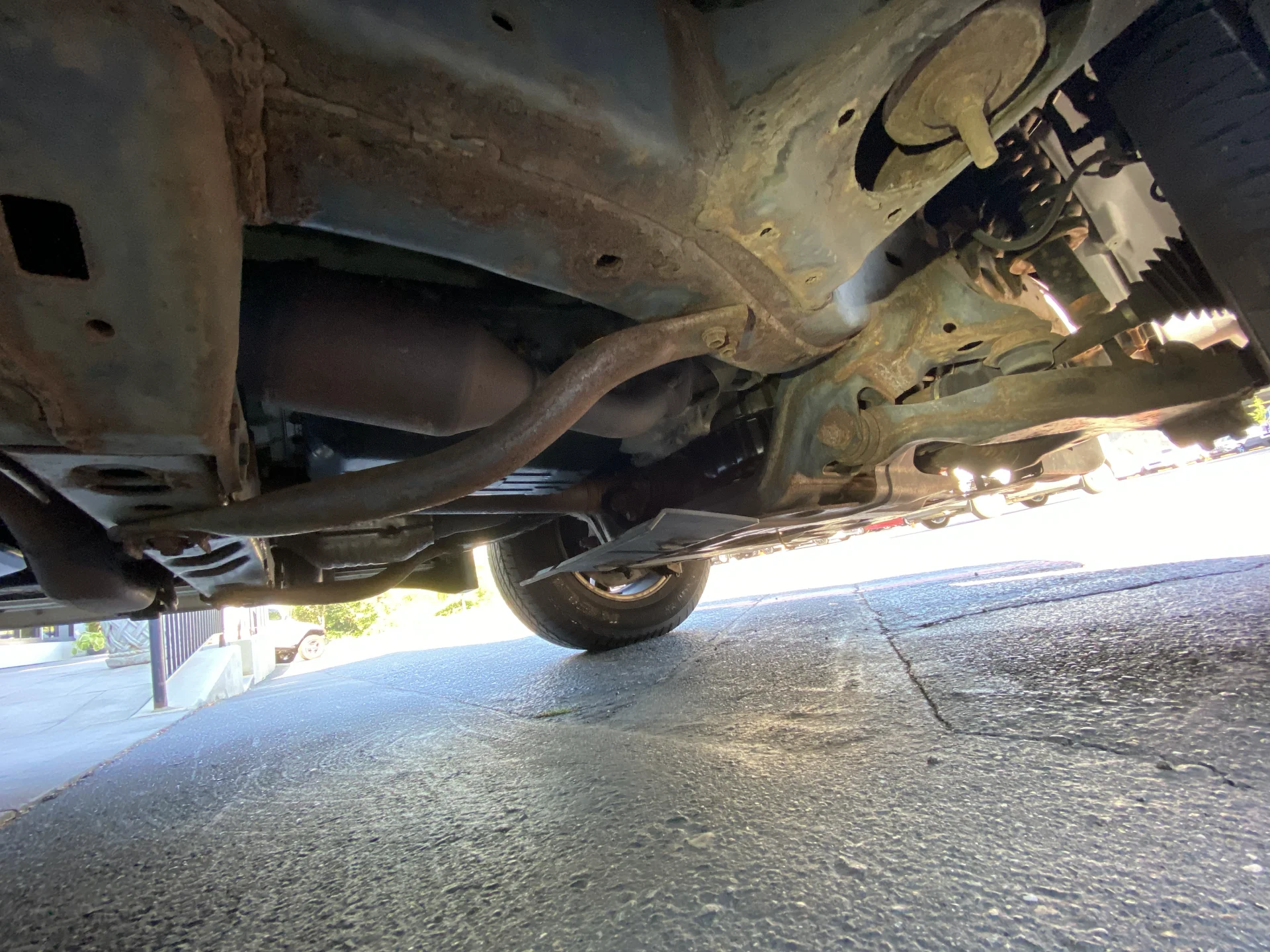

Hello! New here so I apologize if I posted this in the wrong forum! Found a local trade 2009 95k GX 470 with sport and nav/ML package. Just came back from the dealership with the photos attached. Basically the interior is pristine with VLINE installed too. Only minor wear and tear and less than expected for age.
All service at Lexus with full history on the website. Serpentine, timing, and water pump done at 85k. Alternator at 88k. After driving it, probably needs alignment and rotors/pads because it shudders while braking.

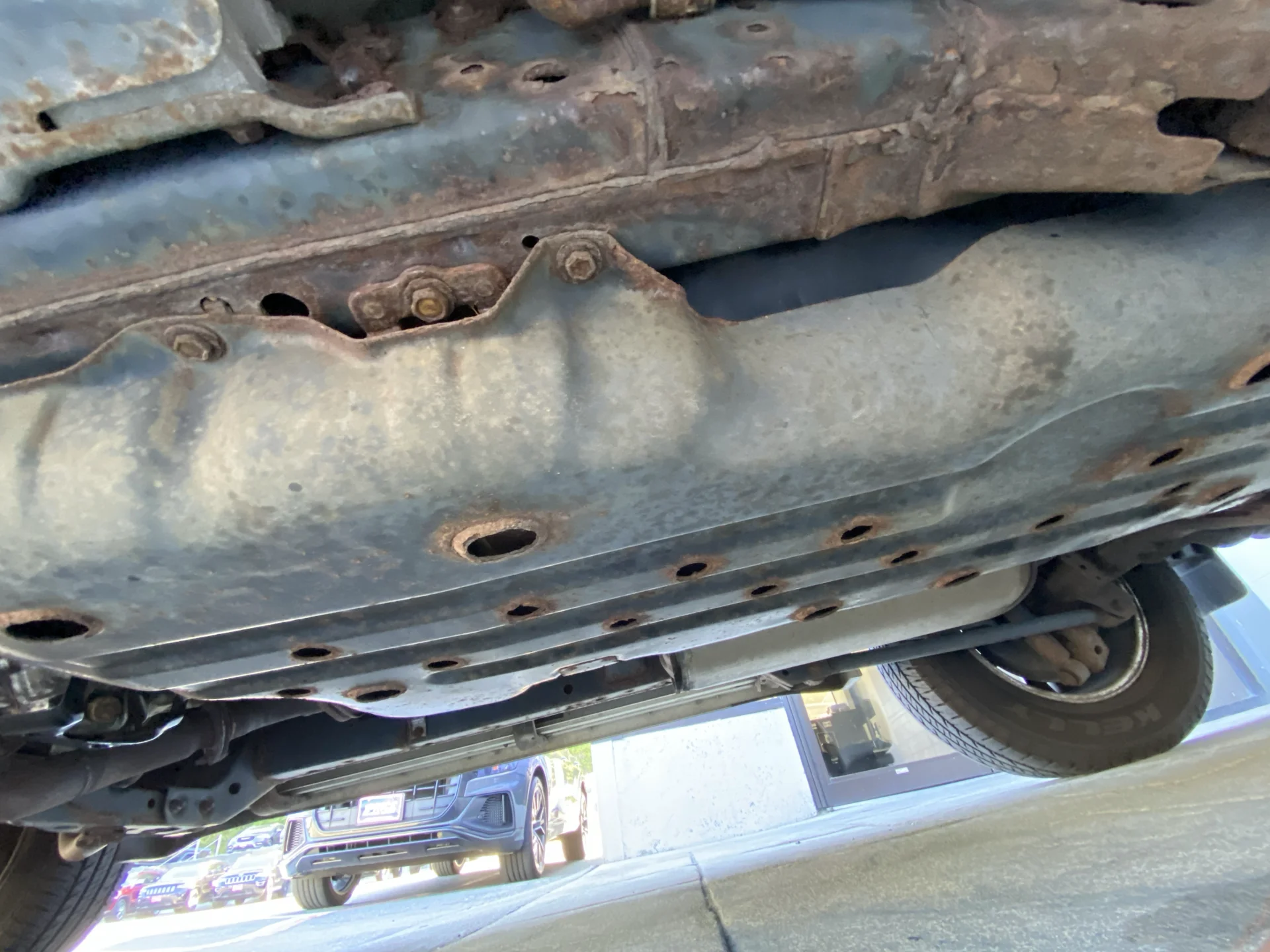

However, the underbody is kind of scary for someone without a good understanding of this rust. Thoughts? Can this be wire brushed, converted, and painted? I couldn't find any holes but I'm also not sure where I'm looking for them.

That’s not that bad. Looks like a typical Midwest truck. I’ve patched my frame a few times and it only has 170k on it. Been in Ohio it’s whole life but the interior and exterior otherwise were showroom new looking. That’s just the name of the game anywhere that’s not super dry. Great drivetrain but garbage frames.

I've certainly seen worse, but that's definitely beyond surface rust. It really seems to be concentrated at the seams/welds. For that price, I'd keep looking.

Maybe it’s because I live in So Cal, but I wouldn’t touch that rig because of the rust. It’s definitely not “mild surface rust” and it will get worse. Unless of course you into a lot of work and it’s a slamming deal like $13k. Otherwise keep looking. There are plenty of no rust GX’s rolling around here and other non-salt states.

The rust does not look much worse than my '07 was and could probably be treated easily with Fluid Film or Wool Wax (as long as no areas are actually rusting through). But that price is WAY too high - it should be 100% mint for $24k. I know prices are higher in the PNW but it's just too much for a GX that isn't pristine in every possible way. If these seriously are going for that much mine is now for sale for $24K :).

Rust isn't terminal like folks on here have said. Although the seller is smoking crack asking that much money. If it was a cheap truck I'd snag it up, some rust coating/fluid film/paint and enjoy.
