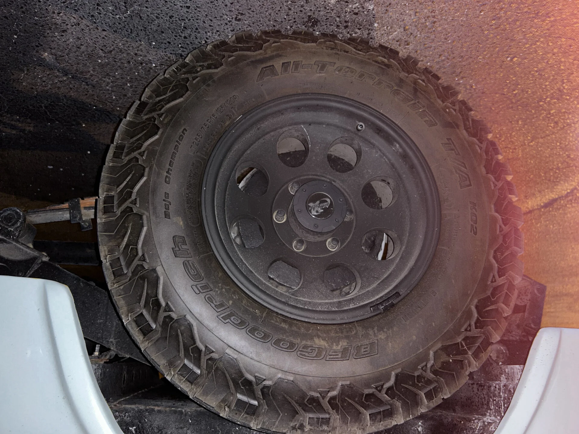

I have a 1980 HJ45 pickup with 16" aluminum wheels and new BFG AT tires that I am swapping in some pizza cutters and steelies into.
Does anyone know if the 40 series wheels will fit the FJC? Seems like the same lug pattern.
HJ is in Florida right now and I'm in AZ, so can't try it, and I'm trying to figure some stuff out for when I go get it.
Thanks!
I believe its the same pattern yes, but it really depends on the offset of the wheels. Stock, those 40s seem to have a pretty high offset. Also the FJC calipers stick out a lot past the wheel mounting surface - both of those aspects together = not ideal situation.
Now if they are just some random aftermarket alloys, then they are probably a more standard offset and very well may fit fine. Youll want them to be hubcentric to the FJC though, so that will need verified too.
Also verify the tire size is big enough for FJC.... a lot of 40s are running smaller tires than come stock on a FJC, like a 235, ect.
Best solution will probably be just to try it.

Thanks I will check it out.
The tires are 265/75R16s
The wheels are ProComp alloys.
Thats helpful. From all that I have seen, those 16x8s should fit a FJC fine. I assume they probably have the 4" backspacing.
