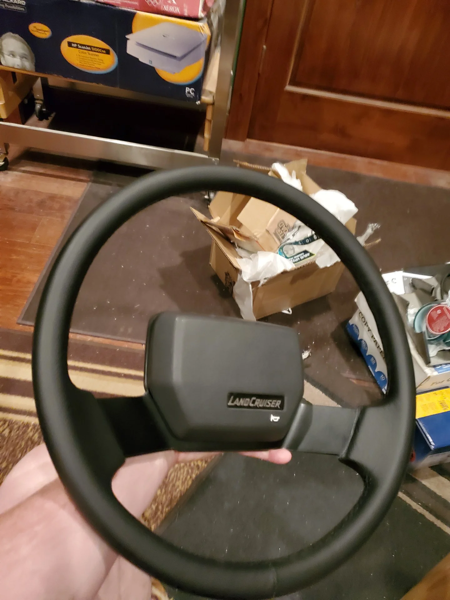

If you go with a wheel from a different series Land Cruiser you wont need an adapter. I found this one on E bay.

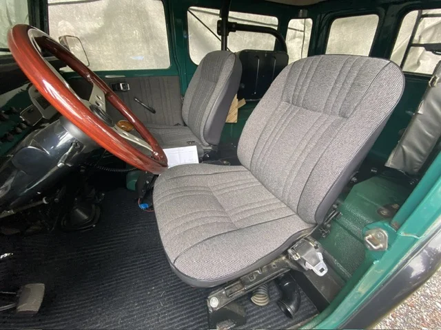

My ‘75 had a Grant wooden wheel on it when I first bought it. Power steering with the smaller wheel is a good feel but I reverted back. The adapter on mine was the standard splined hockey puck and the wheel was attached to it and this bolts covered by the center horn button. The Adapter was the 4579…
It’s the only photo I have with the wooden wheel…sorry

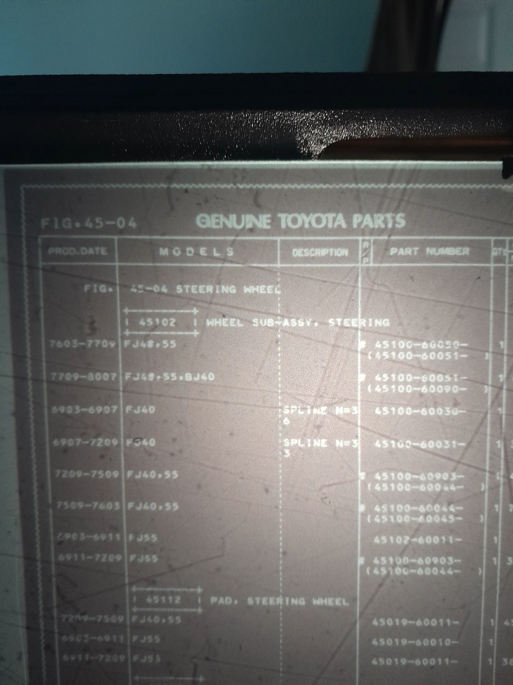

I heard they changed the spline count so the older ones my not be interchangeable.
wow thats awesome to hear. maybe a 4579 plus a 1/2" 3 to 6 converter will do the trick. I'd just buy a grant but I have this thing for Momo and its too late to return the momo. I have resisted pulling the wheel off until I had more data. thinking of adding a quick release to prevent people from driving off with the thing here in Newsom's lawless CA.
