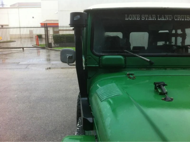

I zoomed in on my iphone but it's hard to see, I'm looking at the little outlet scoop on the top spin.... it apears to be pointing forward. The top spin pre-cleaner sucks air in through the outer bottom ring, spins it, and ejects debris through that little scoop. So you want it facing rearward to help it out.
If you get that Safari top scoop post up some pics, never saw one on my snorkel.
Kevin
My scoops pointed back... I think Sullys is too ... Love the looks thanks again ...

Mine is pointed back but towards the outside. I noticed yours was pointed towards your windshield this morning.

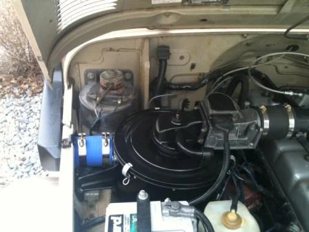

Installed! I have a 3FE in my 40, did a little modification to the air box; cut off the intake, covered it, and put a new one on at a different angle to get it to connect straight to the snorkel.
Great product, thank you!
Looks great, nice and simple straght in design.

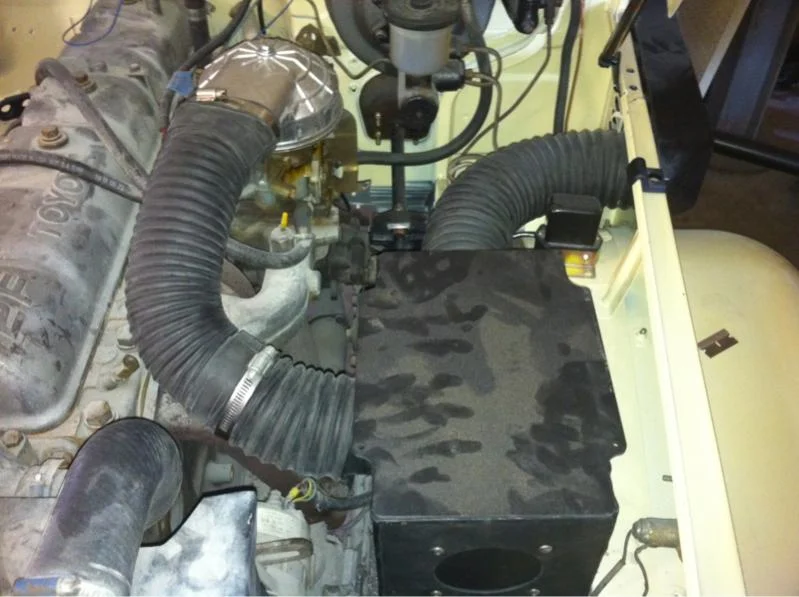

My one foot of tube just made it on the 3B really should have run it all the way around the air box and in.
Also the Safari snorkel top fits great
Sent from outer space via my mind
Here's a pic of my plumbing. The 2ft was enough but I got it to work
