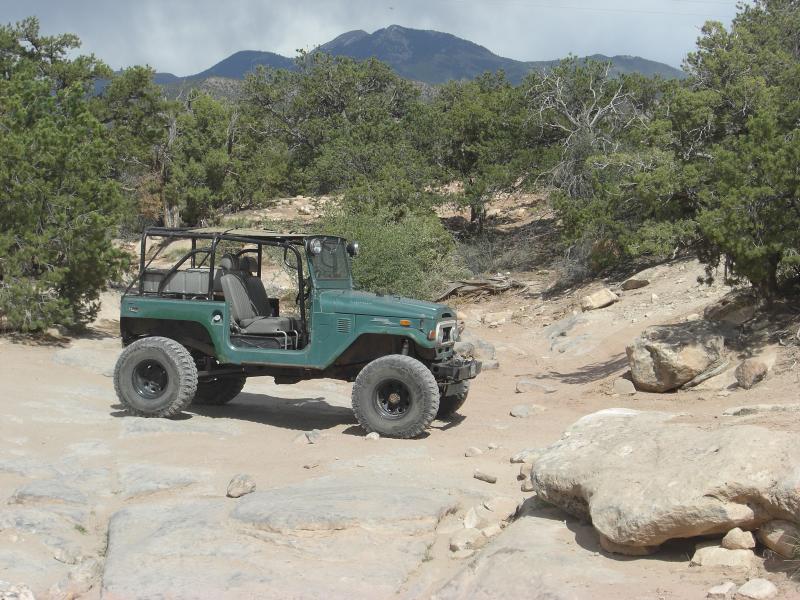

So its been a while since my last post, but a lot has been done.
Everything went together with a few long nights and one skipped day of work.:whoops: I was able to make it to meet my friends in Moab last week for our annual trip. I have some bugs that need to be figured out but for my first suspension swap I'm pretty happy with it. Here are a few pic's.
Thank you everyone for all your fantastic help!!! Could not have done it with out you all.
