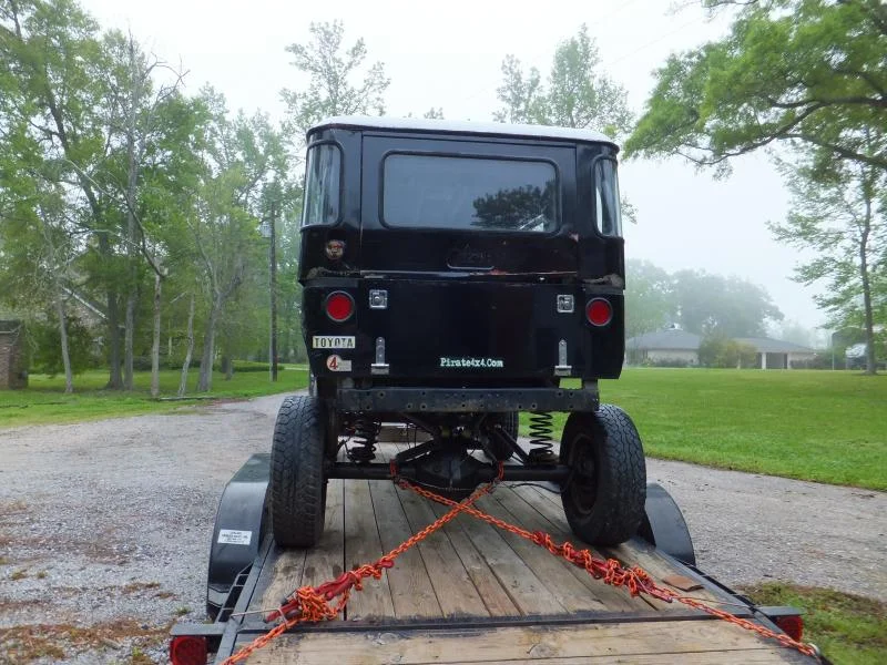

So I have been away for a while but now I'm back working on this project. I have made some good headway since the last post.
The rear is almost done, All brackets are welded in place the springs are in and the brake lines are almost done. I still need to get it out of the garage so I can flex it to find where bump stops and limit straps will need to be placed.
The front is now the main focus. I have outboarded the front spring hanger 1 3/8 inches, welded my spring perches, cut and turned the knuckles. Im waiting for the High steer arms to put the axle back togeather and back under the truck. Still many many things to do but I'm getting closer. :)
