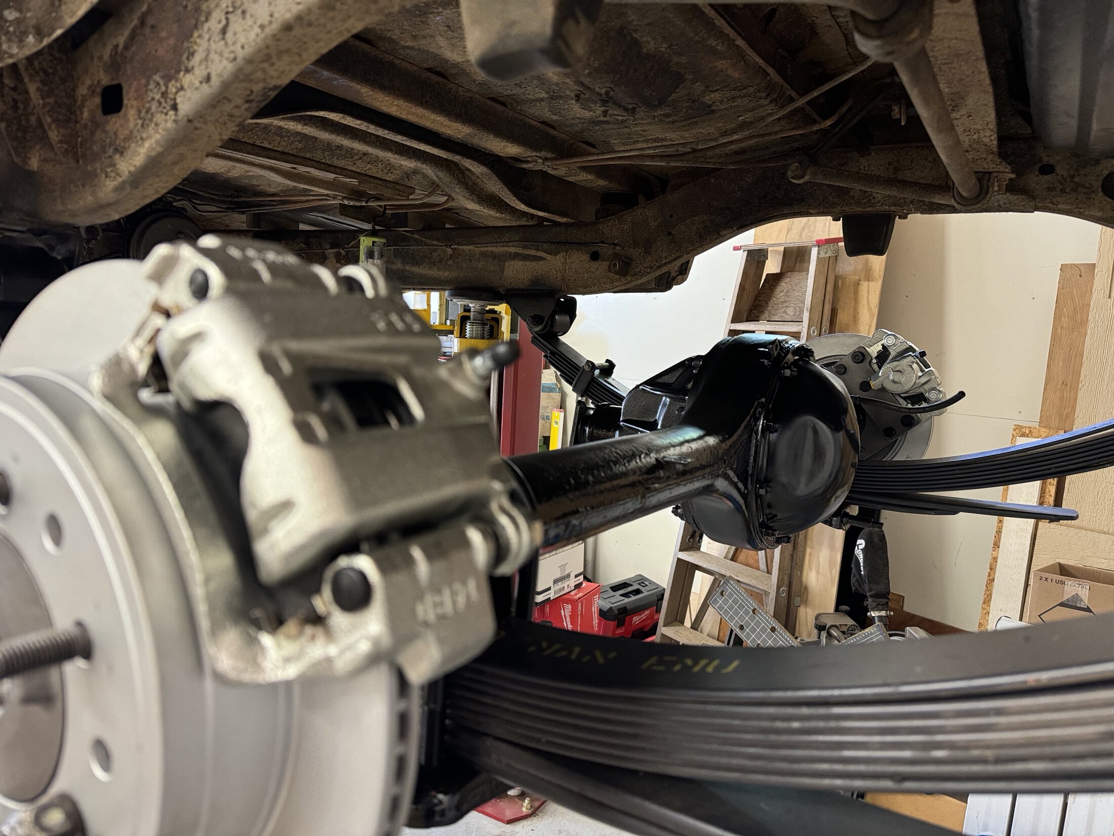

Getting things together for putting a 60 axle under my 55, my buddy has a 4 runner with rear disks which he says work great, my question (after searching Mud) has anyone done 4 runner rear disks on a 60 axle?
Disclaimer: I have no interest in an 80 axle as its too wide nor do I want to narrow one...but I do like the idea of keeping the rear disk solution in the family vs the Chevy based kits out there. I am a capable welder/ fabricator with access to machining if required.

Update, designed and cut some brackets, now assembled on axle but not plumbed or driven yet.
