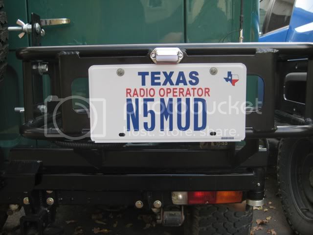

THANK YOU for posting pics of your license plate light install! Based on this, I did a nearly identical build yesterday with a piece of mild plate steel and a $6.00 Taiwanese light from Pep Boys. I was originally going to drill holes to install the OEM plate frame, but your rig looked a lot cleaner. I couldn't find any of the adhesive pads you used, but zip ties did the job.

Black wire with black zip ties on the rack leading to the license plate lamp...

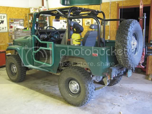

Just finished my 4+ 1045 install; this thread was helpful, thanks.
I added grease zerks to both spindles. They used good steel to make these things, even with a brand-new Titanium bit it took a long time and a lot of pressure to drill those holes!
I used my stock license plate holder and lights because I had them, but I don't like how tall they are on the back of the basket and may do a much more compact light and mounting like DomSmth and LakeNorman.
Overall a very well-made piece of equipment. My only complaint is the paint - mine falls off if you barely touch it, and there is no primer, just a coat of gloss black. I had to touch it up in numerous places just from gently trial-fitting it and handling. I finally started touching it up with Rust Bullet Black Shell, hopefully that will stick. But for the money this thing cost, I would think that Man-A-Fre could powder coat it or at least use some primer and give you a decent paint job. At least the steel is so thick that it will take a long long time to rust through.
Final clean-up of license plate mount and light, project now officially finished:

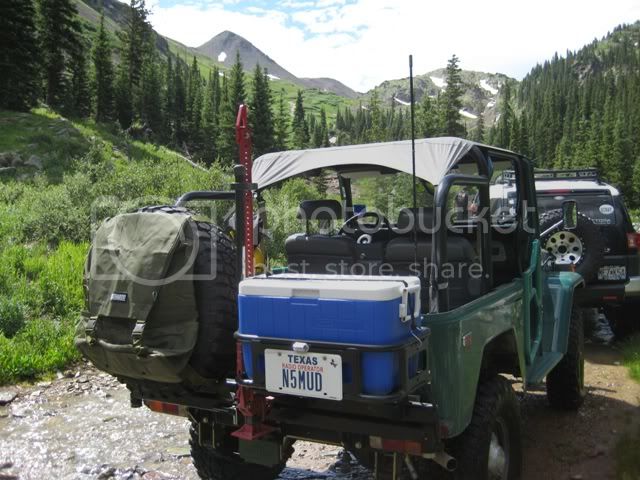

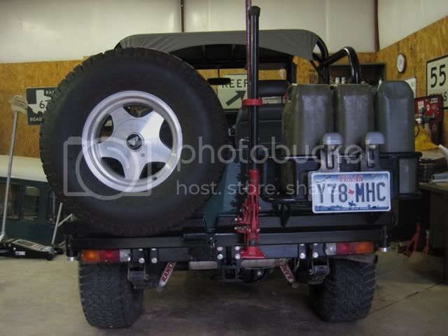

OK, I've been using mine for 6 months now and several 4WD and other trips and still really like it, but I've only used it to carry an ice chest so far and I just run a bungee cord over the top to hold it in / keep the lid down. Has anyone found or made a good metal or nylon webbing strap system to secure jerry cans? Taking an extended trip to Canyonlands N.P. in the spring and I'll need to haul jerry cans for sure.

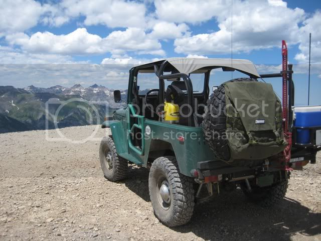

Here is a photo I took yesterday, after taking the top off for the season:
Here are some rear shots from last summer in the San Juan Mountains of Colorado:
