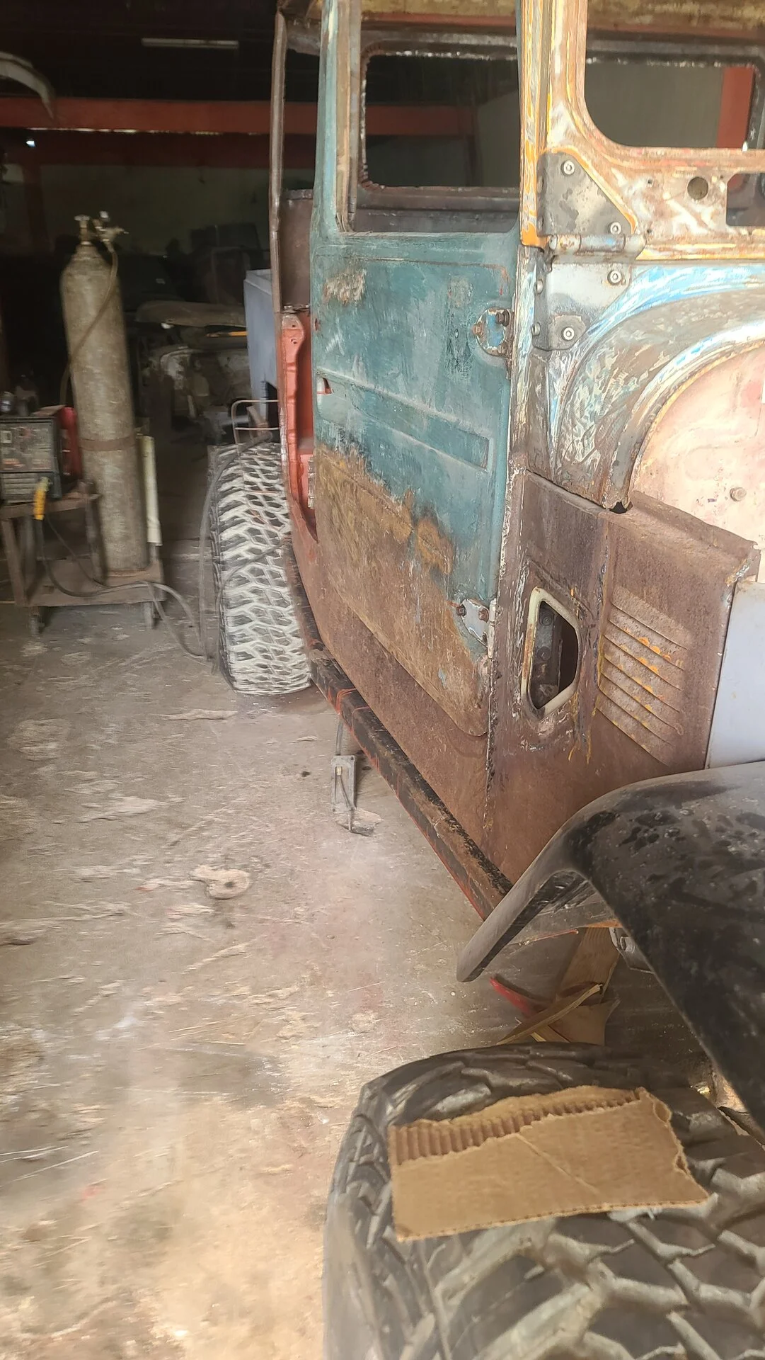

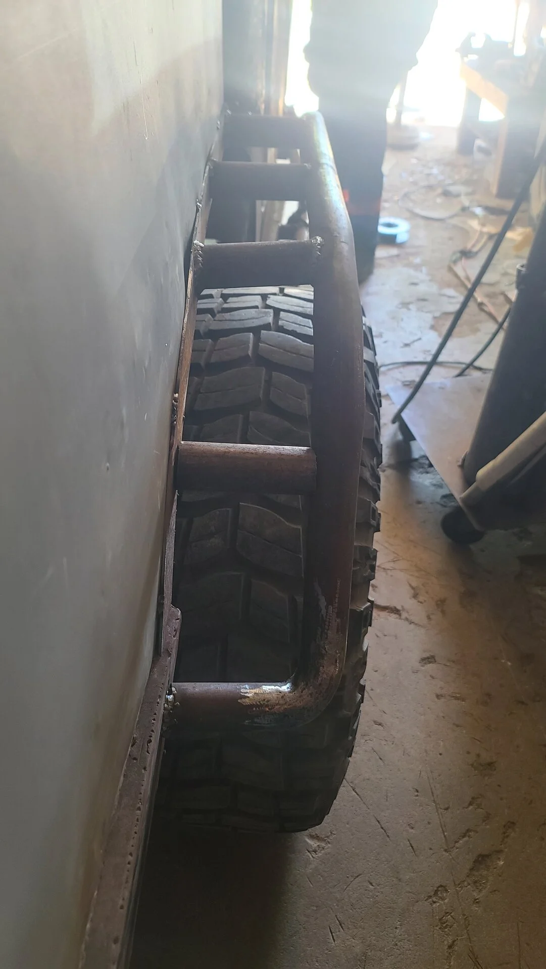

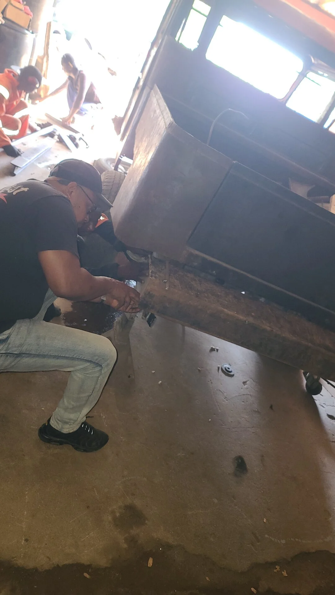

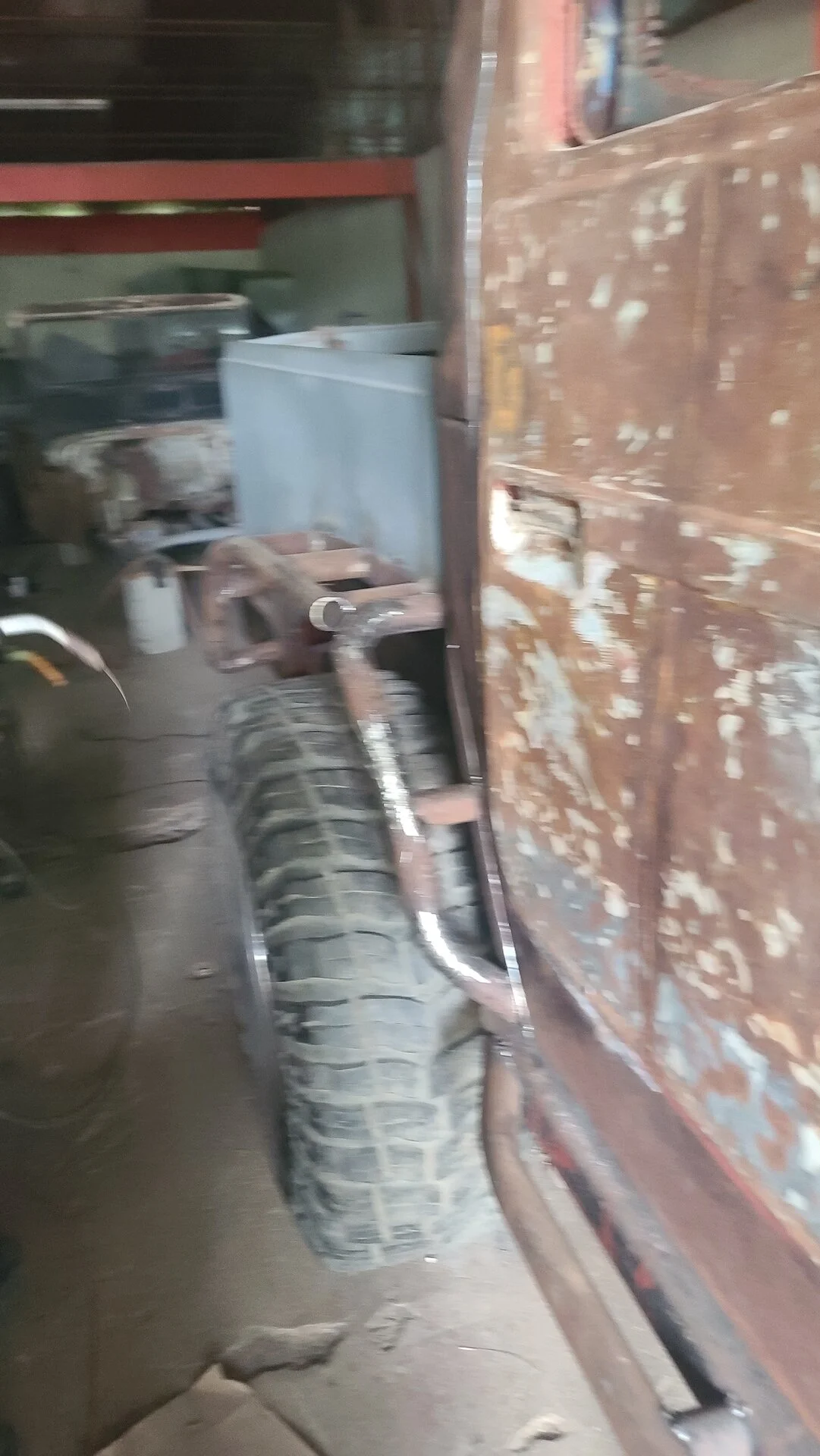

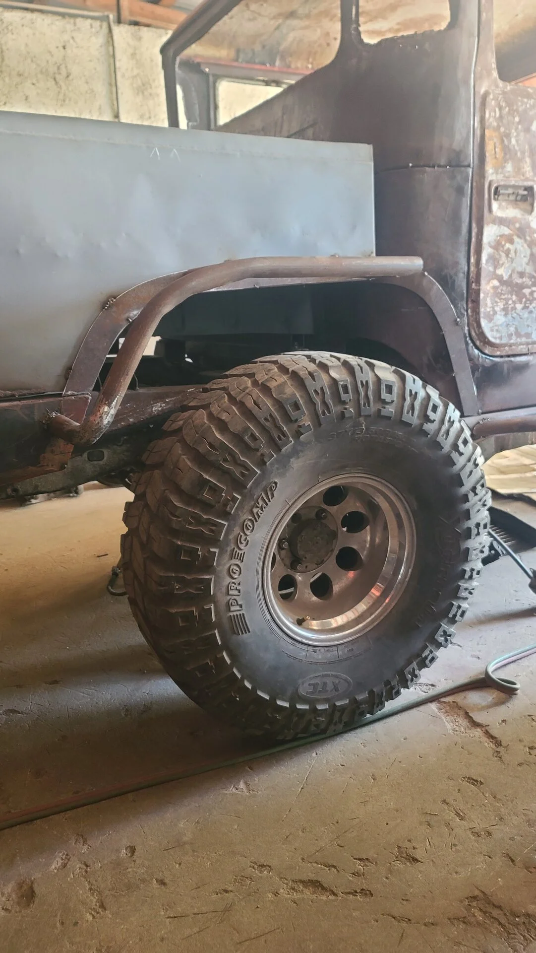

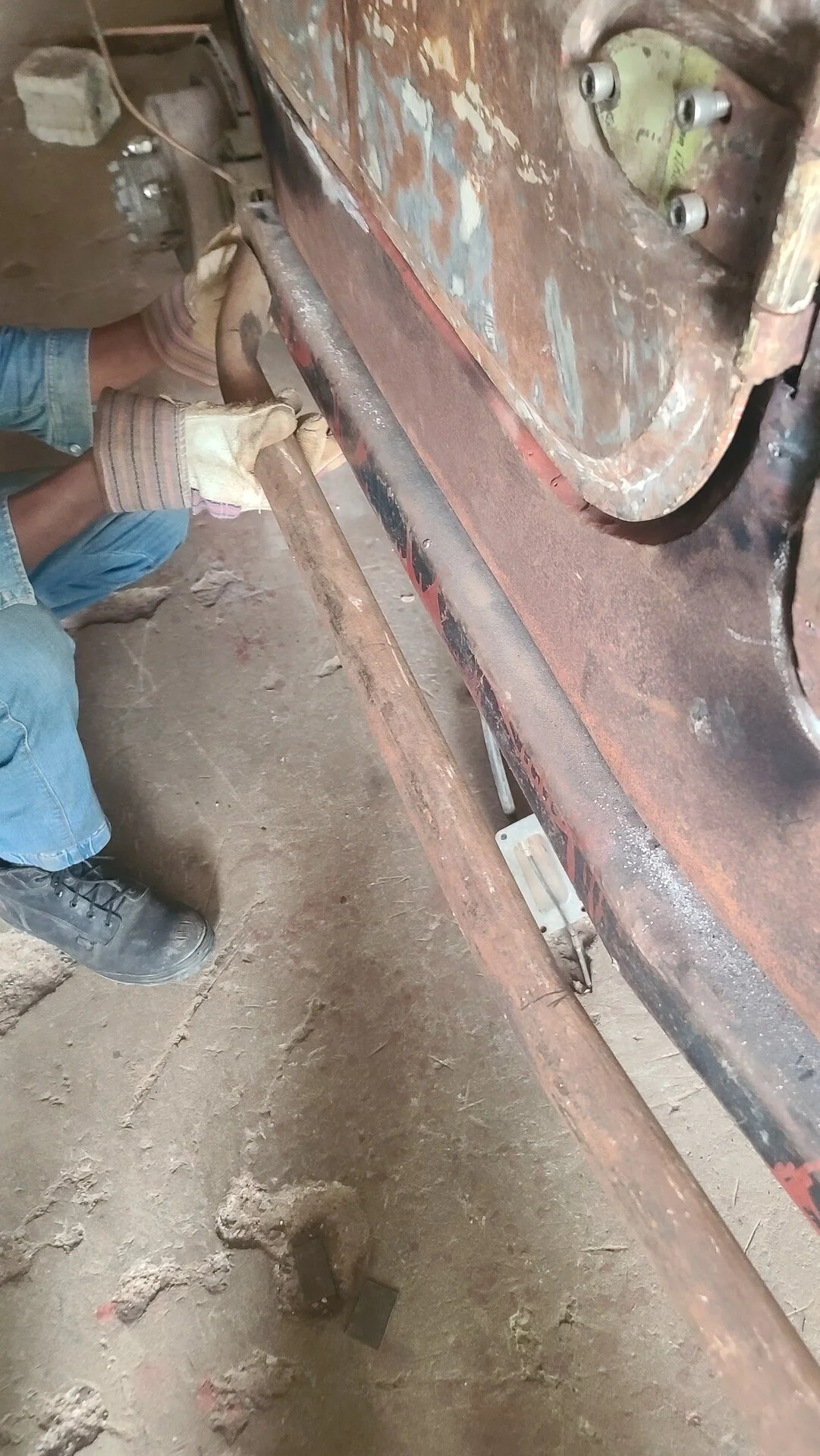

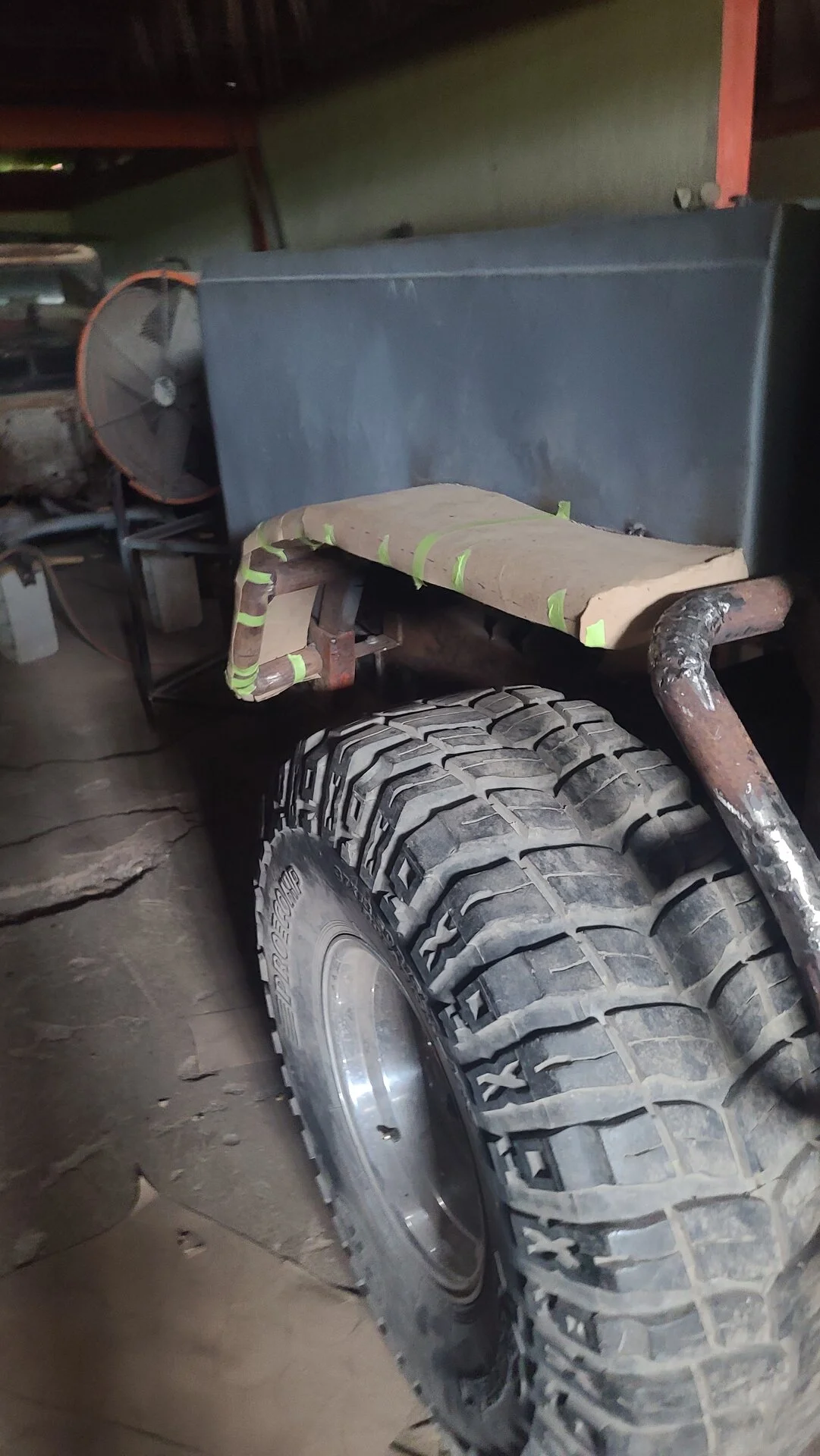

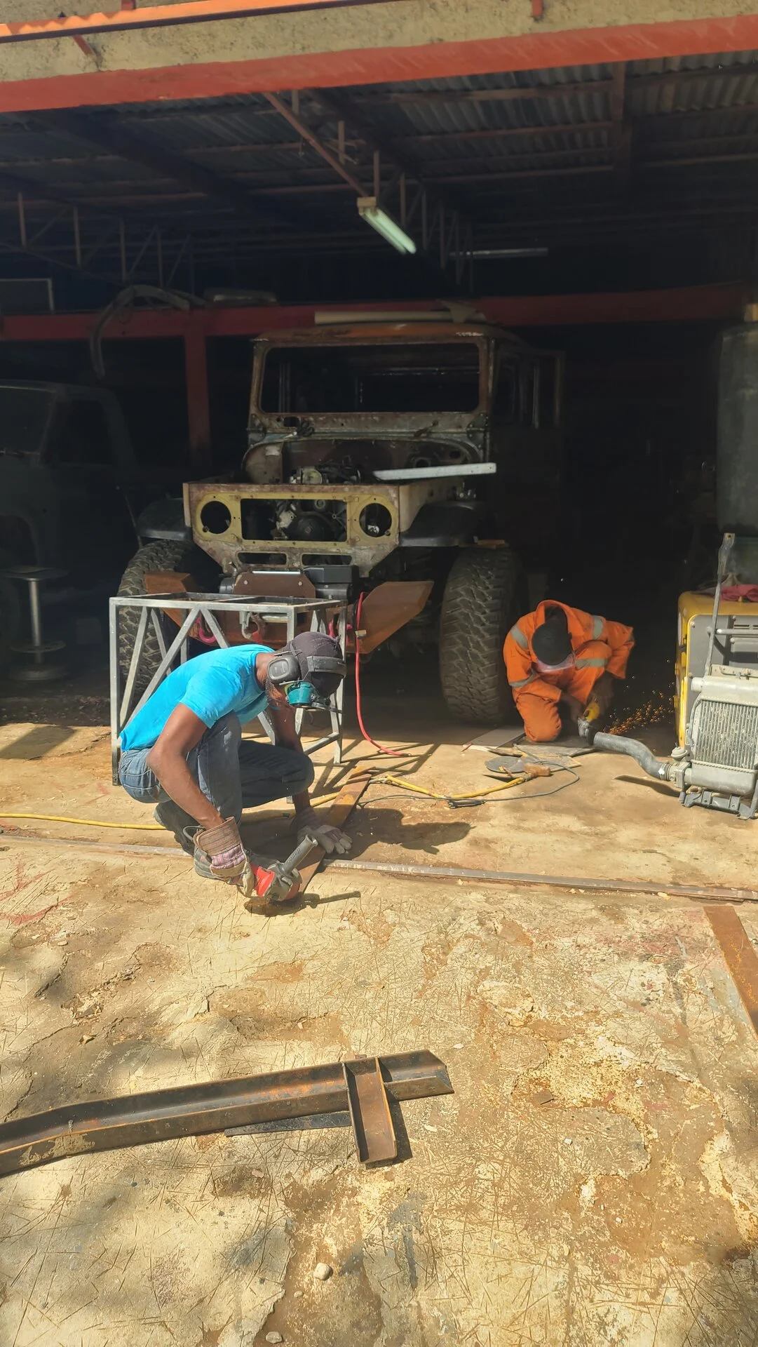

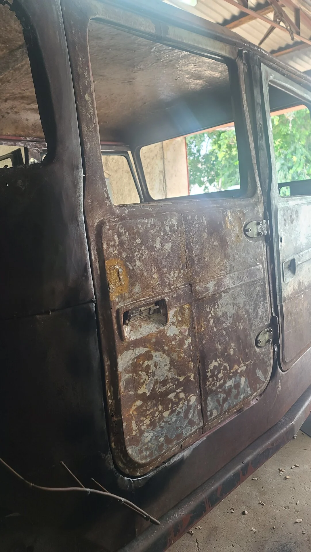

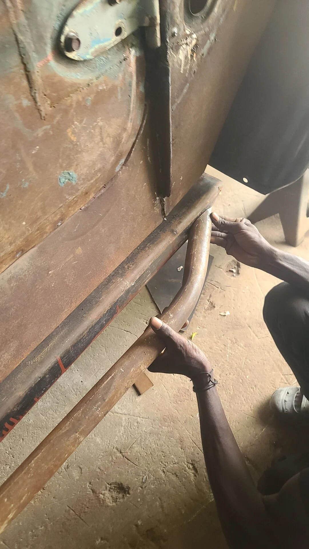

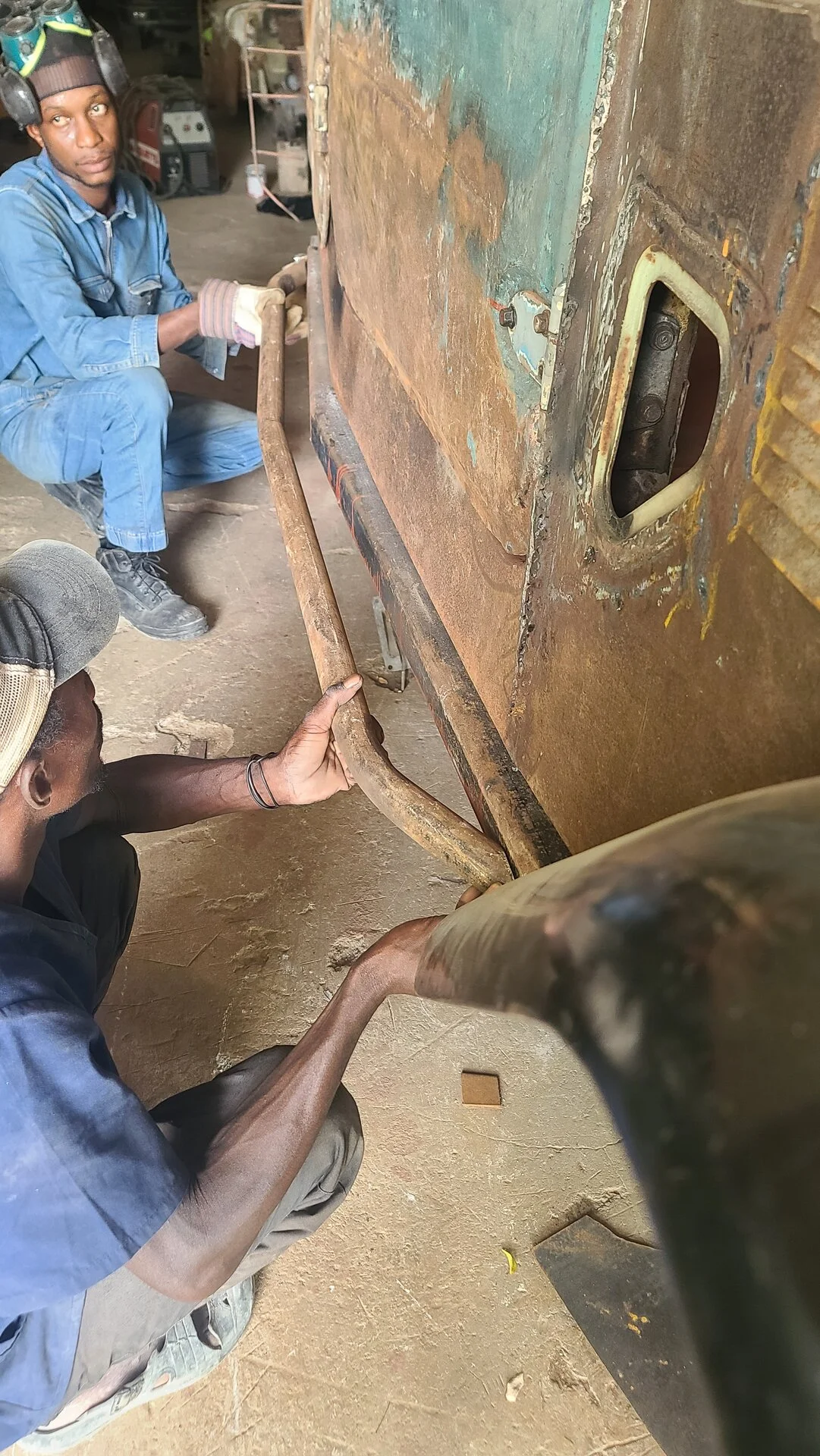

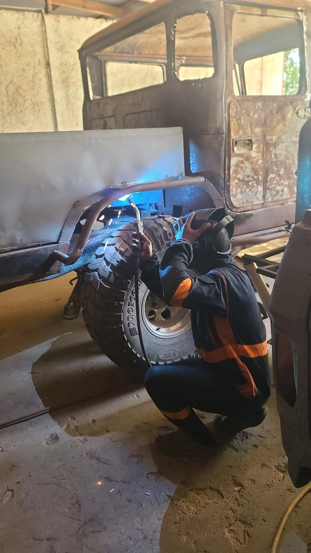

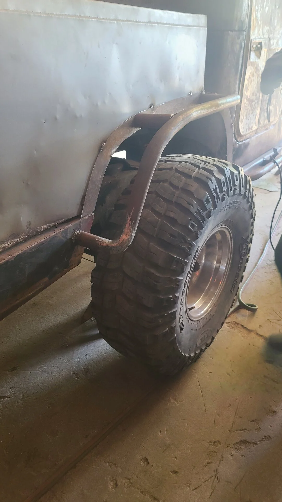

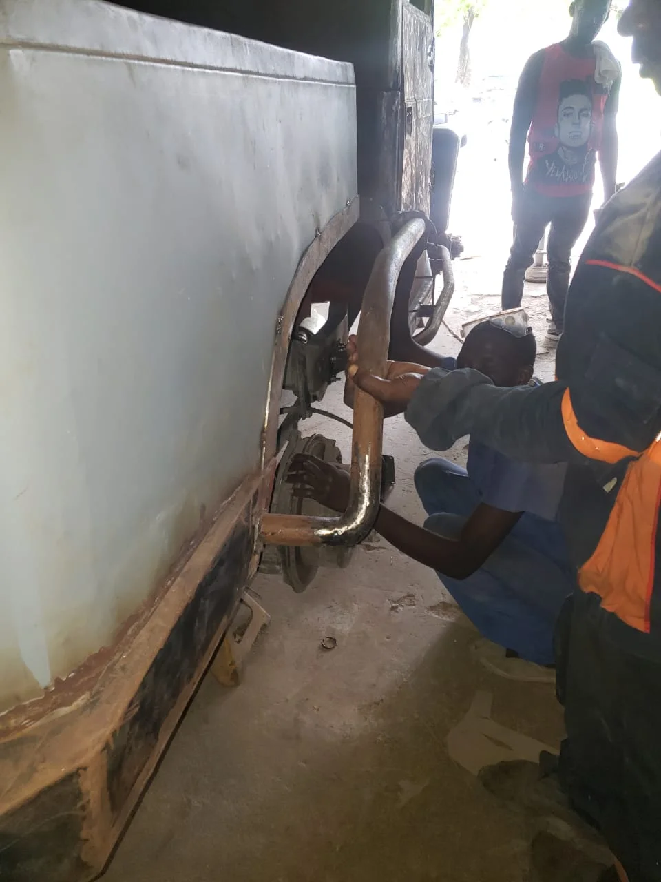

Had to work on some other projects today , but we still managed to give the sliders some attention

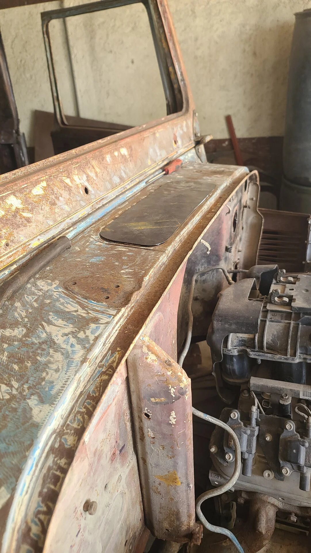

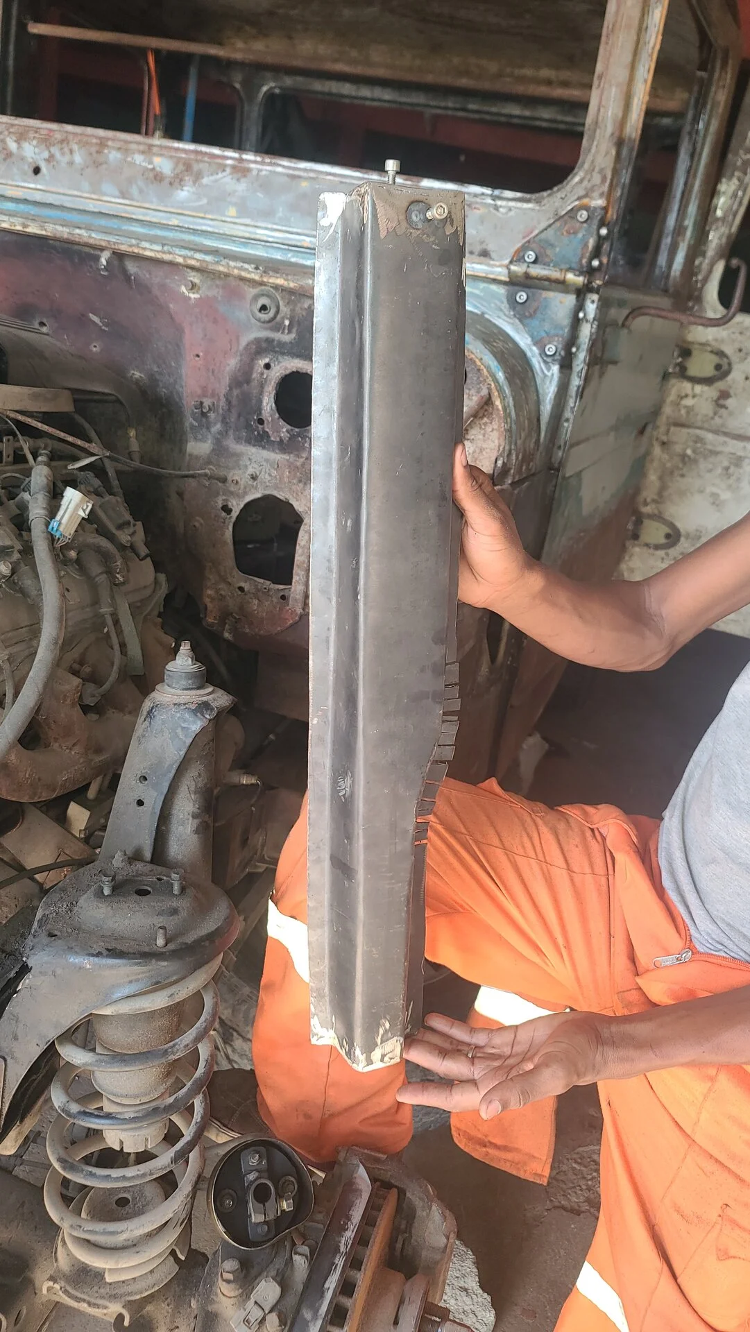

I decided to weld the cowl shut. All it did was accumulate leaves and grime. We cut a piece of .16 guage sheetmetal and will weld it in place next week.

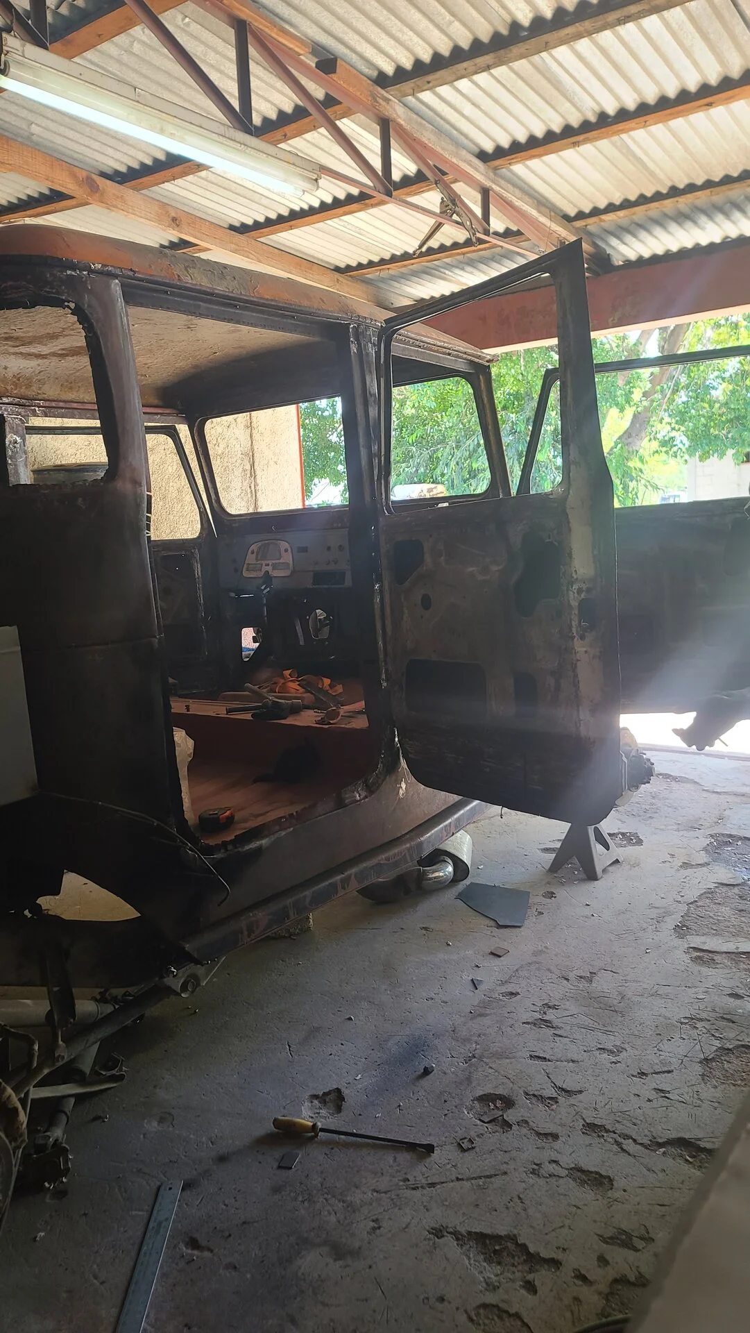

The doors are hung back in place. Gaps aren't adjusted yet but we'll get to that a bit later.

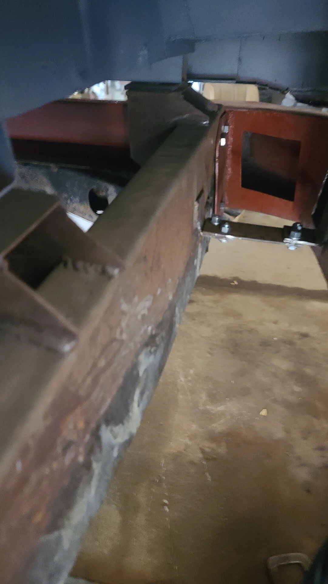

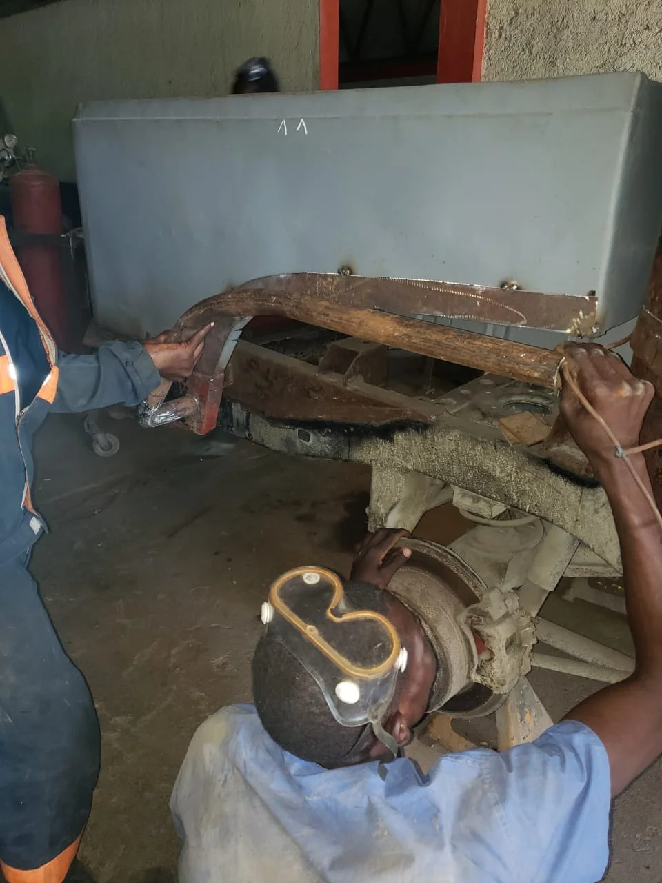

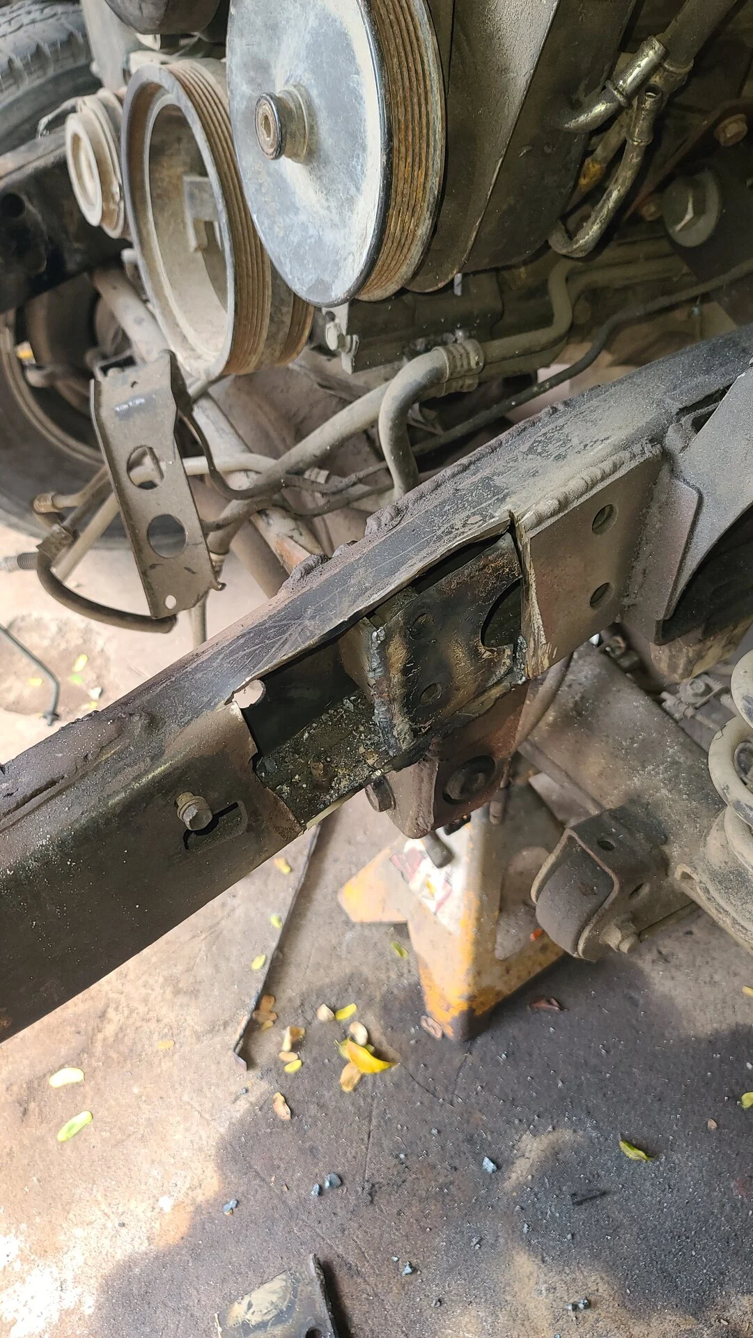

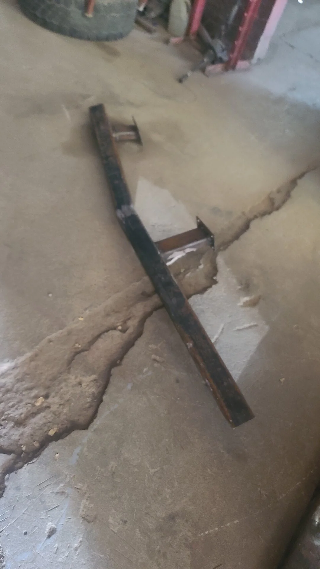

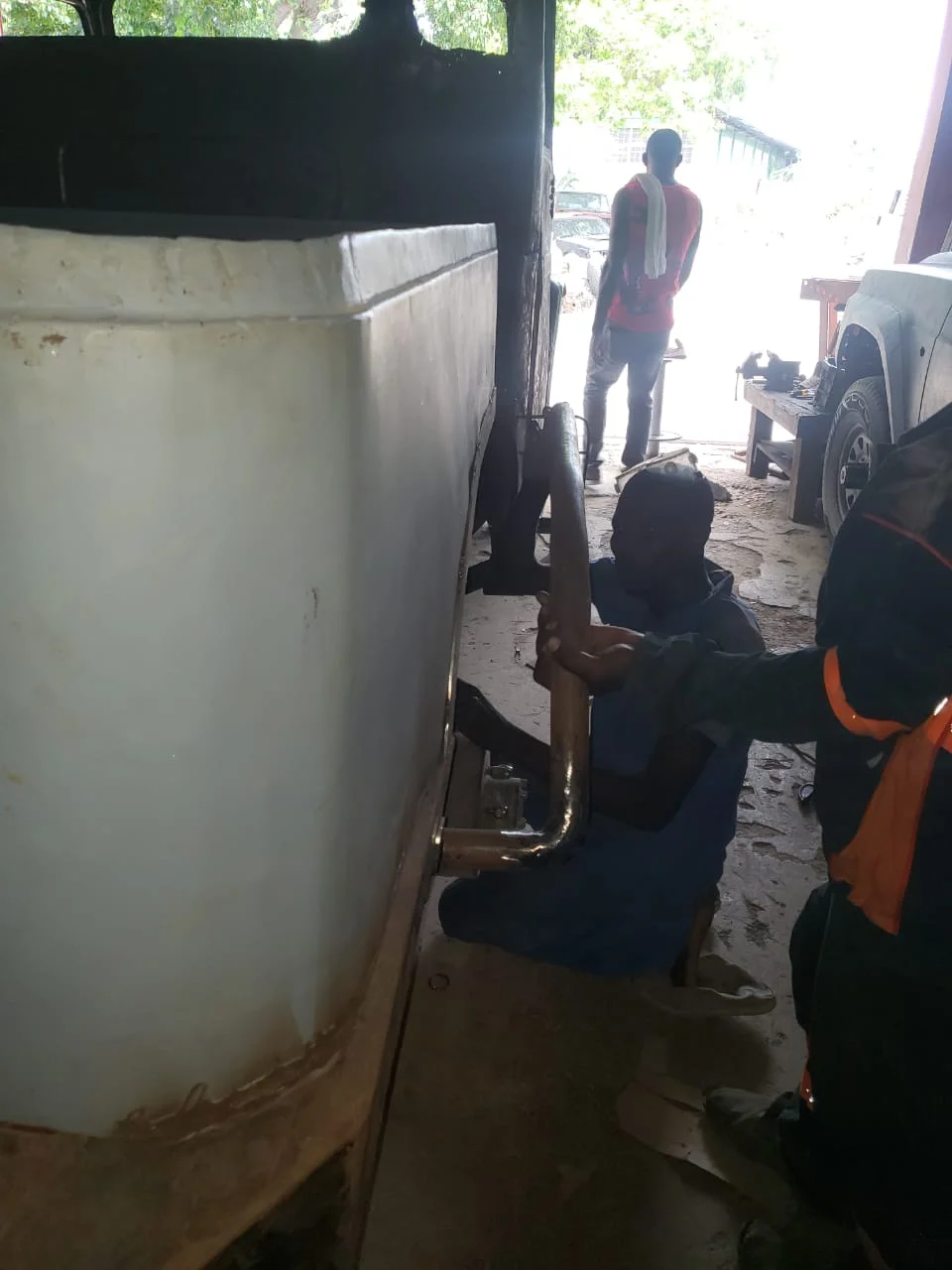

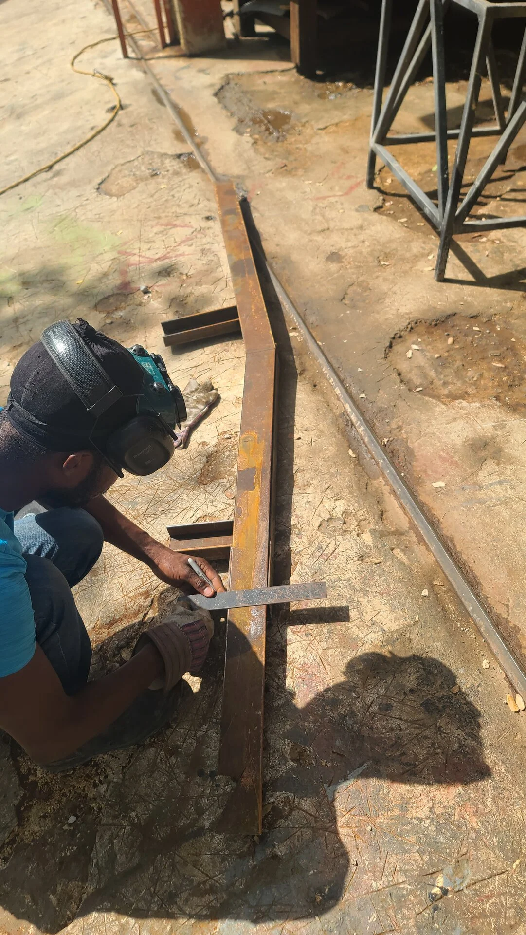

We fabbed up some bumper to frame brackets.... those are designed to keep the ends of the bumper from shakingand making noises.

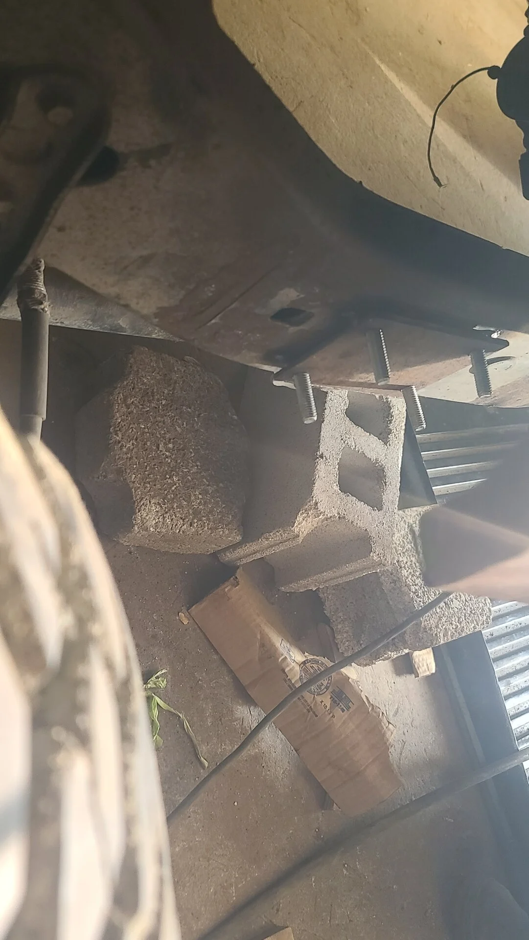

I got a decent deal on a Dobinsons 2.5 " lift kit . I was pleasantlysurprised to receive it here only about 8 days after ordering. I can't tell you enough how happy i am about this.

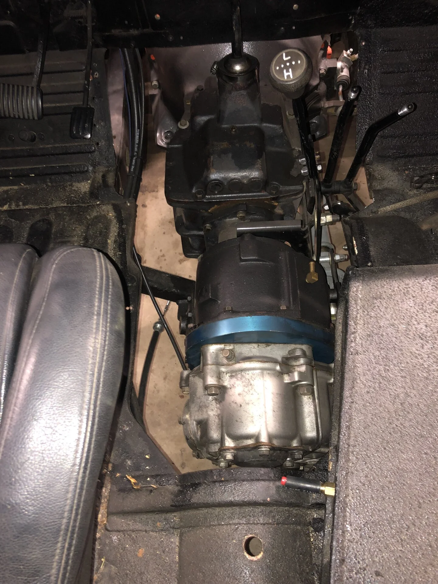

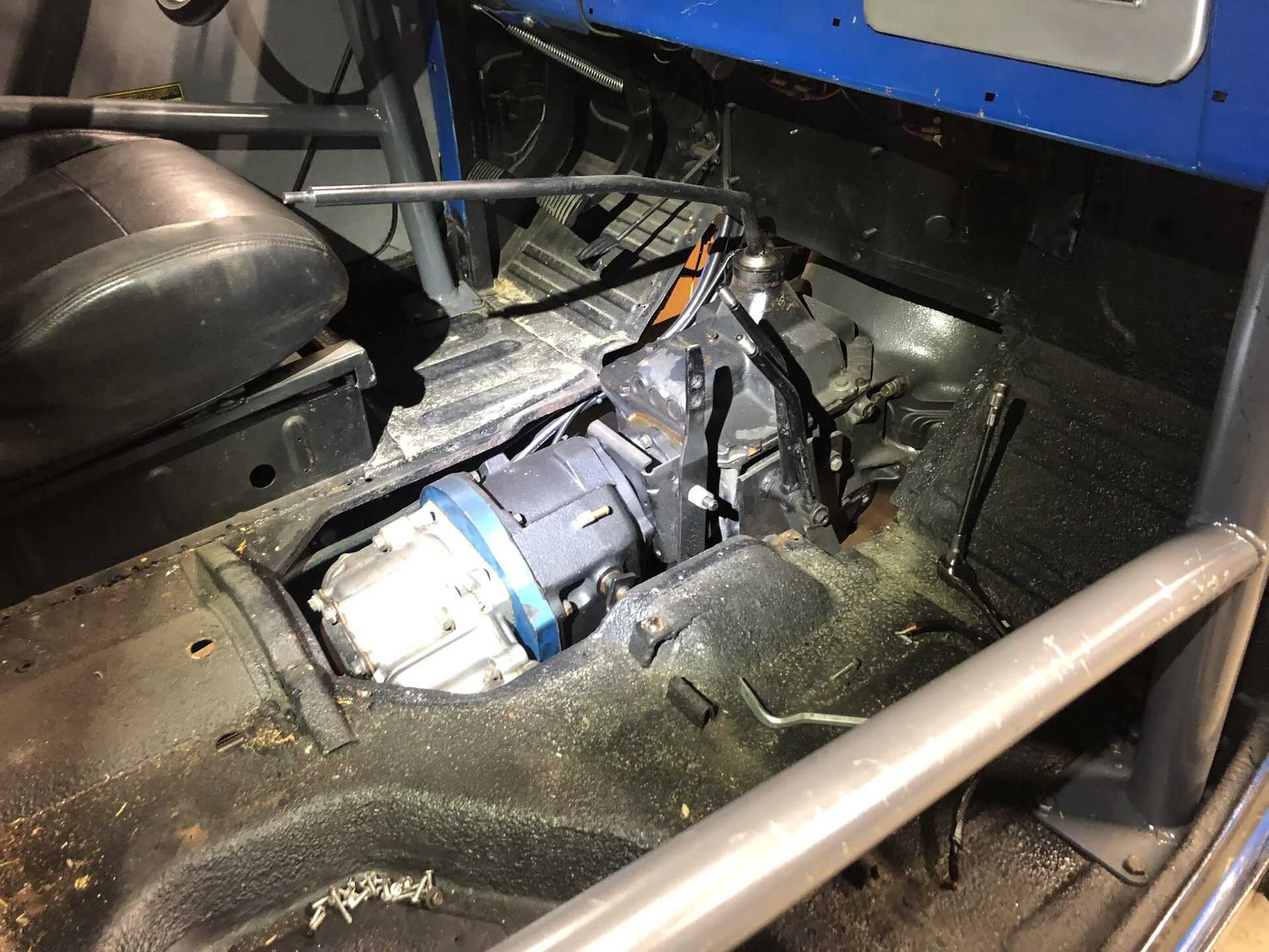

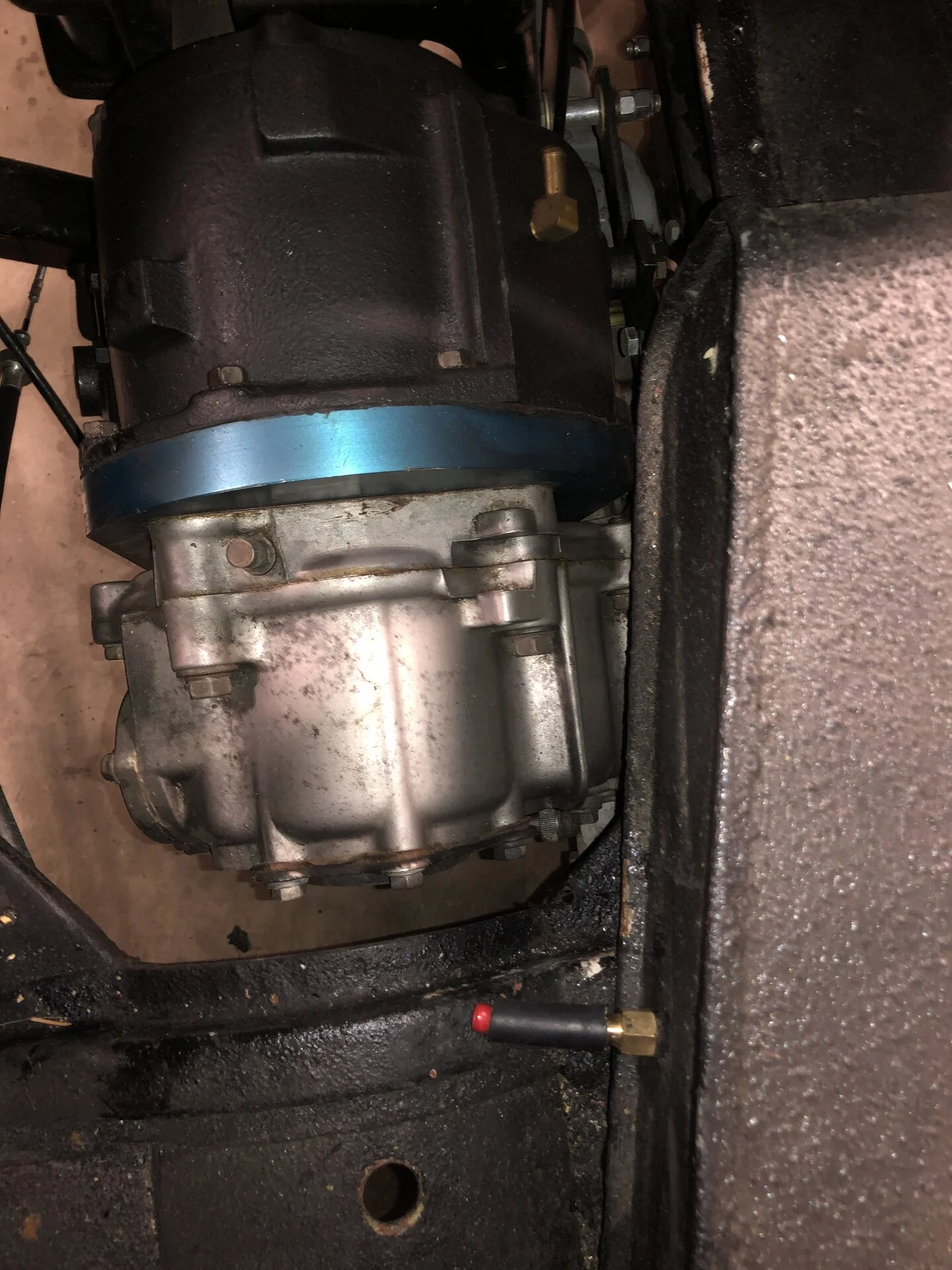

It's been a while since i posted anything here. I am now facing a new dilemma. I need to install my shifter and i am not too sure which one would work best for my setup. I also have to install the shifter for the black box and the Hi and low gear shifters. Looks like there will be many sticks going thru that tranny hump . I'd realy like to see what other members with Northwest Fab black boxes did with theirs. Trying not to cut more holes than necessary. I also want a Tuffy style console between the front seats.... there might not be any space left for much after that
Anyone with ideas , pictures of their set up, advice on the brst way to get it done, please, feel free to post them here . Thanks in advance.
Here’s what I did, I have a SM 465 4 speed trans, NP203 range box with a FJ60 split case using a custom adapter. I made my own linkage from flat stock and nylon bushings with stick shifters reworked to fit. I don’t love it, but it works and it’s well forward so no interference between the seats. One day I’ll redo it with rods and Heim joints, for now it works.
Thanks ! That'swhat I needed to see. I appreciate your help. If i could see a few more and some finished ones ot would be perfect
