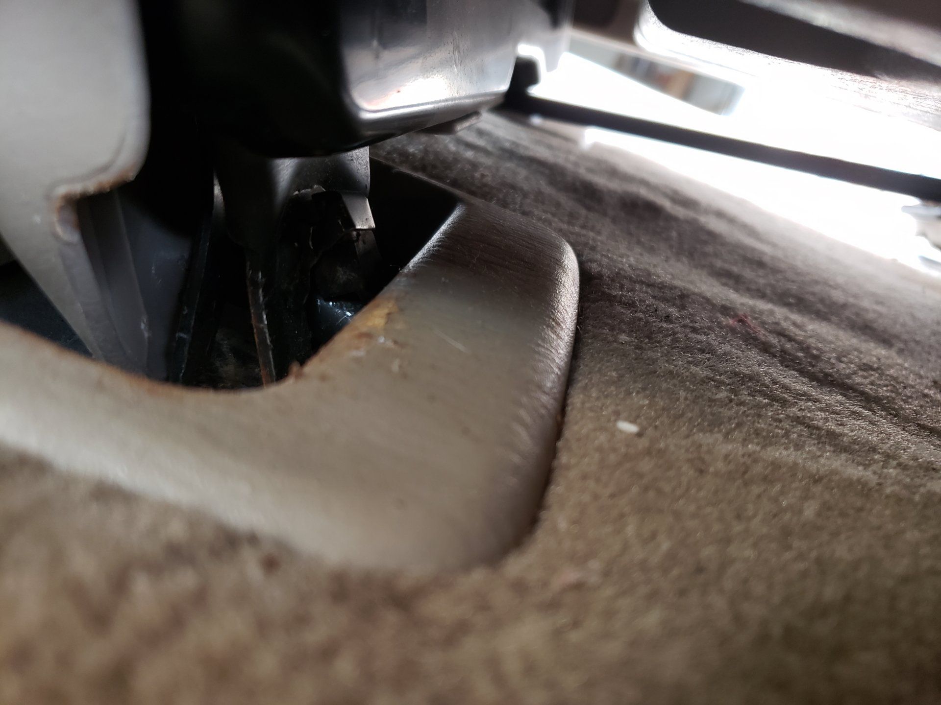

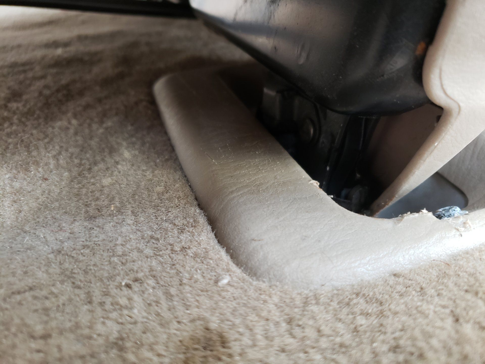

Here are some picts of my predicament

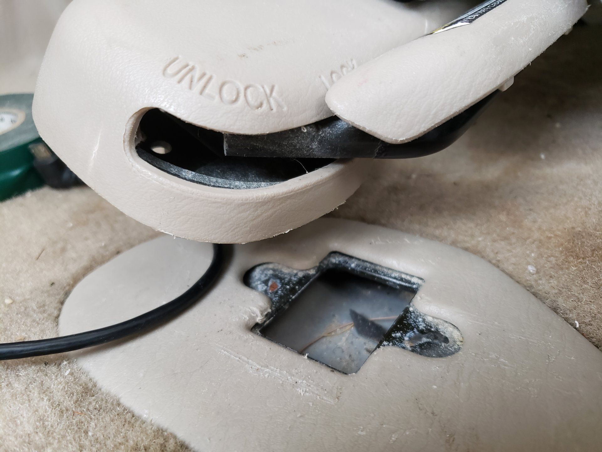

Mine was like this. There is a cable on the left side of the seat with this small spherical ball attached. Pull on this towards the outside of the trunk, while pulling up the seat. Should manually disengage
There’s a metal cable under the seat with a little ball on it. When you move the lever it pulls the cable and releases the inner lock. Sometimes the cable gets stretched and won’t unlock it so you have to pull it manually. I’ll take pics of mine tomorrow morning to send to you if it’s still stuck. I just used some needle nosed pliers to pull it to release. Had the same issue u have.
