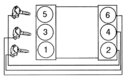

Try moving your coil pack off number 5 and see if the problem follows the pack. If it does, your coil pack is bad.
