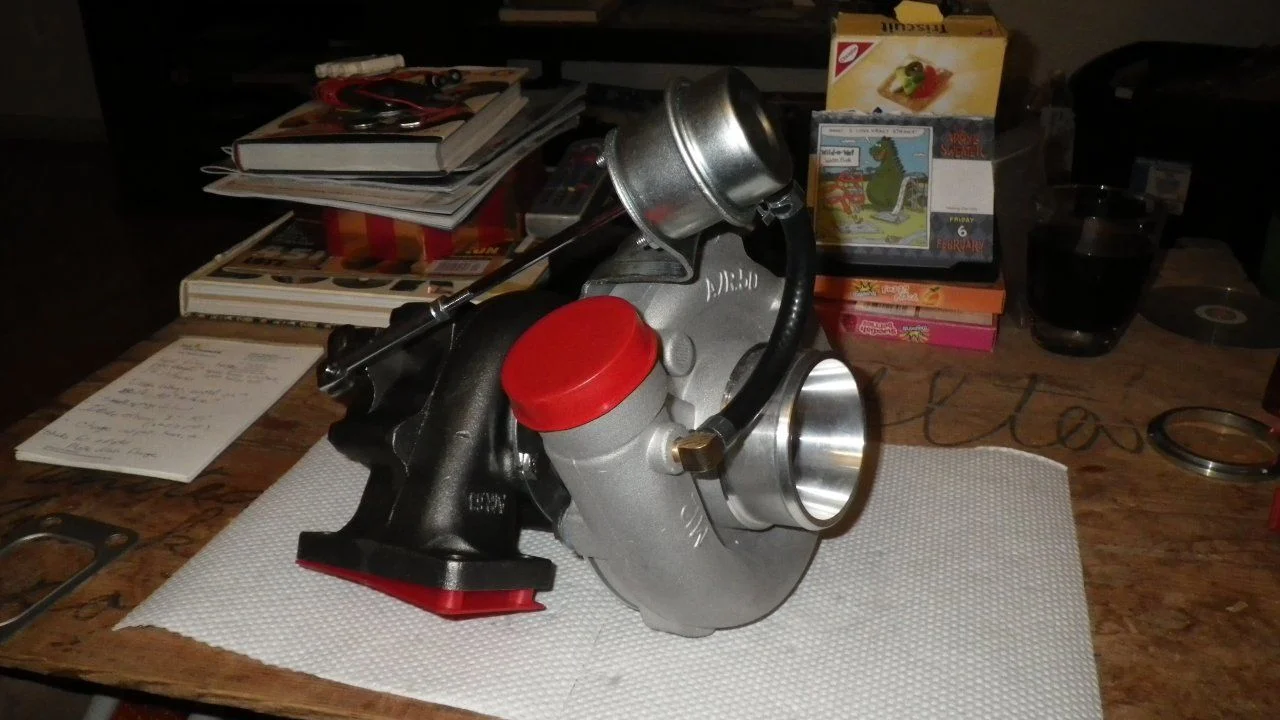

Well, I've been running a CT20 on my 3L in a 1990 LN106 for a few years now. Night and day better than no forced induction, but I dont trust the one I have to survive much longer. The CT20 is a basic unit, as far as I can tell, a dated design. Looks rather restrictive to my eye, however, an expert I am not.
So, after a bit of reading on the Garrett website,
I've gotten myself an ebay special T3/T4 knockoff, .50ar, 57 trim compressor side, .63 ar exhaust side, for the sake of science. I wouldn't expect a unit this cheap to last in the long run. But I also don't want to drop 1000 or more on a turbo that may or not work for my application.
I plan to try this unit out for size and see how it works. If I like it, I could see going with the genuine article of comparable specs in the long run. Install will involve making an adapter from T3 flange to factory 2LT manifold, figuring out intake and charge tubing, modifying my current oil feed and return to work, as well as modifying current exhaust system.
Then of course comes the test and tune. A sharp eye on the egt guage and a hillbilly boost gauge will be my guide. This is an internally wastegated unit factory set at 8 psi I'm told, but we shall see.
The goal here is to get a little more performance ( counting on hopefully the increased flow/efficiency of this unit) at the same 11psi I was running before. A top mount intercooler I have lying around will most likely get thrown into the mix in the long run. First things first tho.

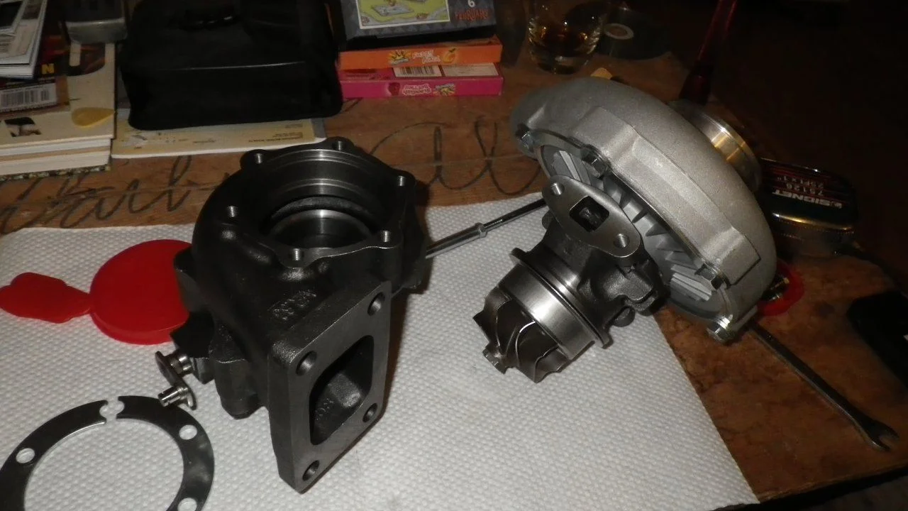

Job one was to clock orientation of main body so oil drain would be on low side of unit when installed in this application.
Drain side pictured directly above. Bolt patterns on compressor and exhaust housings allow changes in orientation, happily.
Upadates as things progress, should be a busy weekend. Stay tuned.
