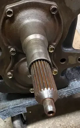

Im thinking of converting my FJ62 Auto to H55F 5 speed. The transmission is out of an BJ70 and will come with a transfer case already mated to it.
My questions are:
Would the input shaft fit a 3FE engine?
Are there any modifications required for the shaft (cutting etc) to get it to fit?
How would you approach the speedo cable to the transmission?
Would you use different driveshafts?
Thank you in advance for the help.

Diesel five speeds have more splines, also it’s longer I think.
Correct me if I'm wrong but isn't the h55f that's mated behind a 2h and 3f the same input shaft and the 3b totally different?

This is as it sits at the moment, gathering both dust and boxes.
Will not work. You need a new input shaft.
That was my fear, it look like the H55F shaft is a 21 spline shaft.
You will be better off sourcing a correct H55F instead of tearing down this one to replace the input shaft. To replace the input shaft will essentially require a complete tear down and rebuild of your current transmission. Went through this experience once and will never repeat it. If funds are available a new transmission is the way to go.

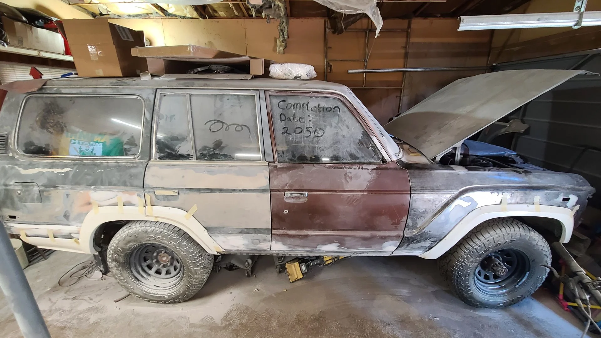

Where did you get the fender flares? Sorry offtopic
Check Gozzard Yachts. look under composites in the drop down. apparently hes a LC fan.
