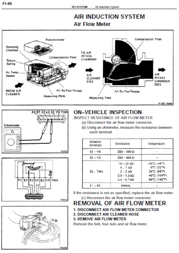

Page FI-66 of the FSM would be a good place to start.
When was the last tune-up and valve adjustment?

The AFM has an air intake temperature sensor. I posted the page of the FSM for you.
