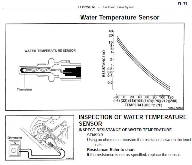

Running through the little things. My oil change smelled of fuel. My cold start injector was pretty nasty too. So once the gaskets are in, I will be cleaning the intake and taking a look at the injectors. I want to also test my coolant temp sender, the one for the ECU. Can anyone tell me the ohm range on that please.
