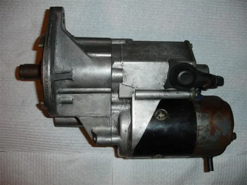

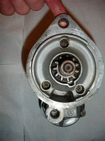

My photo may help you decide on whether the nose cones match.
And here's more photos from other angles which may help you too:
And here's the same model starter on my spare engine:
:cheers:
PS. If you put as many details as you can of your cruiser in your signature line it'll help posters like me. (Those details often help me know which threads to avoid posting in :D ... as well as telling me which ones I may be able to offer helpful advice in.)
PPS. Actually - I guess your nose cone actually doesn't need to match mine .. for you to still pursue the "nose-cone-swap option". But it is still probably best for you to know which particular starter I have my limited knowledge based on.

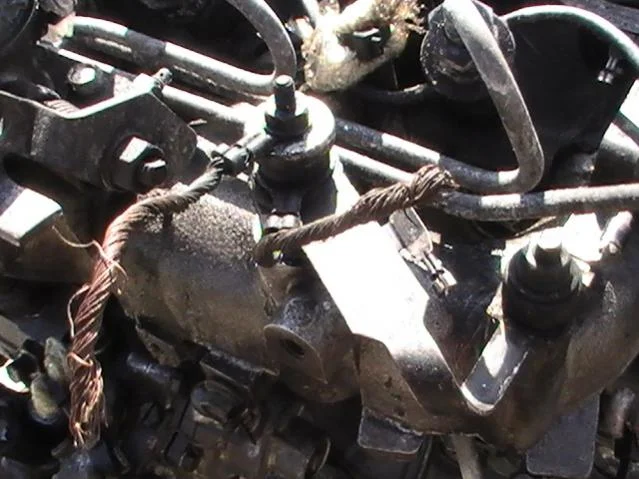

Easiest is to begin by making the engine the same voltage as the body it's going into. It's much easier to change engine voltage than the entire rest of the truck. Running two voltages is going to cause confusion down the road.
As for wiring. My BJ60 is 12v and uses the same glow system as you have pictured. You're welcome to look or ask questions. I'm currently staying in northern Germany. I was through Spain a month or so back when we drove up from Sierra Leone.
On the bottom picture you can ignore that wire. It is simply an indicator for when 4WD is engaged. If you have a 4WD light, that's the switch that turns it on or off.
